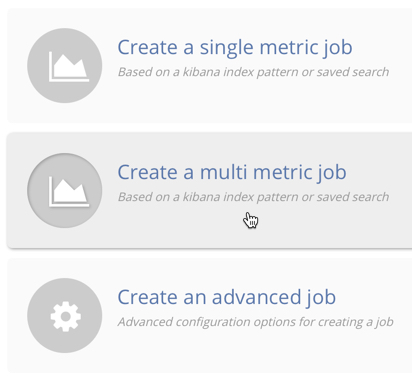

Click Machine Learning in the side navigation, then click Create new job.
Click Create multi metric job.

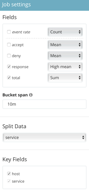

Configure the job by providing the following job settings:
For the Fields, select
high mean(response)andsum(total). This creates two detectors and specifies the analysis function and field that each detector uses. The first detector uses the high mean function to detect unusually high average values for theresponsefield in each bucket. The second detector uses the sum function to detect when the sum of thetotalfield is anomalous in each bucket. For more information about any of the analytical functions, see Function Reference. -
For the Bucket span, enter
10m. This value specifies the size of the interval that the analysis is aggregated into. As was the case in the single metric example, this value has a significant impact on the analysis. When you’re creating jobs for your own data, you might need to experiment with different bucket spans depending on the frequency of the input data, the duration of typical anomalies, and the frequency at which alerting is required. -
For the Split Data, select
service. When you specify this option, the analysis is segmented such that you have completely independent baselines for each distinct value of this field. There are seven unique service keyword values in the sample data. Thus for each of the seven services, you will see the high mean response metrics and sum total metrics.If you are creating a job by using the machine learning APIs or the advanced job wizard in Kibana, you can accomplish this split by using the
partition_field_nameproperty. -
For the Key Fields, select
host. Note that theservicefield is also automatically selected because you used it to split the data. These key fields are also known as influencers. When you identify a field as an influencer, you are indicating that you think it contains information about someone or something that influences or contributes to anomalies.Picking an influencer is strongly recommended for the following reasons:
- It allows you to more easily assign blame for the anomaly
- It simplifies and aggregates the results
The best influencer is the person or thing that you want to blame for the anomaly. In many cases, users or client IP addresses make excellent influencers. Influencers can be any field in your data; they do not need to be fields that are specified in your detectors, though they often are.
As a best practice, do not pick too many influencers. For example, you generally do not need more than three. If you pick many influencers, the results can be overwhelming and there is a small overhead to the analysis.

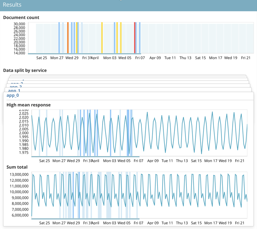

Click Use full server-metrics* data. Two graphs are generated for each
servicevalue, which represent the high meanresponsevalues and sumtotalvalues over time. -
Provide a name for the job, for example
response_requests_by_app. The job name must be unique in your cluster. You can also optionally provide a description of the job. -
Click Create Job. As the job is created, the graphs are updated to give a visual representation of the progress of machine learning as the data is processed. For example:
