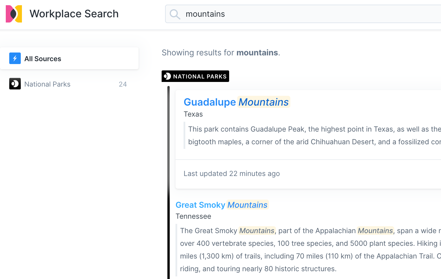

Step 1. First, we need to retrieve the custom API source’s definition. We’ll retrieve it from the API with the following cURL command:
curl \
--request "GET" \
--url "<ENTERPRISE_SEARCH_BASE_URL>/api/ws/v1/sources" \
--header "Authorization: Bearer ${TOKEN}"
Which gives us a response of:
  "meta": { ... },
  "results":
      "id": "60dde90aa1c4934782d5b939",
      "service_type": "custom",
In the above response data, the custom API source we’re looking for has an id of 60dde90aa1c4934782d5b939. You can find name values in the source definitions to help identify which source you’re looking for.
Step 2. Next, we need to identify the name of the field we want to enable as a faceted field. Using this example of a document indexed for these instructions:

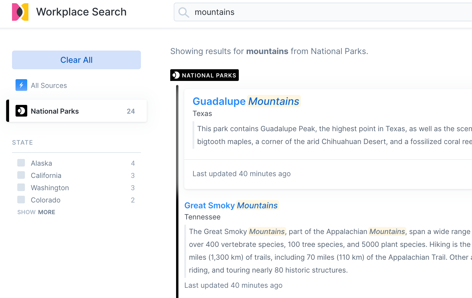

Step 5. Now we can see the search experience includes a filter for State. Note that you generally need to filter on a specific source to expose filters for that source (in this case the National Parks source).

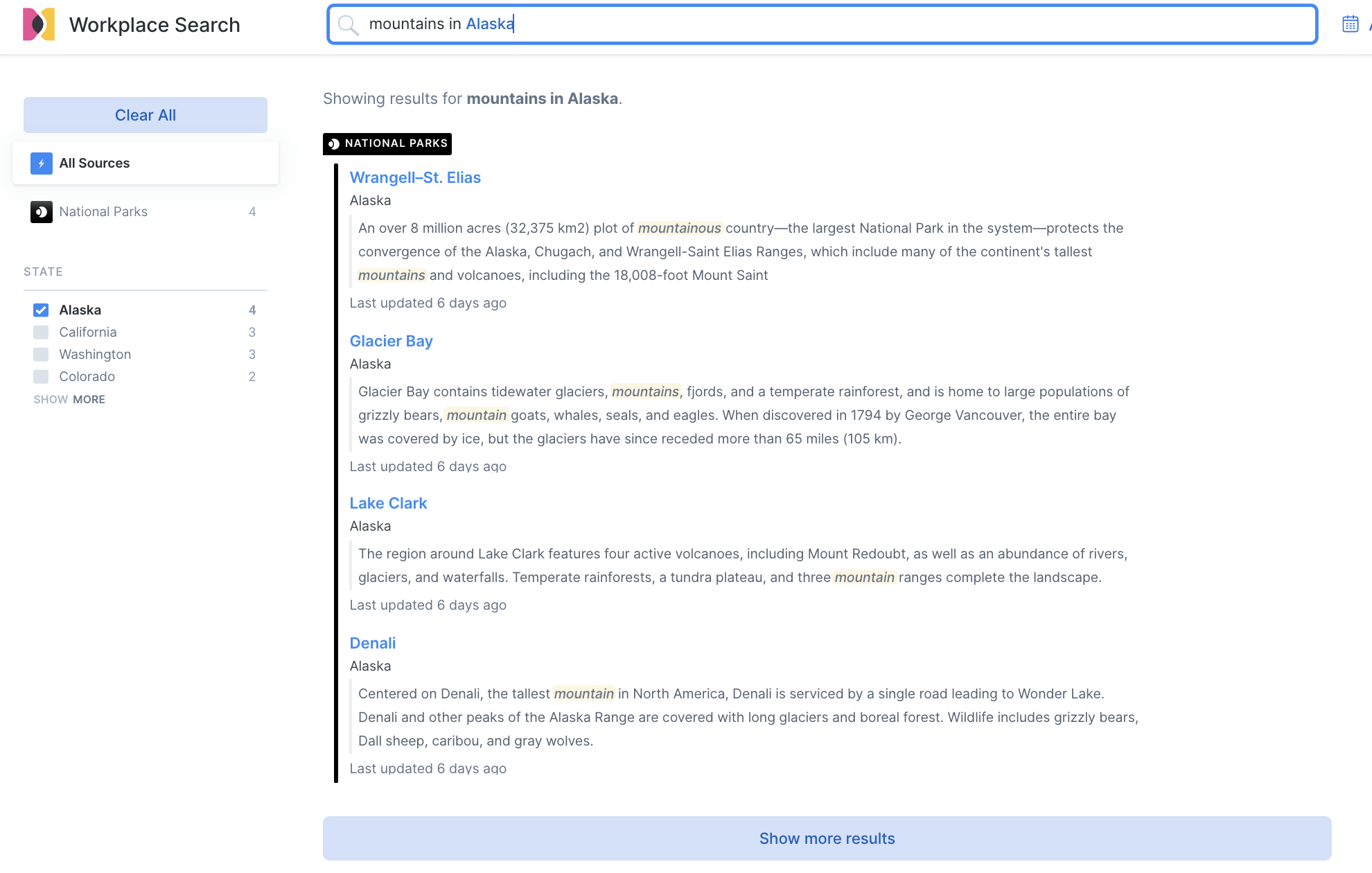

Enabling automatic query refinementedit
Content source automatic query refinements define a sort of domain-specific language that allows a searcher to limit results using natural language queries. When a query contains a configured query_expansion_phrases object followed by a specific value from the matching field, only documents with that value are found.
For example, you may want to enable automatic query refinement for this field, so that the user does not need to manually check the box for State: Alaska when looking for parks only in Alaska.
To do this:
  • Ensure the index contains documents with the states: Alaska (we saw this in the above facets).
  • Configure the field states to have query_expansion_phrases of ['inside', 'in'].
curl \
--request "PUT" \
--url "<ENTERPRISE_SEARCH_BASE_URL>/api/ws/v1/sources/${CONTENT_SOURCE_ID}" \
--header "Authorization: Bearer ${TOKEN}" \
--header "Content-Type: application/json" \
--data '
  "facets":
    "overrides":
        "field": "states",
        "enabled": true,
        "display_name": "State"
  "automatic_query_refinement":
    "overrides":
        "field": "states",
        "enabled": true,
        "is_person": false,
        "query_expansion_phrases":
          "in",
          "inside"
  "created_at": "2021-07-01T16:10:50+00:00",
  "last_updated_at": "2021-07-01T16:10:53+00:00",
  "is_remote": false,
  "details":
  "groups":
        "id": "60b7ab98a1c4935a50c94864",
        "name": "Default"
        "id": "60dde915a1c493e7c239e083",
        "name": "Bootstrapped Users"
  "name": "National Parks",
  "context": "organization",
  "is_searchable": true,
  "schema":
    "description": "text",
    "title": "text",
    "nps_link": "text",
    "states": "text",
    "visitors": "number",
    "square_km": "number",
    "world_heritage_site": "text",
    "date_established": "date",
    "location": "geolocation",
    "acres": "number"
  "display":
    "title_field": "title",
    "subtitle_field": "states",
    "description_field": "description",
    "url_field": "nps_link",
    "type_field": null,
    "media_type_field": null,
    "created_by_field": null,
    "updated_by_field": null,
    "detail_fields":
          "field_name": "states",
          "label": "States"
          "field_name": "description",
          "label": "Description"
          "field_name": "date_established",
          "label": "Established"
          "field_name": "visitors",
          "label": "Number of Visitors"
          "field_name": "location",
          "label": "Location"
          "field_name": "world_heritage_site",
          "label": "World Heritage Site?"
          "field_name": "square_km",
          "label": "Square Kilometers"
          "field_name": "acres",
          "label": "Acres"
    "color": "#000000"
  "document_count": 59,
  "last_indexed_at": "2021-07-01T16:10:53+00:00"
Now when your users issue queries like mountains in Alaska or mountains inside California, the state in their search box will highlight blue, and the corresponding facet will automatically be checked.

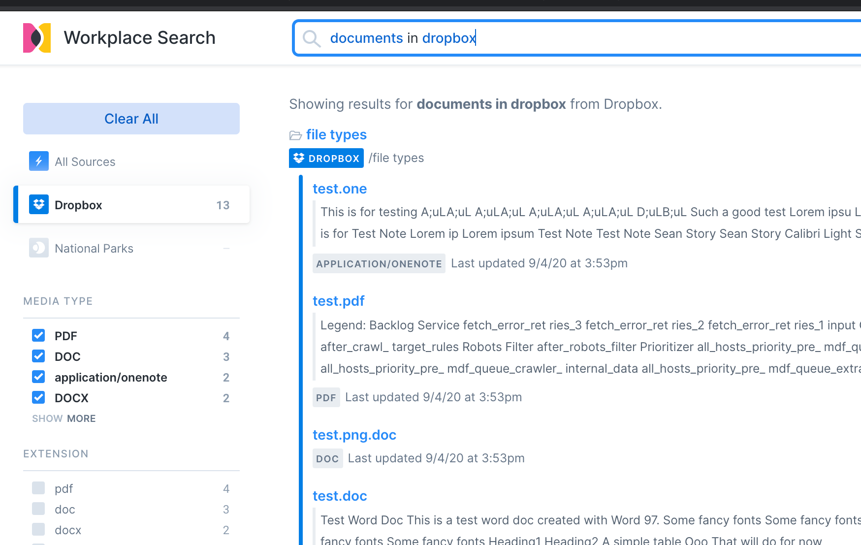

Disable an existing filteredit
Here we’ll hide a filter on a first-party source. These steps assume you have already connected a source. This example will involve a Dropbox source with a number of test documents. Here’s the search experience without any modifications. Note that the search is filtering on Dropbox only to make use of Dropbox filters:
We might decide that the Media Type and Extension filters are redundant, so we’d like to hide the Extension filter.
Step 1. Using the same request as our custom API source example above, we’ll first request all sources to retrieve the source definition of the Dropbox source:
curl \
--request "GET" \
This gives us a response of:
  "meta": { ... },
  "results":
      "id": "60de02d9a1c4934b6efe24db",
      "service_type": "dropbox",
In the above response data, the Dropbox source we’re looking for with a service_type of Dropbox has an id of 60de02d9a1c4934b6efe24db.
