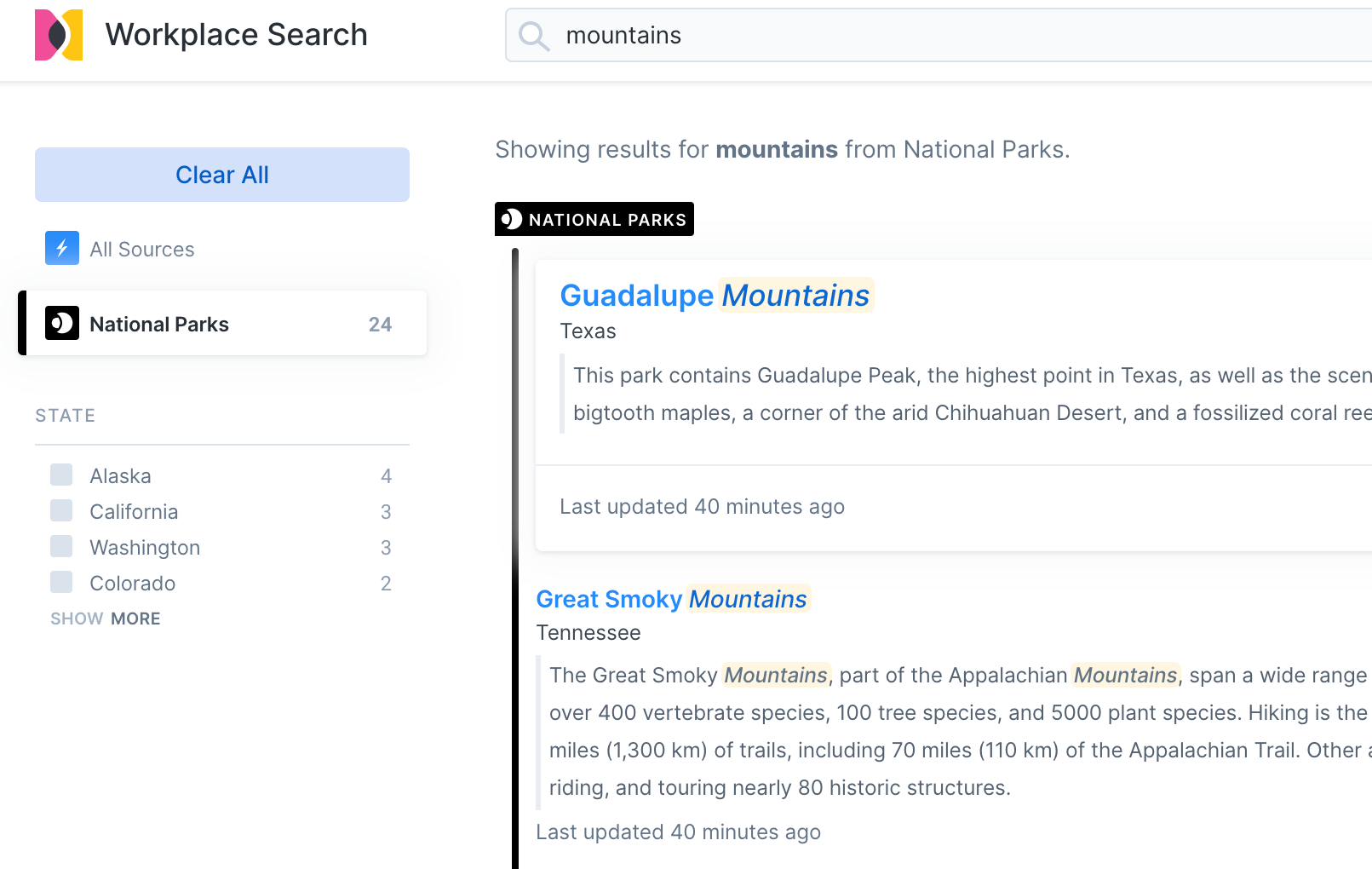

Step 5. Now we can see the search experience includes a filter for State. Note that you generally need to filter on a specific source to expose filters for that source (in this case the National Parks source).
![](images/guides/facets/custom-source-mountains-state-facet.png)
