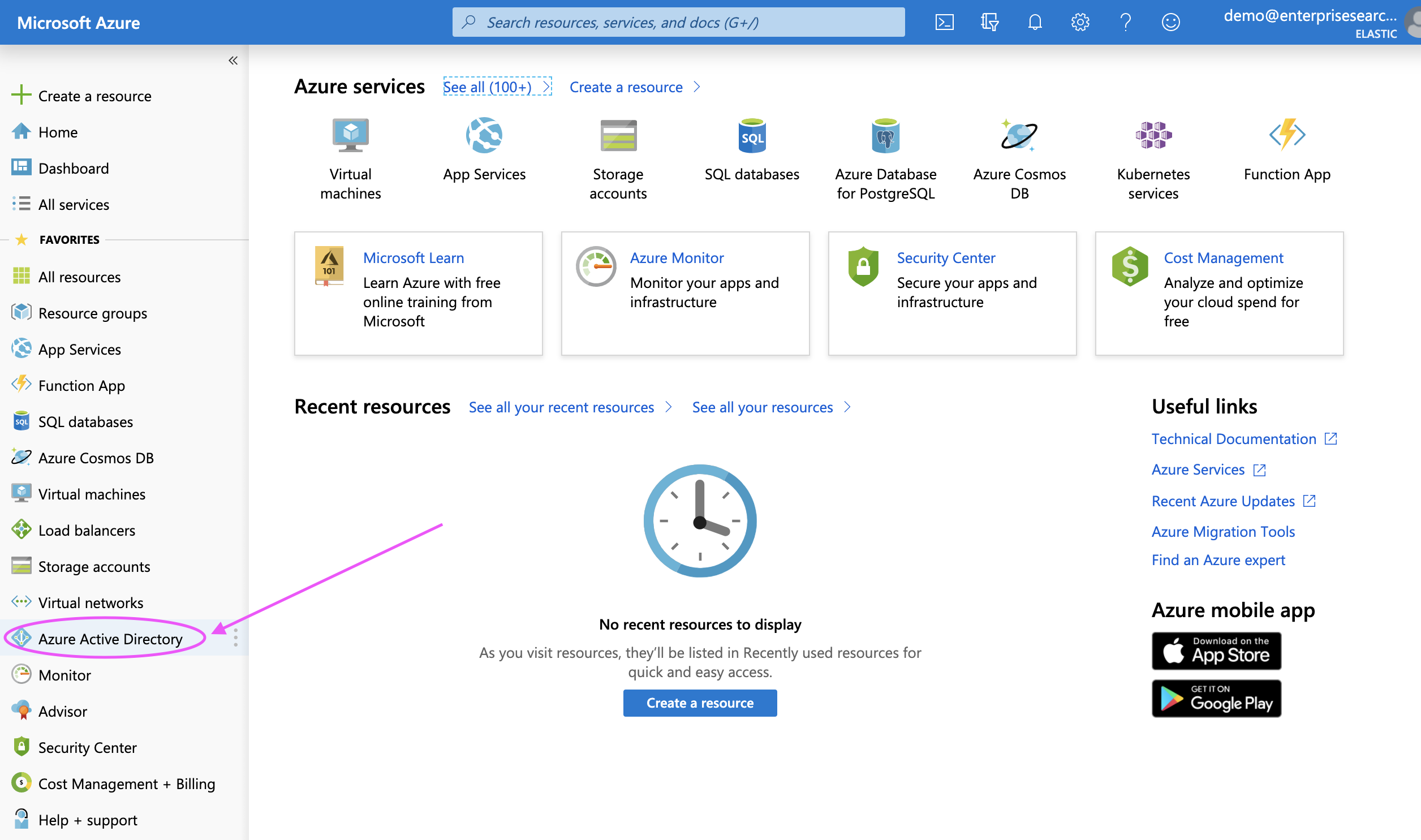

Step 1. Sign in to https://portal.azure.com/ and click on Azure Active Directory:
Figure 82. Connecting SharePoint

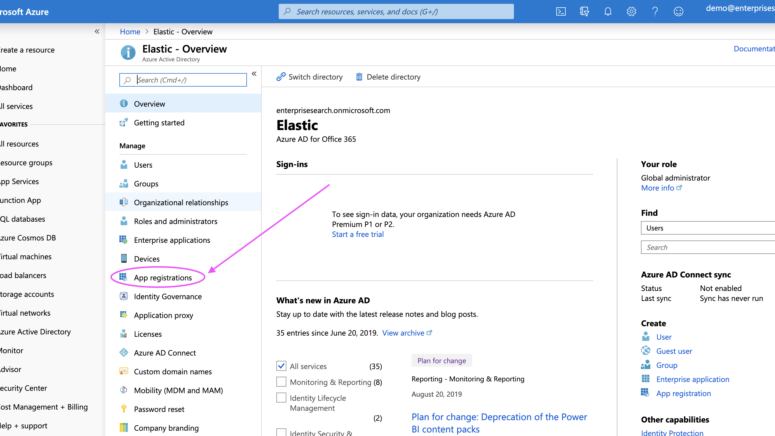

Step 2. Locate App Registrations:
Figure 83. Connecting SharePoint

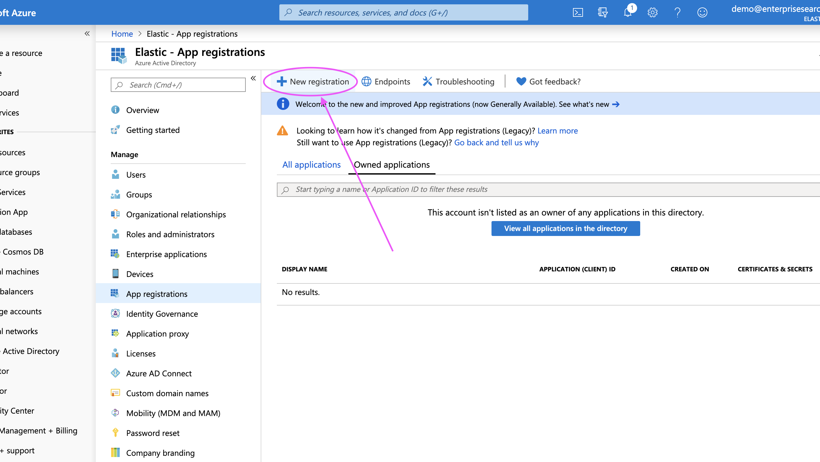

Step 3. Click New Registration:
Figure 84. Connecting SharePoint

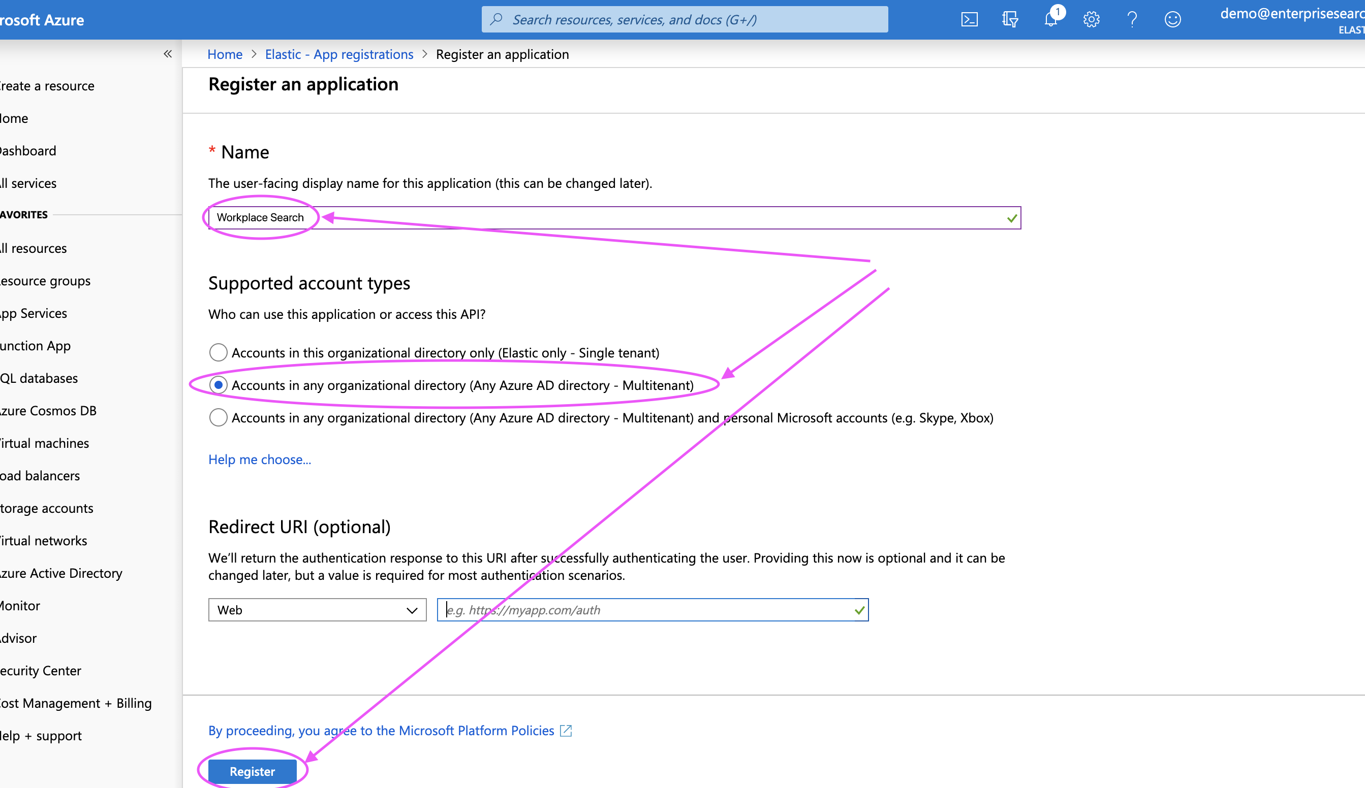

Step 4. Give your app a name - like "Workplace Search" - and make it multitenant.
Setting the app to single tenant will result in a degraded experience, and the connector will not sync content.
Leave the Redirect URIs blank for now. We will need two: one for Organizational Sources and the other for Personal Sources. We’ll add this later in the process.
Step 5. Register the application:
Figure 85. Connecting SharePoint

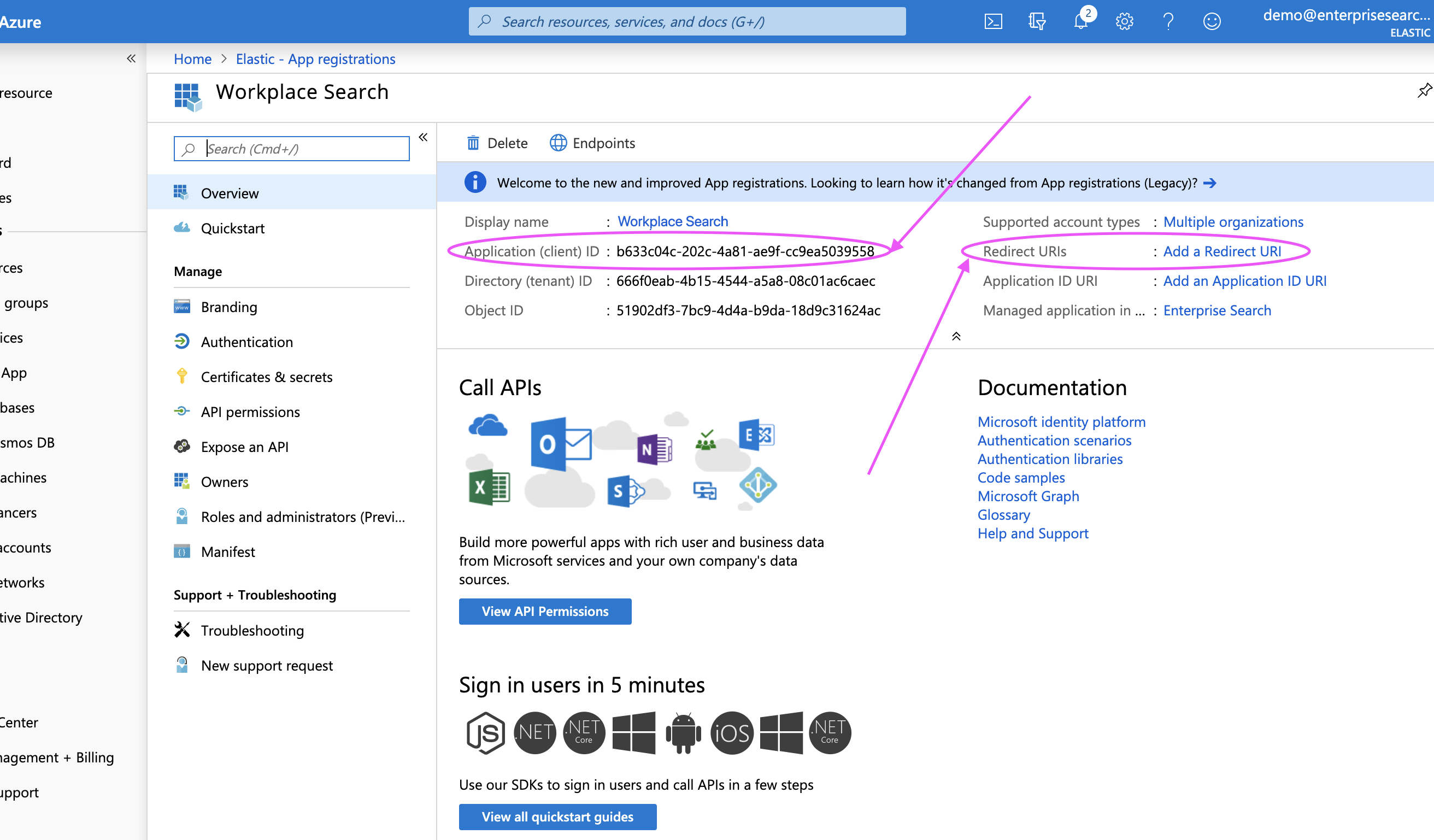

Step 6. Retrieve and keep the Client ID handy - we’ll need it within Workplace Search.

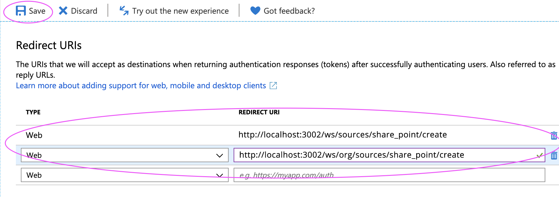

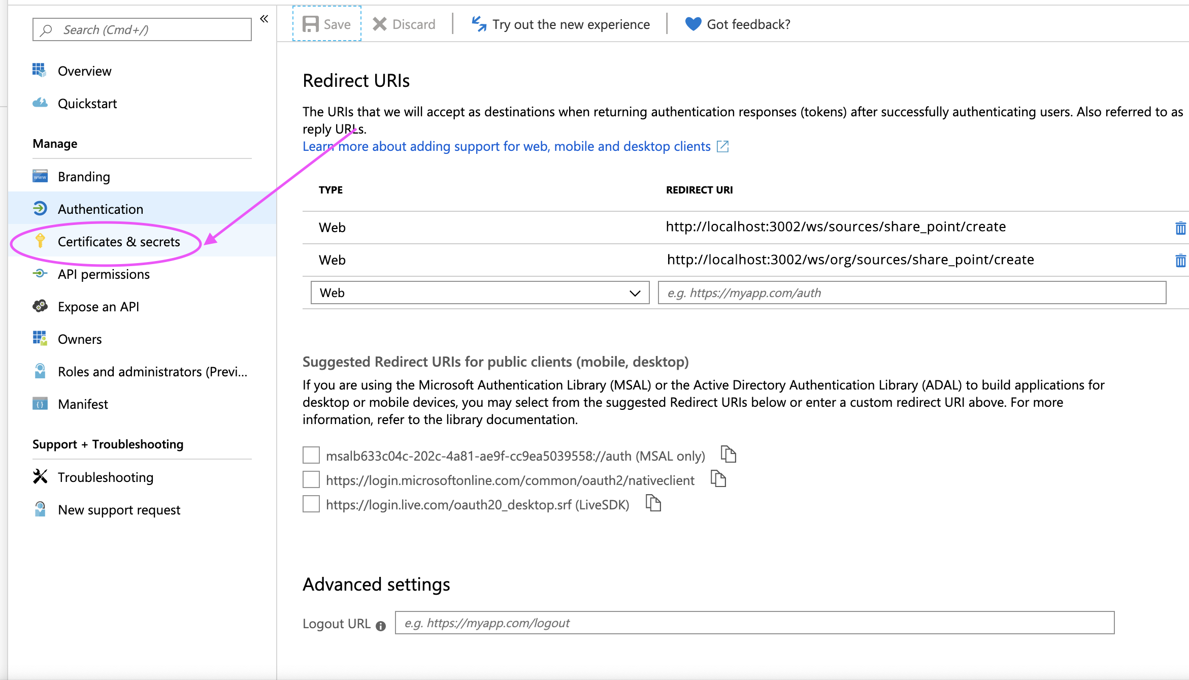

Step 7. Next, click the Add a Redirect URI link in the header.
Figure 86. Connecting SharePoint
The redirect URIs required vary by which user interface you are using to manage Enterprise Search. Enterprise Search in Kibana and standalone Enterprise Search use different redirect URIs. See user interfaces for details on each UI.
When using standalone Enterprise Search, add the following two redirect URIs, substituting <WS_BASE_URL> with the base URL at which Workplace Search is hosted (scheme + host, no path).
<WS_BASE_URL>/ws/org/sources/share_point/create
<WS_BASE_URL>/ws/sources/share_point/create
Examples:
# Deployment using a custom domain name
https://www.example.com/ws/org/sources/share_point/create
https://www.example.com/ws/sources/share_point/create
# Deployment using a default Elastic Cloud domain name
https://c3397e558e404195a982cb68e84fbb42.ent-search.us-east-1.aws.found.io:443/ws/org/sources/share_point/create
https://c3397e558e404195a982cb68e84fbb42.ent-search.us-east-1.aws.found.io:443/ws/sources/share_point/create
# Unsecured local development environment
http://localhost:3002/ws/org/sources/share_point/create
http://localhost:3002/ws/sources/share_point/create

Step 7. Save the cofiguration:
Figure 87. Connecting SharePoint
Step 8. Locate the Client Secret by navigating to Certificates & Secrets:
Figure 88. Connecting SharePoint

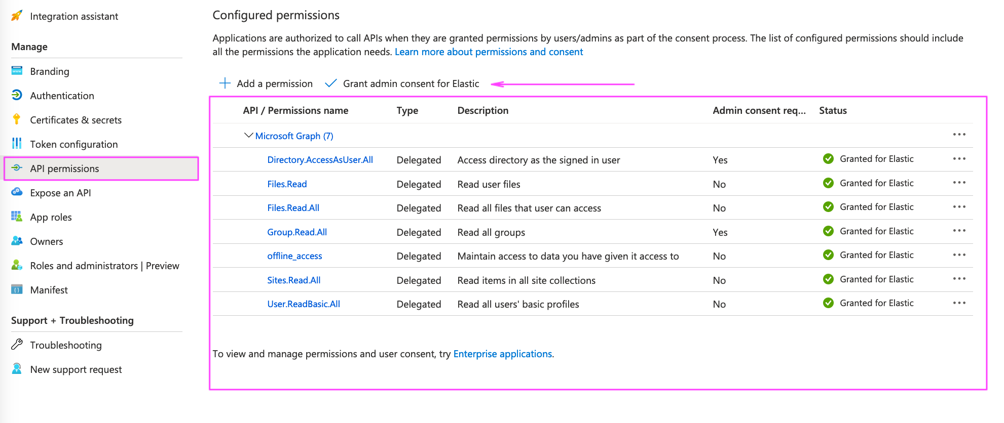

Step 11. We must now set up the permissions the Application will request from the Admin. Navigate to API Permissions and click Add Permission. Add delegated permissions until the list resembles the following:
User.ReadBasic.All
Group.Read.All
Directory.AccessAsUser.All
Files.Read
Files.Read.All
Sites.Read.All
offline_access
Figure 91. Connecting SharePoint
Step 12. Finally, Grant admin consent.
Use the Grant Admin Consent link from the permissions screen.
