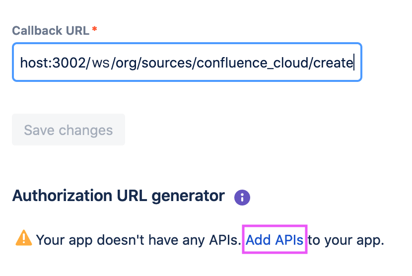

Step 6. Use the Callback URL form to add one of the following callback URLs, substituting <WS_BASE_URL>
with the base URL at which Workplace Search is hosted (scheme + host, no path).
Connect as organizational content source (Most commonly used)
<WS_BASE_URL>/ws/org/sources/confluence_cloud/create

Step 7. A prompt appears. Click the Add APIs hyperlink:
