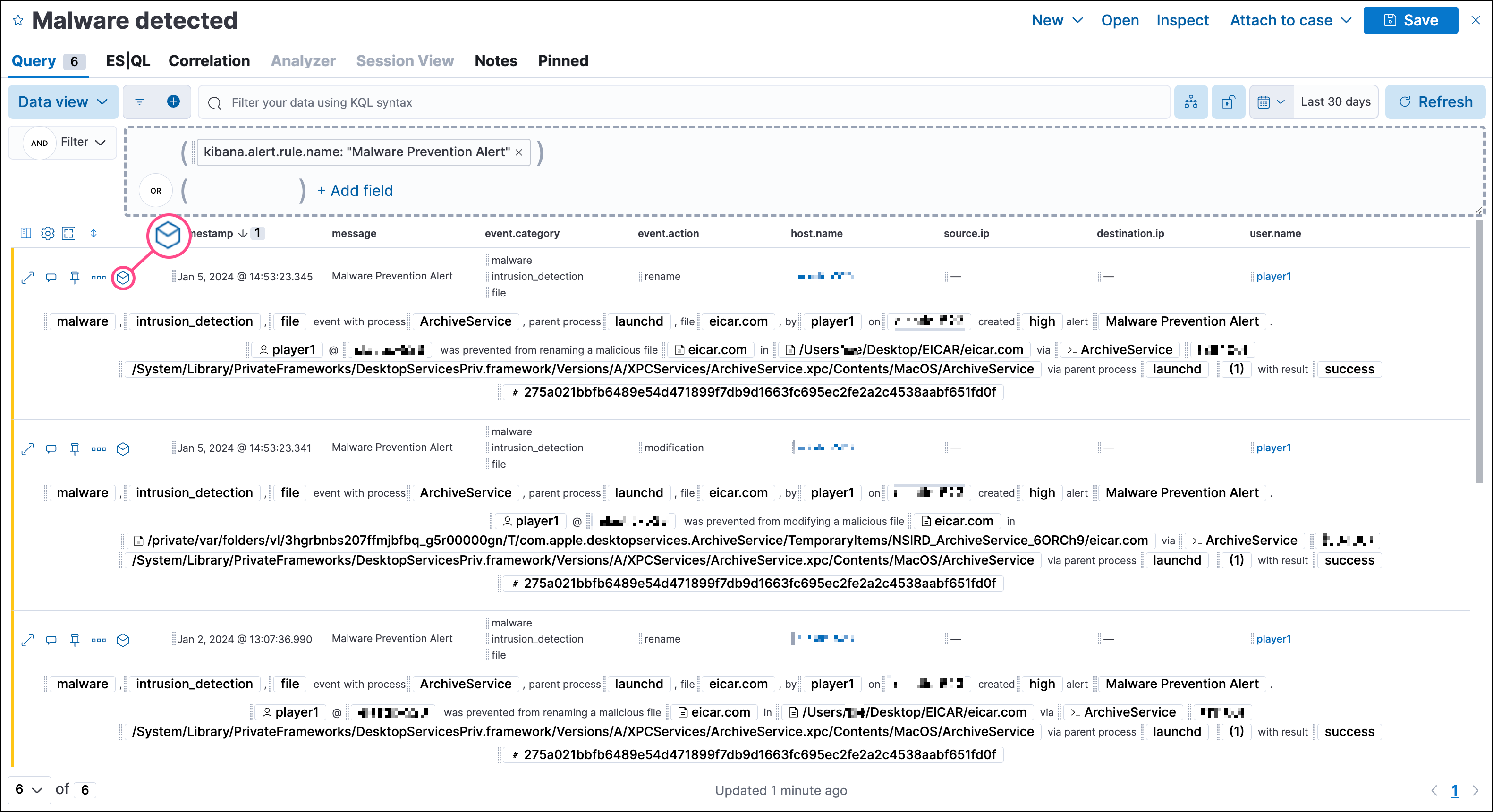

  1. First, display a list of events by doing one of the following:
    • Go to ExploreHosts, then select the Events tab. A list of all your hosts' events appears at the bottom of the page.
    • Go to Alerts, then scroll down to the Alerts table.
  2. Filter events that can be visually analyzed by entering either of the following queries in the KQL search bar, then selecting Enter:
    • agent.type:"endpoint" and process.entity_id :*
      Or
    • agent.type:"winlogbeat" and event.module: "sysmon" and process.entity_id : *

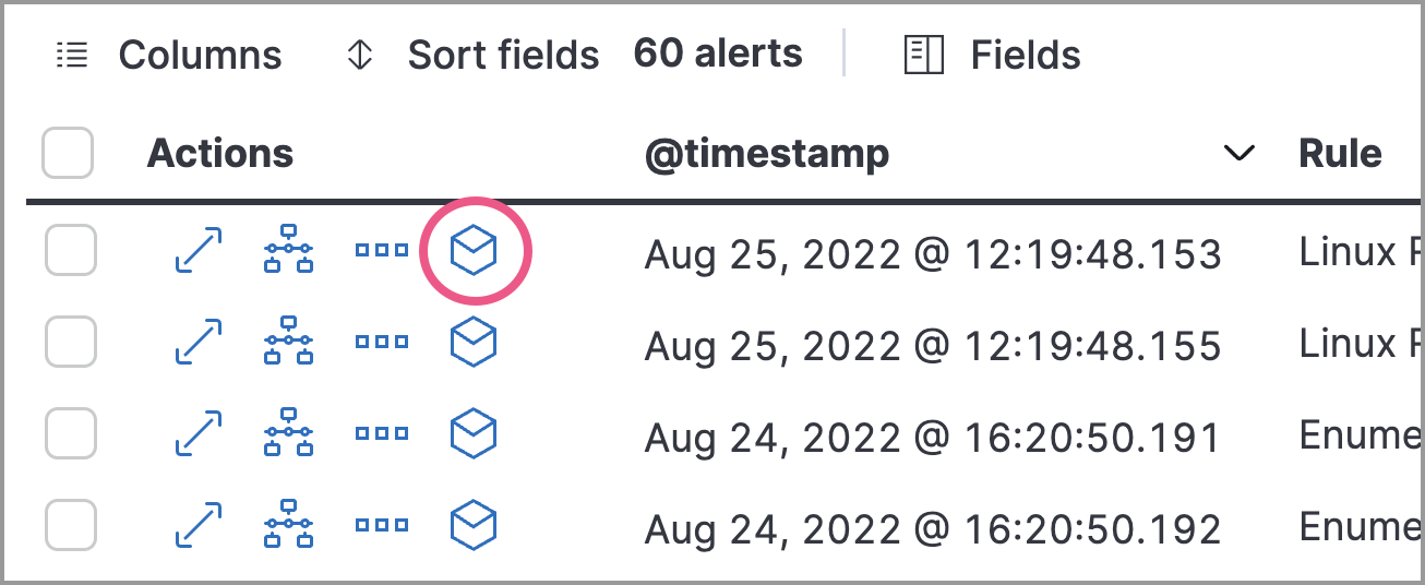

  3. Events that can be visually analyzed are denoted by a cubical Analyze event icon. Select this option to open the event in the visual analyzer. The event analyzer is accessible from the Hosts, Alerts, and Timelines pages, as well as the alert details flyout.

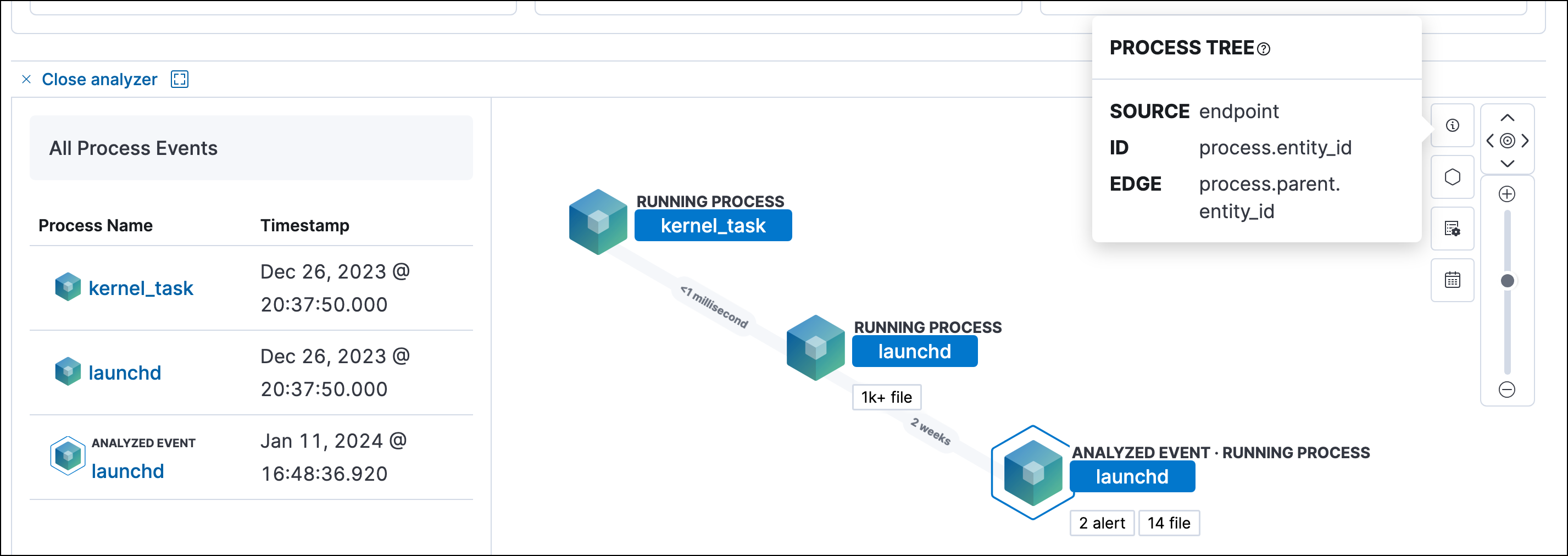

To understand what fields were used to create the process, select the Process Tree to show the schema that created the graphical view. The fields included are:
  • SOURCE: Can be either endpoint or winlogbeat
  • ID: Event field that uniquely identifies a node
  • EDGE: Event field which indicates the relationship between two nodes

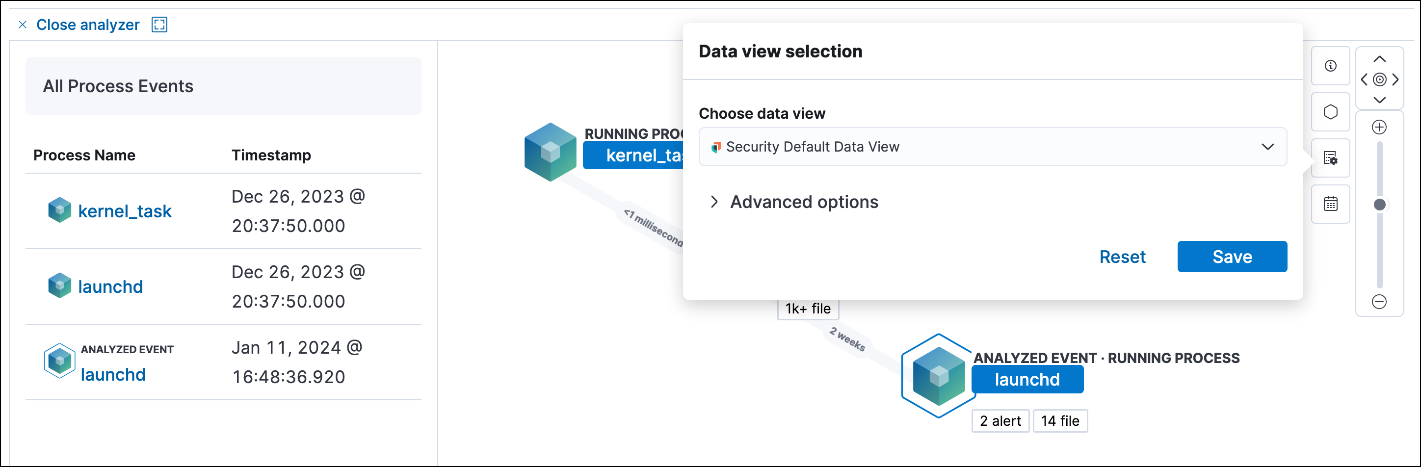

Select a different data view to further filter the alert’s related events.
 detections data view selection

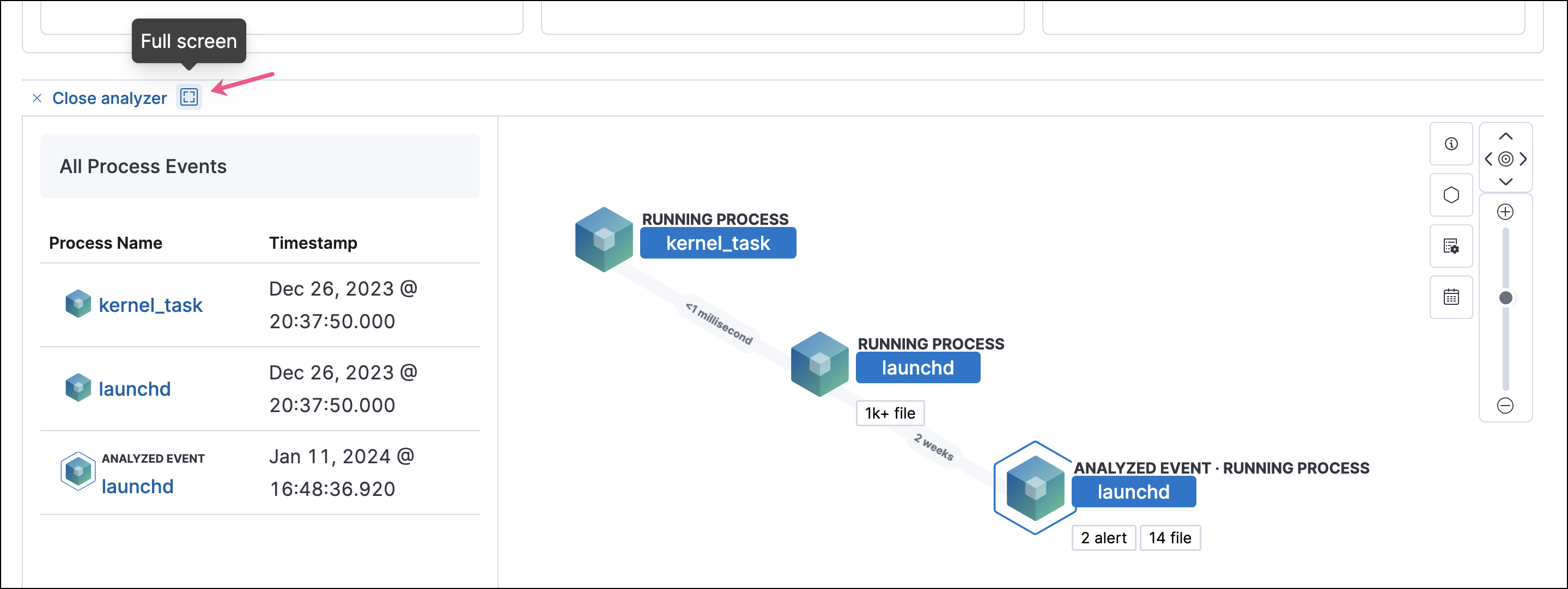

To expand the analyzer to a full screen, select the Full Screen icon above the left panel.
 detections full screen analyzer
The left panel contains a list of all processes related to the event, starting with the event chain’s first process. Analyzed Events — the event you selected to analyze from the events list or Timeline — are highlighted with a light blue outline around the cube.
 detections process list

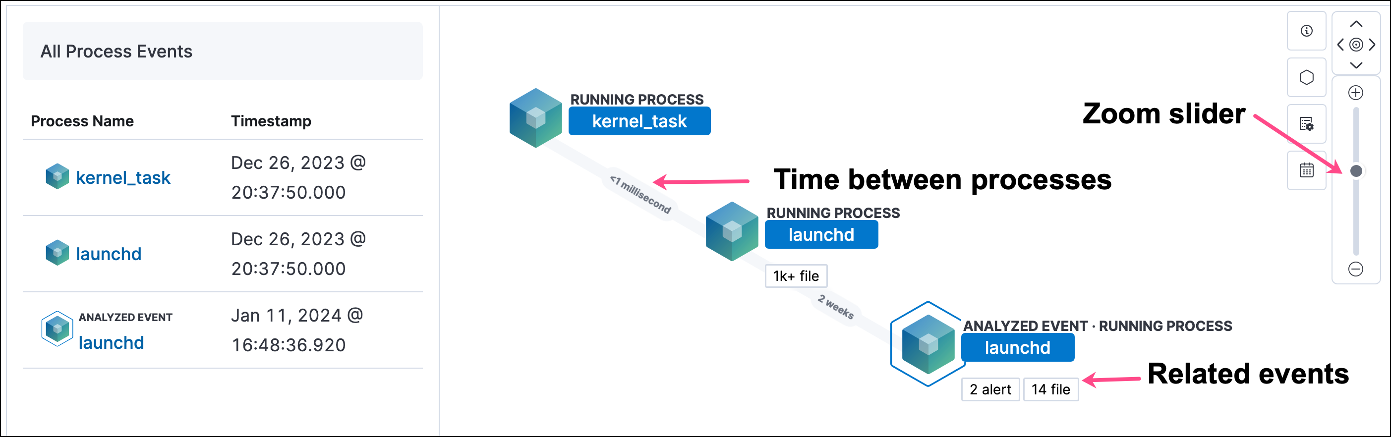

In the graphical view, you can:
  • Zoom in and out of the graphical view using the slider on the far right
  • Click and drag around the graphical view to more process relationships
  • Observe child process events that spawned from the parent process
  • Determine how much time passed between each process
  • Identify all events related to each process
 detections graphical view
