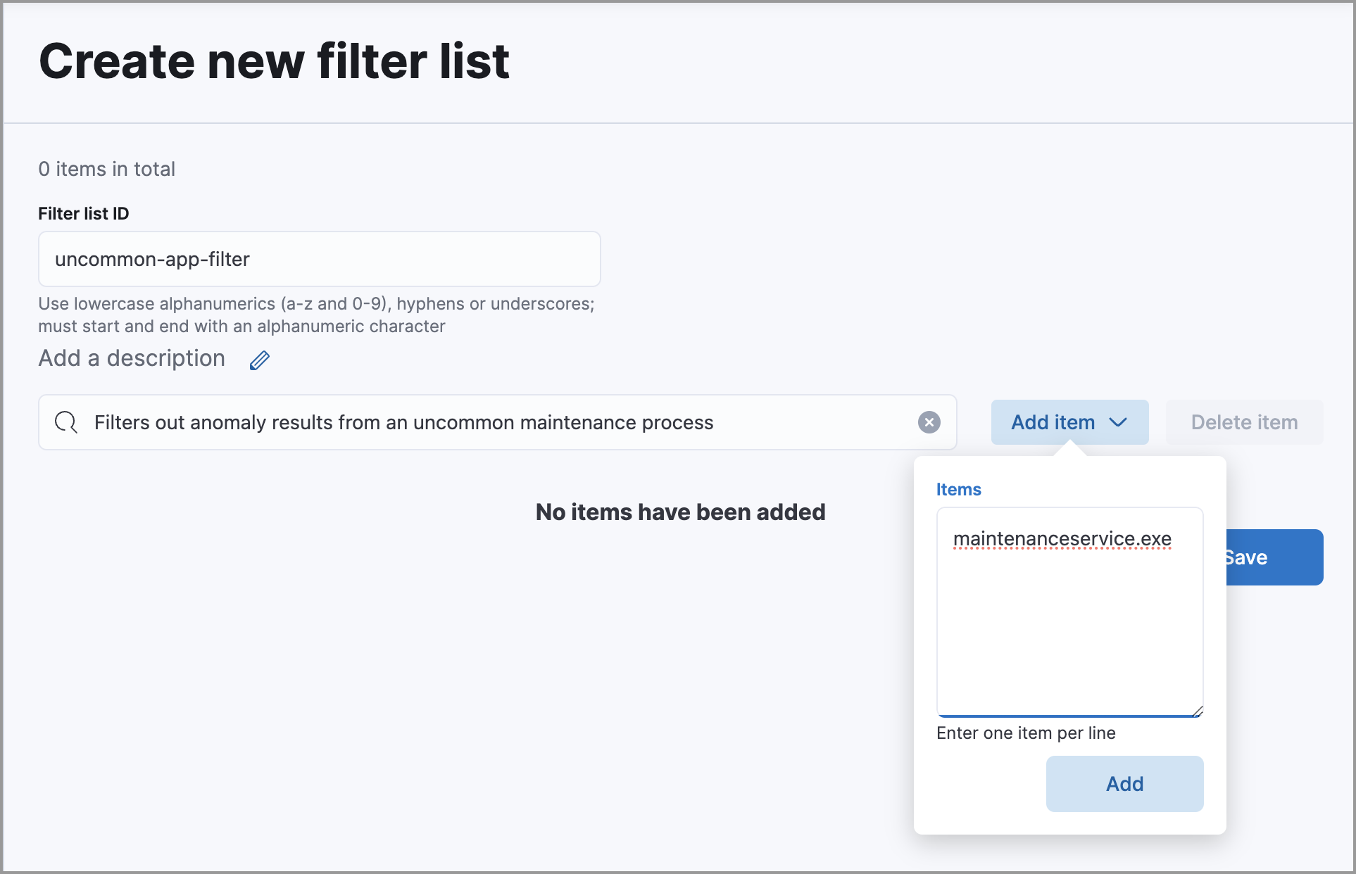

    The Create new filter list pane is displayed.
  3. Enter a filter list ID.
  4. Enter a description for the filter list (optional).
  5. Click Add item.
  6. In the Items textbox, enter the name of the process for which you want to filter out anomaly results (maintenanceservice.exe in our example).
     detections machine learning filter add item
  7. Click Add and then Save.

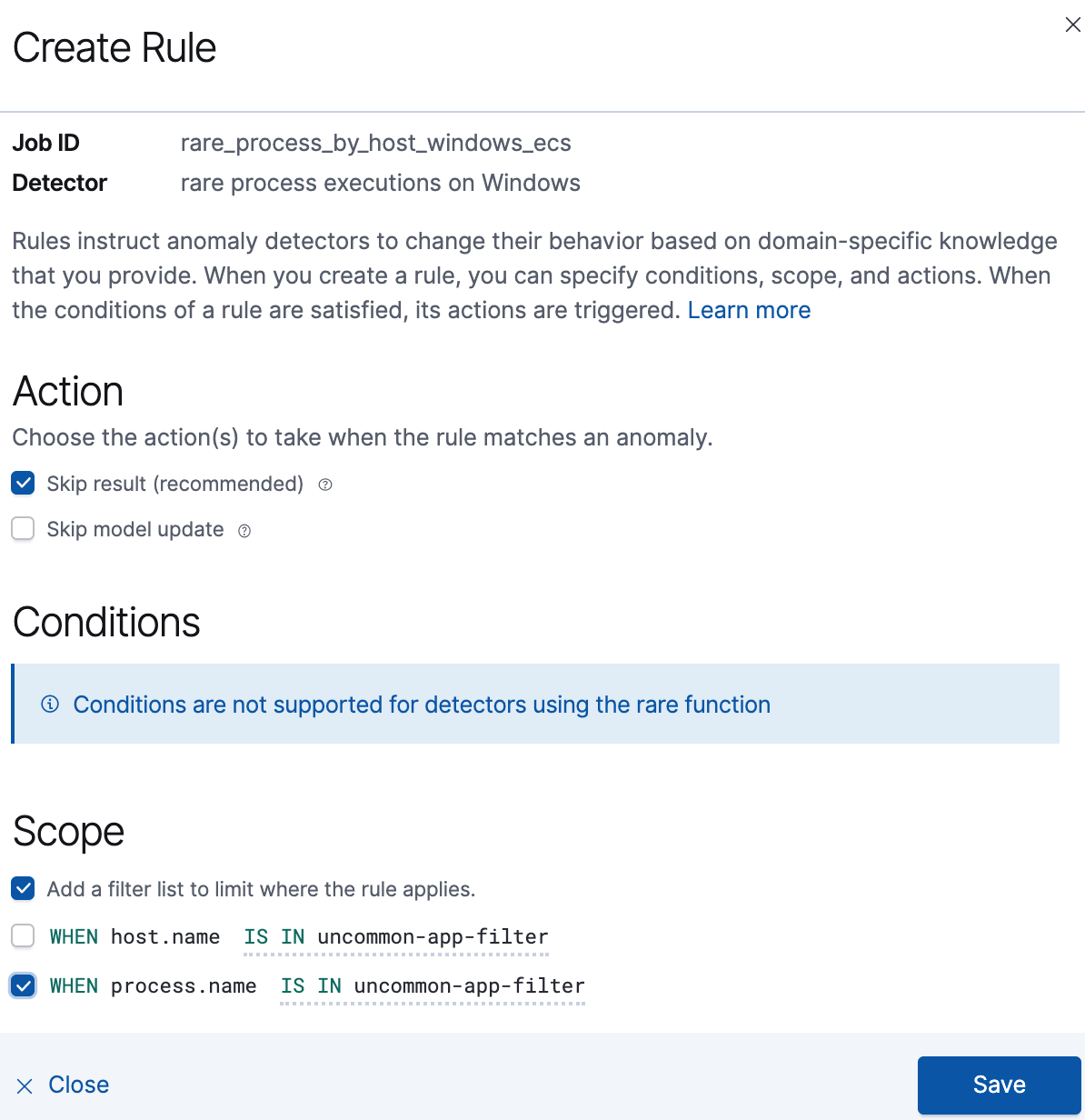

  4. Select:
    1. Add a filter list to limit where the rule applies.
    2. The WHEN statement for the relevant detector (process.name in our example).
    3. The IS IN statement.
    4. The filter you created as part of the Create a filter list procedure.
      For more information, see Customizing detectors with custom rules.
  5. Click Save.

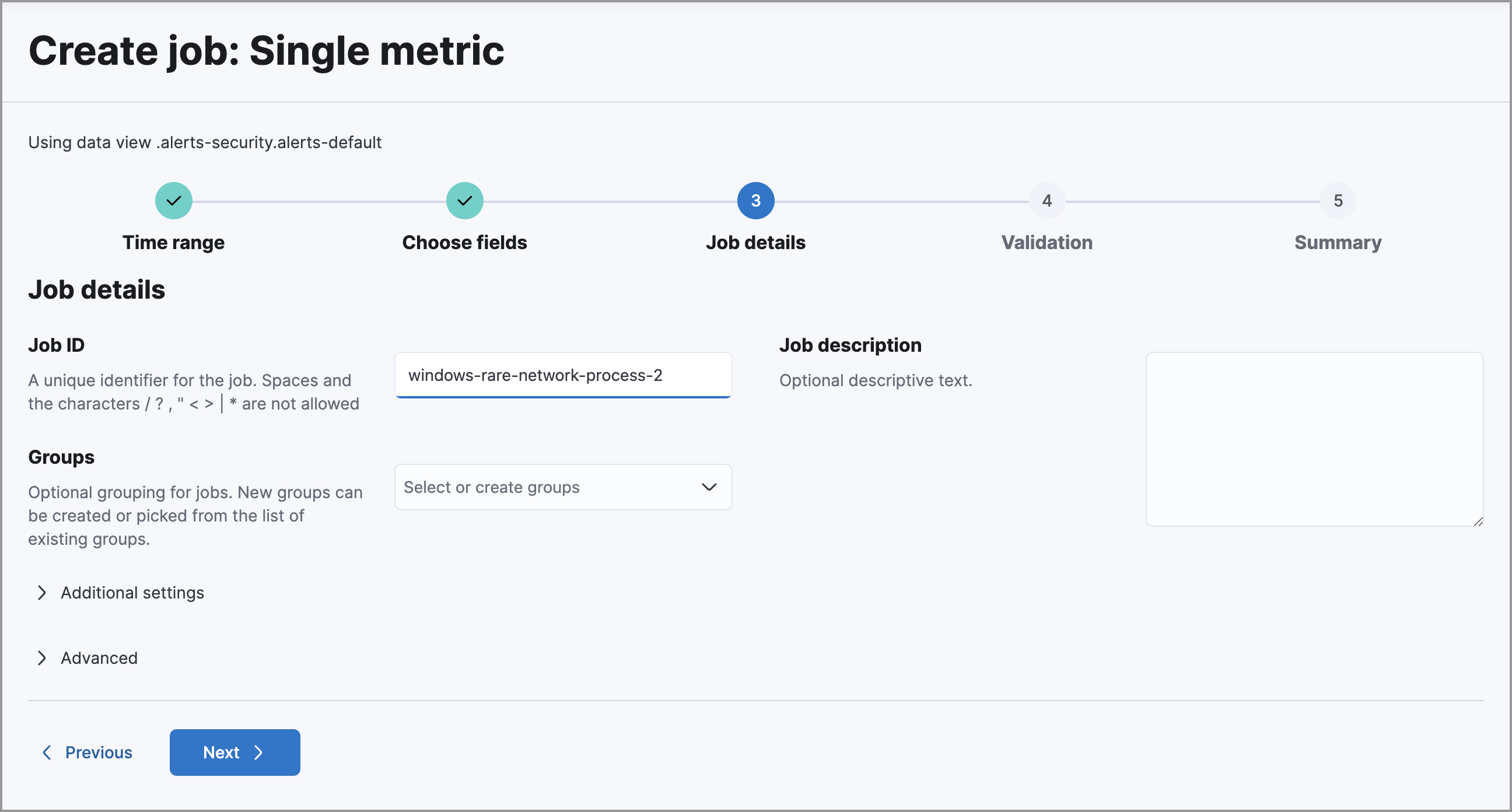

  6. Click Next until the Job details page is displayed.
  7. Enter a Job ID for the cloned job that indicates it is an iteration of the original one. For example, append a number or a username to the original job name, such as windows-rare-network-process-2.

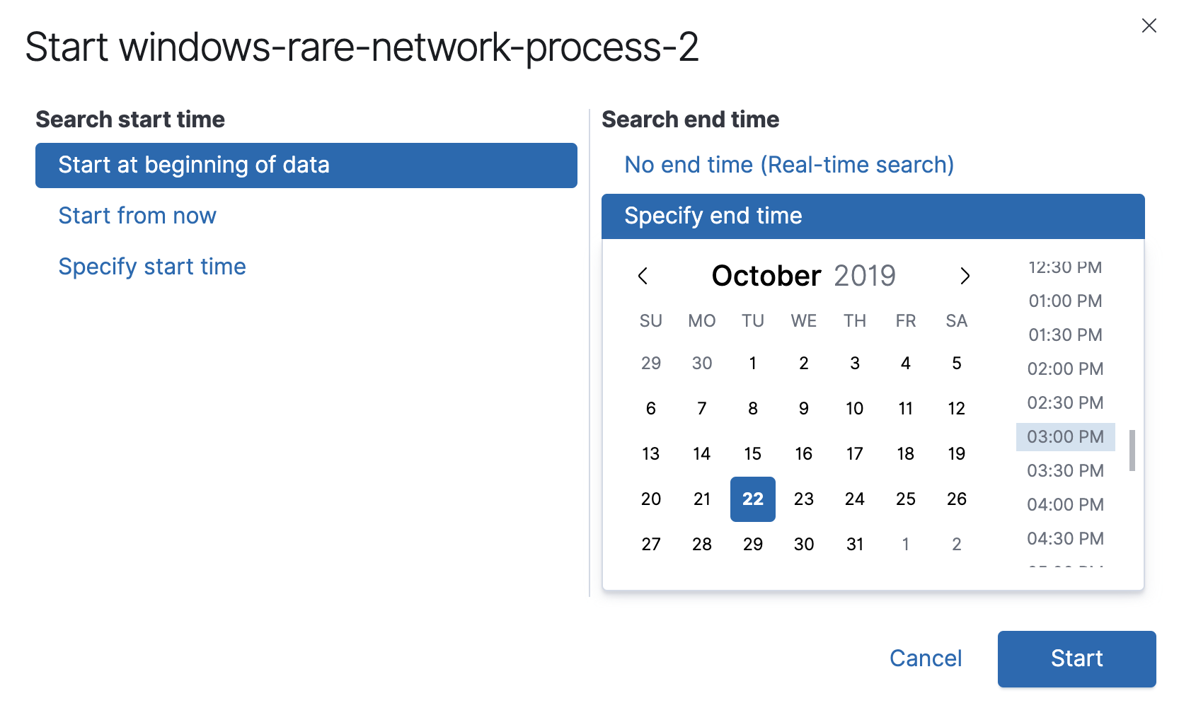

  10. Select the point of time from which the job will analyze anomalies.
  11. Click Start.

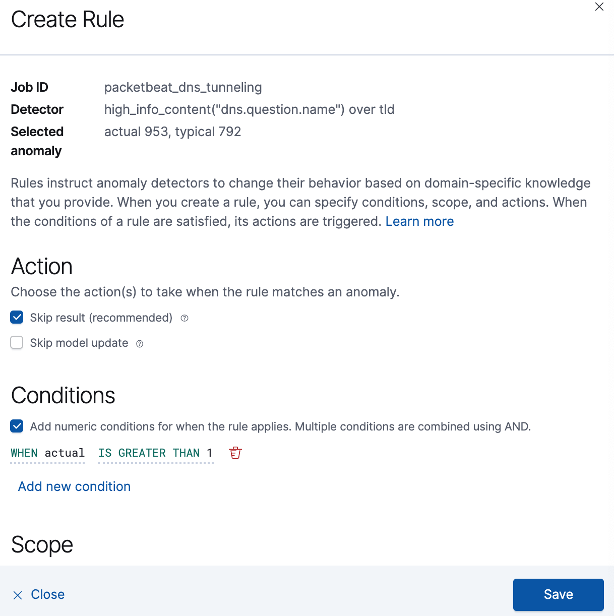

     detections machine learning ml rule threshold
  4. Select Add numeric conditions for when the rule applies and the following when statement:
    WHEN actual IS GREATER THAN <X>
    Where <X> is the threshold above which anomalies are detected.
  5. Click Save.
