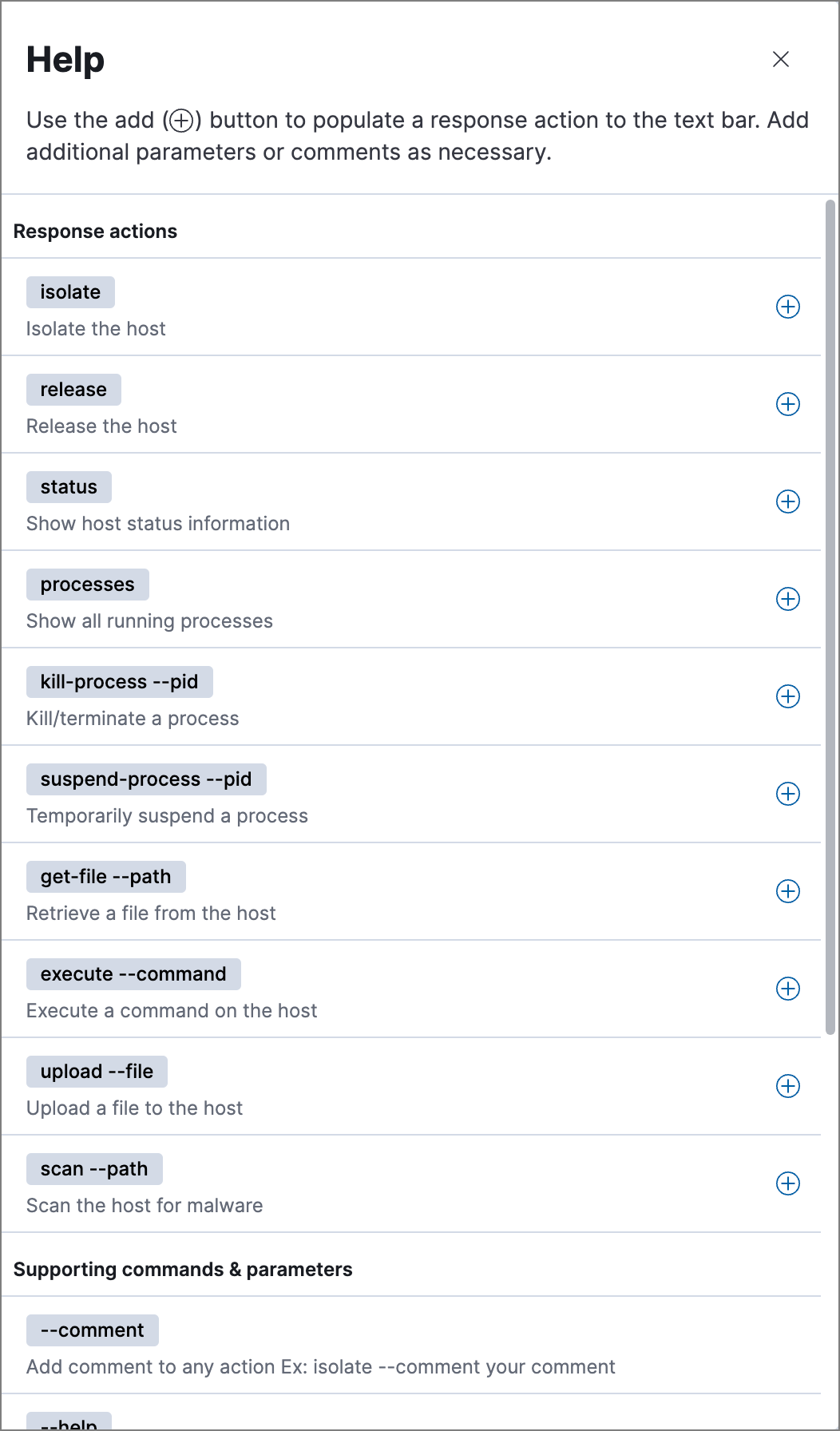

Help panel
Click Help Help in the upper-right to open the Help panel, which lists available response action commands and parameters as a reference.
This panel displays only the response actions that you have the user role privileges to perform.
Help panel
You can use this panel to build commands with less typing. Click the add icon (Add) to add a command to the input area, enter any additional parameters or a comment, then press Return to run the command.

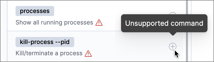

If the endpoint is running an older version of Elastic Agent, some response actions may not be supported, as indicated by an informational icon and tooltip. Upgrade Elastic Agent on the endpoint to be able to use the latest response actions.
Unsupported response action with tooltip

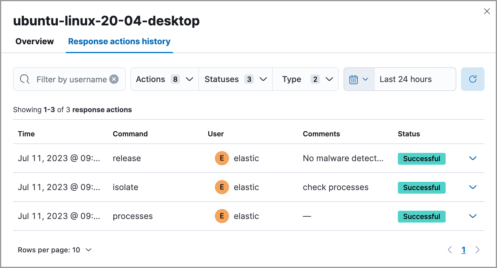

Response actions history
Click Response actions history to display a log of the response actions performed on the endpoint, such as isolating a host or terminating a process. You can filter the information displayed in this view. Refer to Response actions history for more details.
Response actions history with a few past actions
