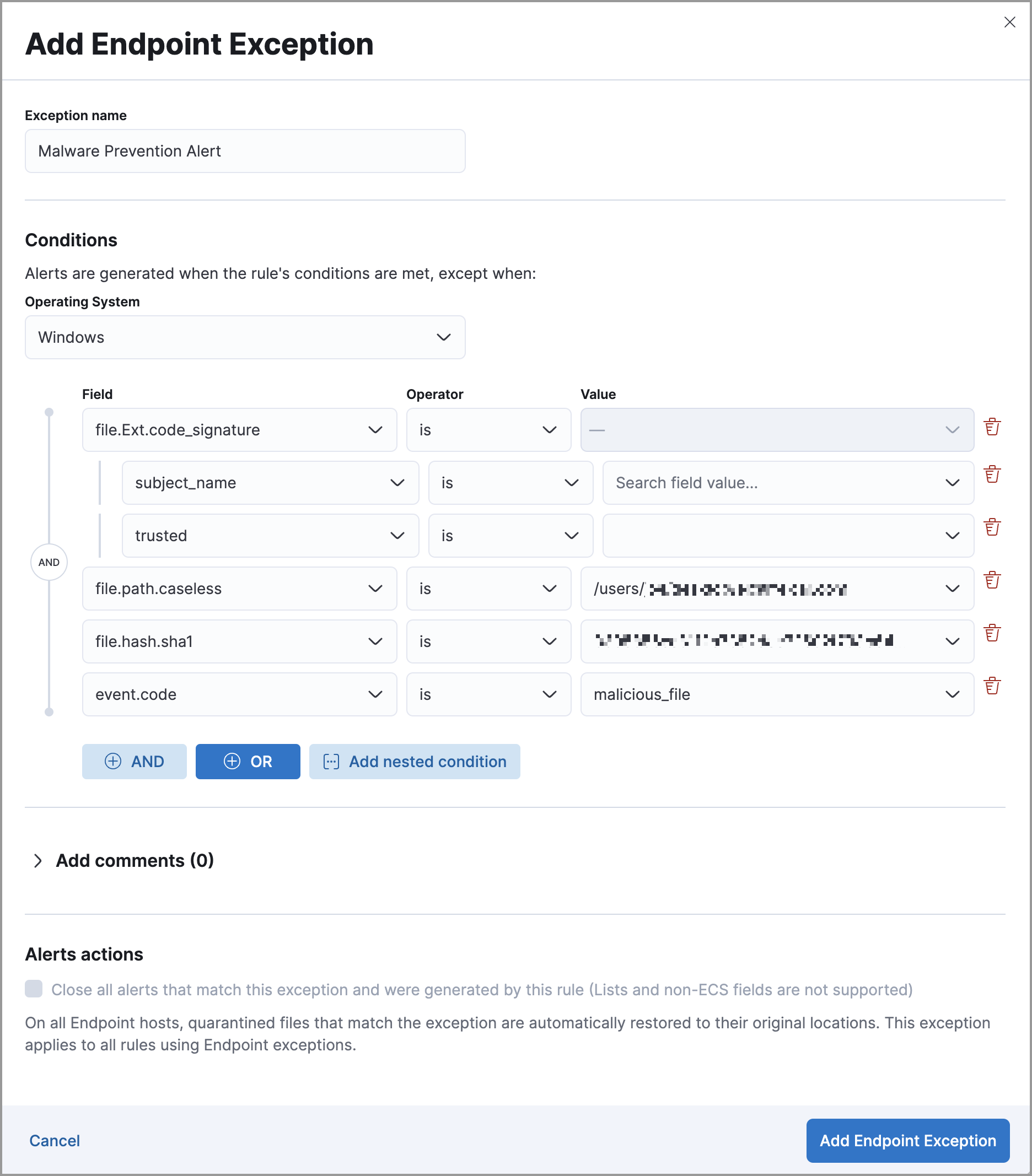

Add Elastic Endpoint exceptions
You can add Elastic Endpoint exceptions to endpoint protection rules or to rules that are associated with Elastic Endpoint rule exceptions. To associate rules when creating or editing a rule, select the Elastic Endpoint exceptions option.
Endpoint exceptions are added to the endpoint protection rules and the Elastic Endpoint on your hosts.
Exceptions added to the endpoint protection rules affect all alerts sent from Elastic Endpoint. Be careful not to unintentionally prevent useful Endpoint alerts.
Additionally, to add an Endpoint exception to an endpoint protection rule, there must be at least one Elastic Endpoint alert generated in the system. For non-production use, if no alerts exist, you can trigger a test alert using malware emulation techniques or tools such as the Anti Malware Testfile from the European Institute for Computer Anti-Virus Research (EICAR).
Binary fields are not supported in detection rule exceptions.
  1. Do one of the following:
    • To add an Endpoint exception from the rule details page:
      1. Go to the rule details page (RulesDetection rules (SIEM)), and then search for and select one of the endpoint protection rules.
      2. Scroll down the rule details page, select the Endpoint exceptions tab, then click Add endpoint exception.
    • To add an Endpoint exception from the Alerts table:
      1. Go to Alerts.
      2. Scroll down to the Alerts table, and from an Elastic Endpoint alert, click the More actions menu (Actions menu), then select Add Endpoint exception.
    • To add an Endpoint exception from Shared Exception Lists page:
      1. Go to RulesShared exception lists.
      2. Expand the Endpoint Security Exception List or click the list name to open the list’s details page. Next, click Add endpoint exception.
        The Endpoint Security Exception List is automatically created. By default, it’s associated with endpoint protection rules and any rules with the Elastic Endpoint exceptions option selected.
        The Add Endpoint Exception flyout opens.
         detections endpoint add exp
  2. If required, modify the conditions. Refer to Exceptions with nested conditions for more information on when nested conditions are required.
    Rule exceptions are case-sensitive, which means that any character that’s entered as an uppercase or lowercase letter will be treated as such. In the event you don’t want a field evaluated as case-sensitive, some ECS fields have a .caseless version that you can use.
    • Fields with conflicts are marked with a warning icon (Warning). Using these fields might cause unexpected exceptions behavior. For more information, refer to Troubleshooting type conflicts and unmapped fields.
    • Identical, case-sensitive values are supported for the is one of and is not one of operators. For example, if you want to match the values Windows and windows, add both values to the Value field.
  3. (Optional) Add a comment to the exception.
  4. You can select any of the following:
    • Close this alert: Closes the alert when the exception is added. This option is only available when adding exceptions from the Alerts table.
    • Close all alerts that match this exception and were generated by this rule: Closes all alerts that match the exception’s conditions.
  5. Click Add Endpoint Exception. An exception is created for both the detection rule and the Elastic Endpoint.
    It might take longer for exceptions to be applied to hosts within larger deployments.

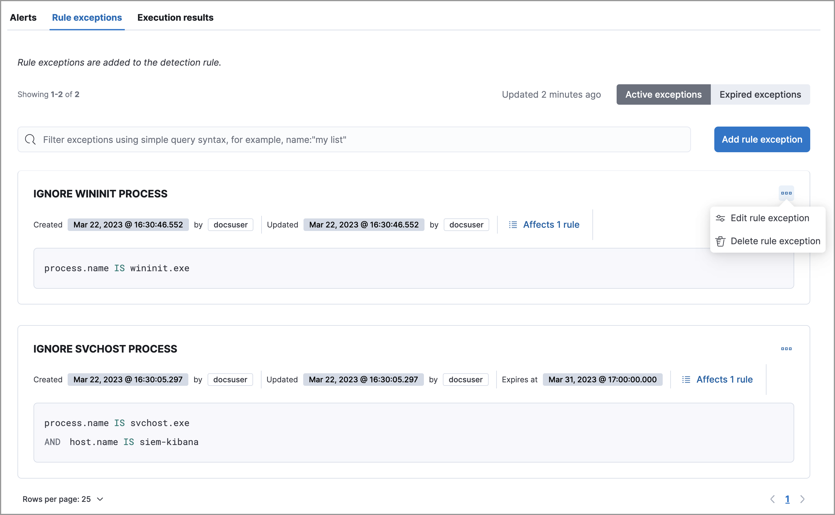

View and manage exceptions
To view a rule’s exceptions, open the rule’s details page (RulesDetection rules (SIEM)Rule name), then scroll down and select the Rule exceptions or Endpoint exceptions tab. All exceptions that belong to the rule will display in a list. From the list, you can filter, edit, and delete exceptions. You can also toggle between Active exceptions and Expired exceptions.
A default rule list

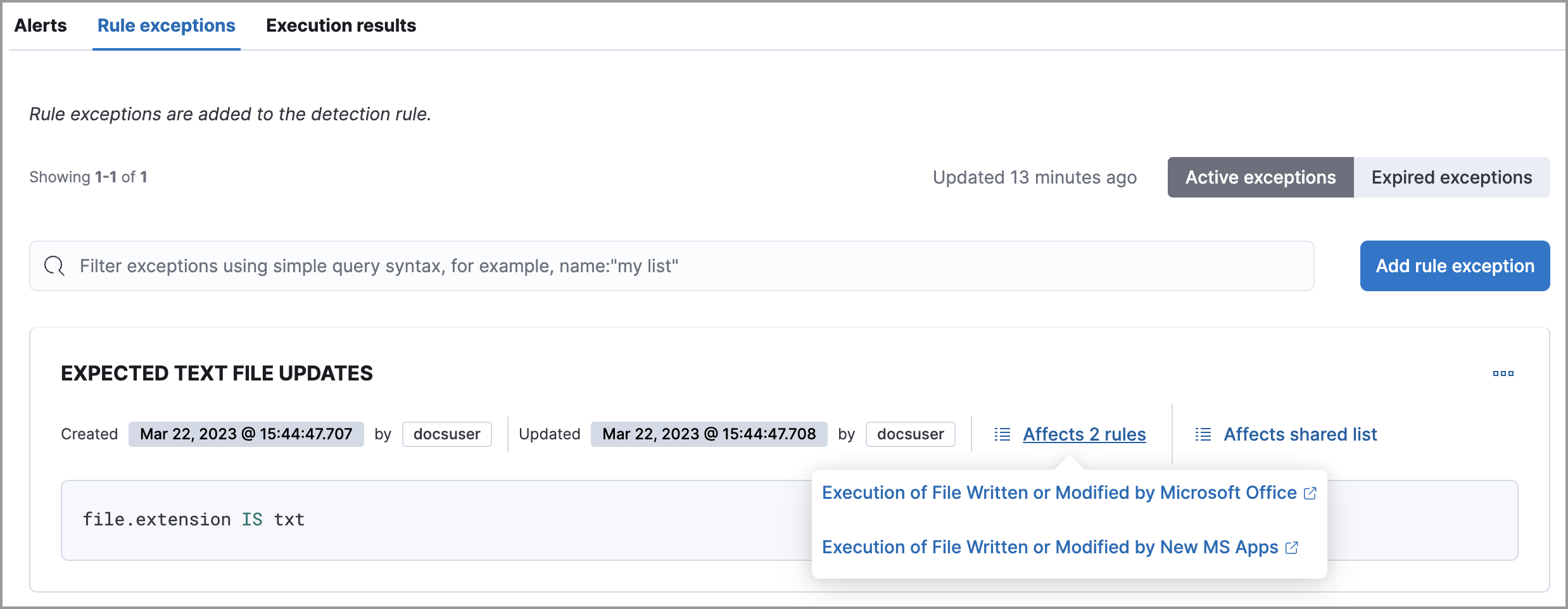

Find rules using the same exceptions
To find out if an exception is used by other rules, select the Rule exceptions or Endpoint exceptions tab, navigate to an exception list item, then click Affects X rules.
Changes that you make to the exception also apply to other rules that use the exception.
Exception that affects multiple rules
