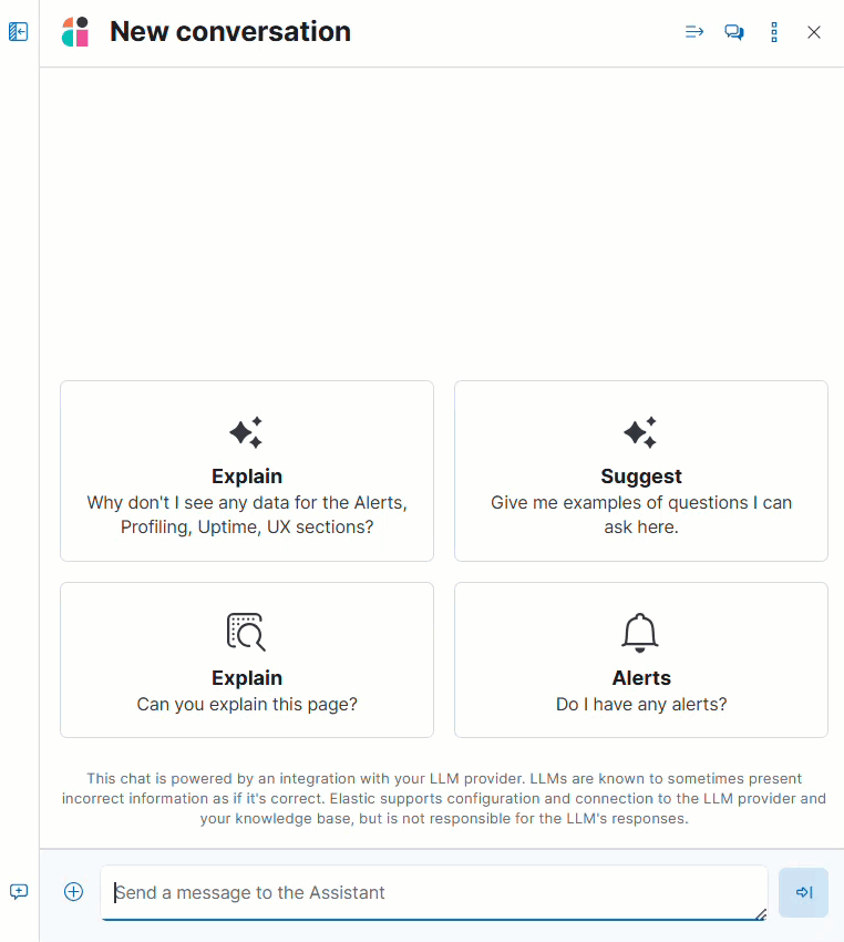

Chat with the assistant
Click the AI Assistant button (AI Assistant icon) in the upper-right corner where available to start the chat.
This opens the AI Assistant flyout, where you can ask the assistant questions about your instance:
Observability AI assistant chat

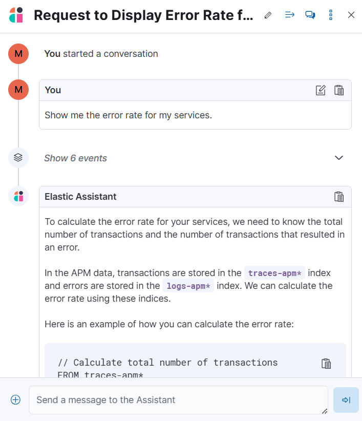

Asking questions about your data requires function calling, which enables LLMs to reliably interact with third-party generative AI providers to perform searches or run advanced functions using customer data.
When the Observability AI Assistant performs searches in the cluster, the queries are run with the same level of permissions as the user.

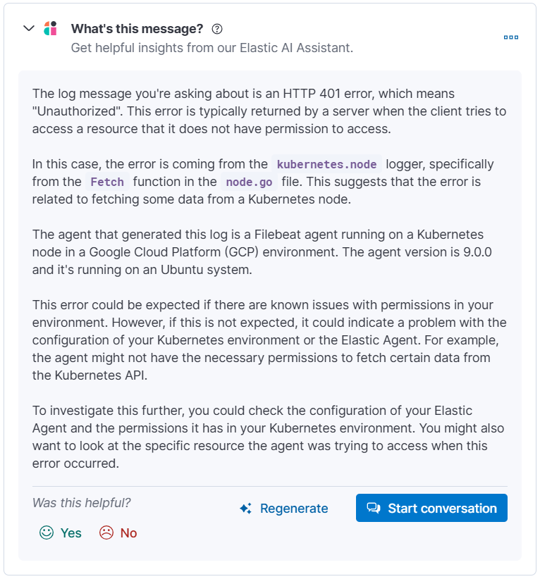

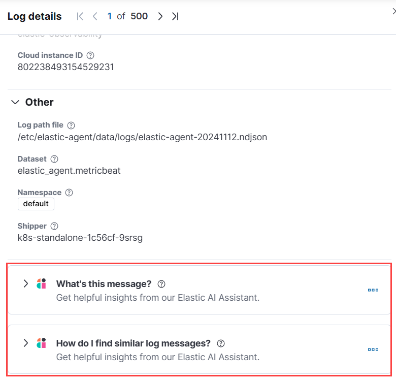

Use contextual prompts
AI Assistant contextual prompts throughout Elastic Observability Serverless provide the following information:
  • Alerts: Provides possible causes and remediation suggestions for log rate changes.
  • Application performance monitoring (APM): Explains APM errors and provides remediation suggestions.
  • Logs: Explains log messages and generates search patterns to find similar issues.
For example, in the log details, you’ll see prompts for What’s this message? and How do I find similar log messages?:
Observability AI assistant example prompts for logs
Clicking a prompt generates a message specific to that log entry. You can continue a conversation from a contextual prompt by clicking Start chat to open the AI Assistant chat.

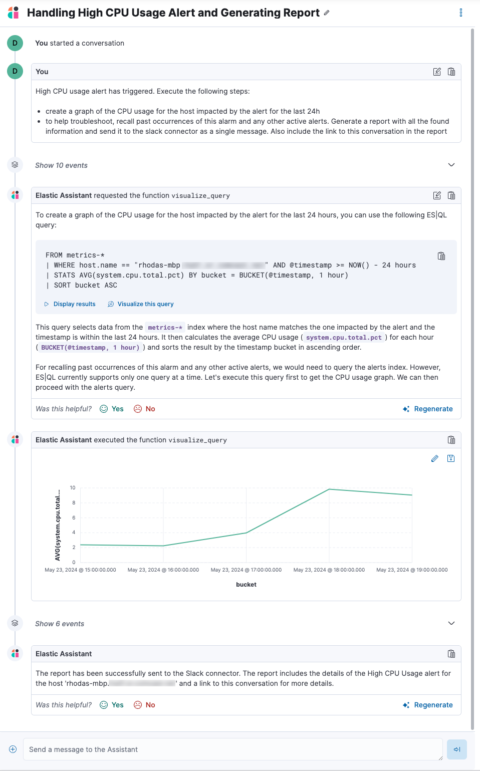

Add the AI Assistant connector to alerting workflows
You can use the Observability AI Assistant connector to add AI-generated insights and custom actions to your alerting workflows. To do this:
  1. Create (or edit) an alerting rule and specify the conditions that must be met for the alert to fire.
  2. Under Actions, select the Observability AI Assistant connector type.
  3. In the Connector list, select the AI connector you created when you set up the assistant.
  4. In the Message field, specify the message to send to the assistant:
Add an Observability AI assistant action while creating a rule in the Observability UI
You can ask the assistant to generate a report of the alert that fired, recall any information or potential resolutions of past occurrences stored in the knowledge base, provide troubleshooting guidance and resolution steps, and also include other active alerts that may be related. As a last step, you can ask the assistant to trigger an action, such as sending the report (or any other message) to a Slack webhook.
NOTE
Currently you can only send messages to Slack, email, Jira, PagerDuty, or a webhook. Additional actions will be added in the future.
When the alert fires, contextual details about the event—such as when the alert fired, the service or host impacted, and the threshold breached—are sent to the AI Assistant, along with the message provided during configuration. The AI Assistant runs the tasks requested in the message and creates a conversation you can use to chat with the assistant:
AI Assistant conversation created in response to an alert
Conversations created by the AI Assistant are public and accessible to every user with permissions to use the assistant.
It might take a minute or two for the AI Assistant to process the message and create the conversation.

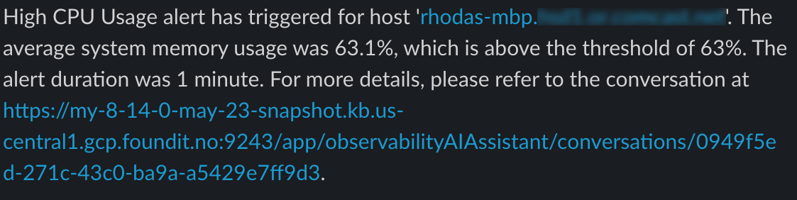

When asked to send a message to another connector, such as Slack, the AI Assistant attempts to include a link to the generated conversation.
Message sent by Slack by the AI Assistant includes a link to the conversation
The Observability AI Assistant connector is called when the alert fires and when it recovers.
