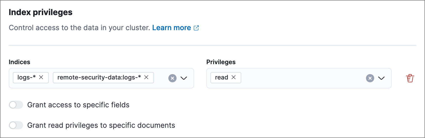

    1. Local cluster role: Assign the read privilege to the indices you want to search, using both the local and remote index patterns for each index. To specify a remote index, use the pattern <remote_cluster_name>:<index_name>.
      For example, if the remote cluster’s name is remote-security-data and you want to query the logs-* indices, include both the logs-* and remote-security-data:logs-* index patterns and assign them the read privilege.
      Local cluster role configuration

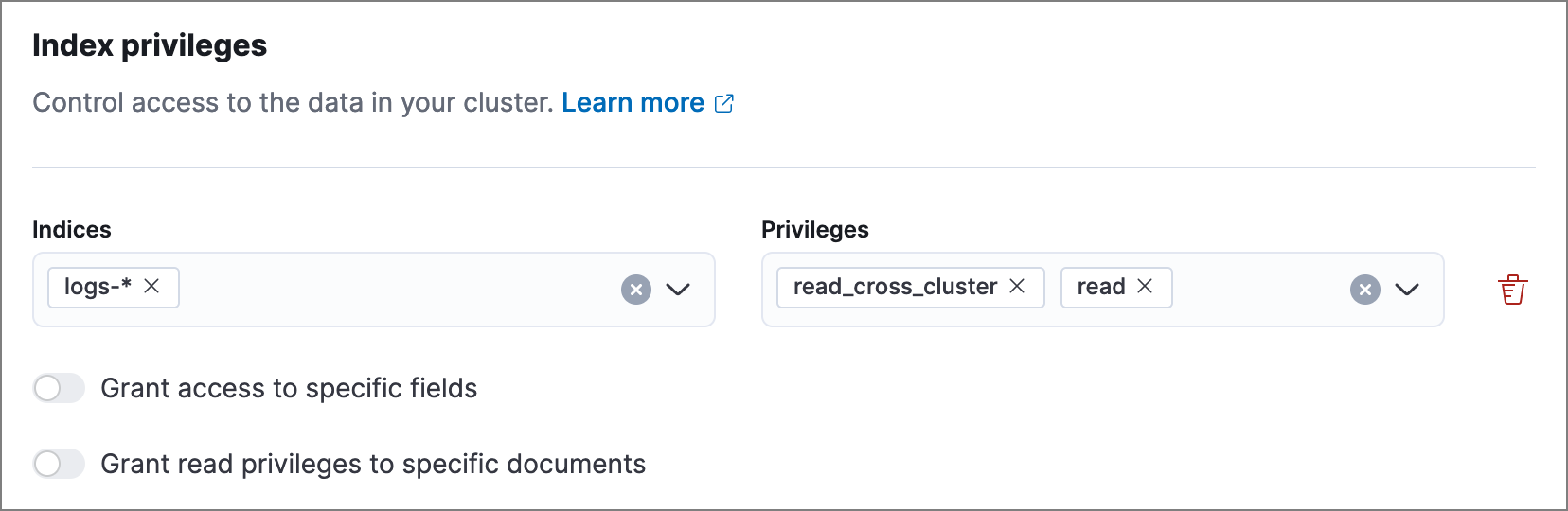

    2. Remote cluster role: Assign the read and read_cross_cluster privileges to the indices you want to search. You don’t need to include the remote cluster’s name here.
      Remote cluster role configuration

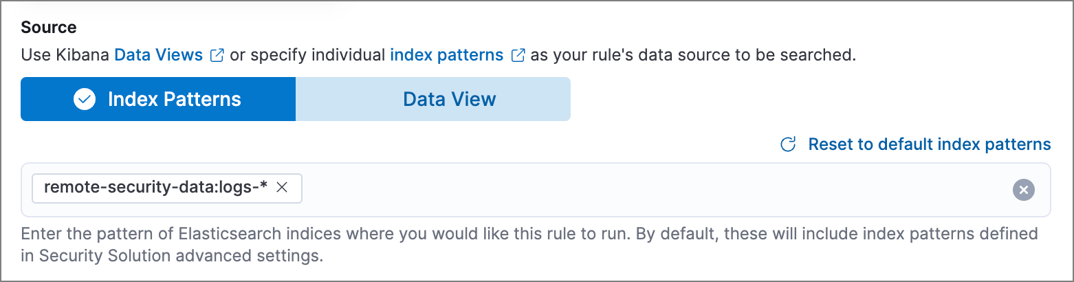

    2. As this user, configure a rule that searches the remote indices: create or edit a rule, then enter the <remote_cluster_name>:<index_name> pattern in the Source section.
      Rule source configuration
