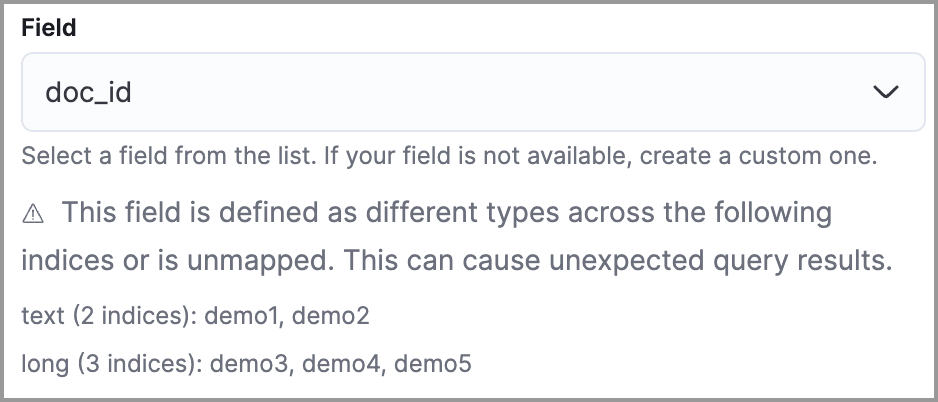

Fields with conflicting typesedit
Type conflicts occur when a field is mapped to different types across multiple indices. To resolve this issue, you can create new indices with matching field type mappings and reindex your data. Otherwise, use the information about a field’s type mappings to ensure you’re entering compatible field values when defining exception conditions.
In the following example, the selected field has been defined as different types across five indices.
Warning for fields with type conflicts

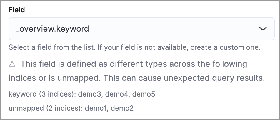

Unmapped fieldsedit
Unmapped fields are undefined within an index’s mapping definition. Using unmapped fields to define an exception can prevent it from working as expected, and lead to false positives or unexpected alerts. To fix unmapped fields, add them to your indices' mapping definitions.
In the following example, the selected field is unmapped across two indices.
Warning for unmapped fields
