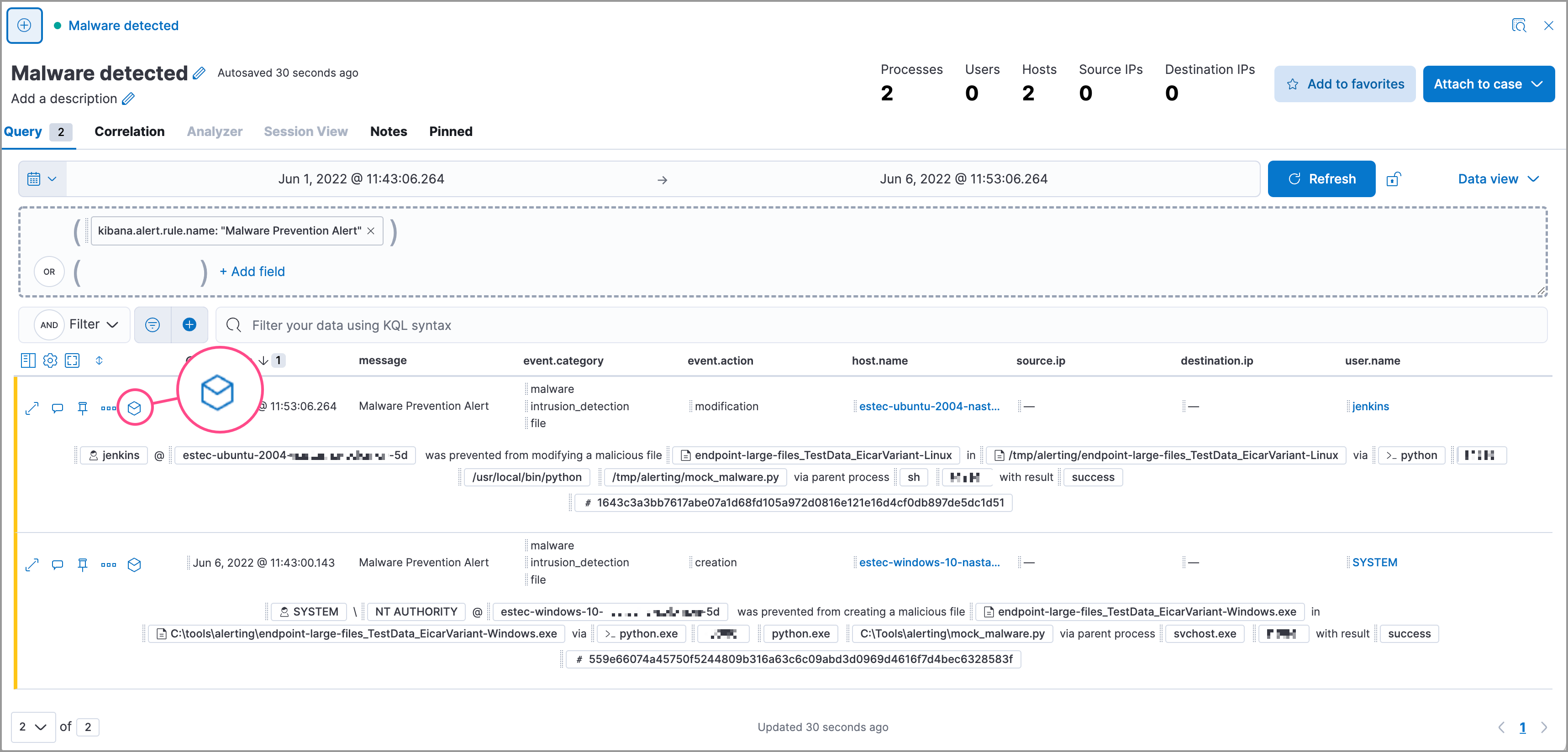

  1. First, display a list of events by doing one of the following:
    • Go to ExploreHosts, then select the Events tab. A list of all your hosts' events appears at the bottom of the page.
    • Go to Alerts, then scroll down to the Alerts table.
  2. Filter events that can be visually analyzed by entering either of the following queries in the KQL search bar, then selecting Enter:
    • agent.type:"endpoint" and process.entity_id :*
      Or
    • agent.type:"winlogbeat" and event.module: "sysmon" and process.entity_id : *

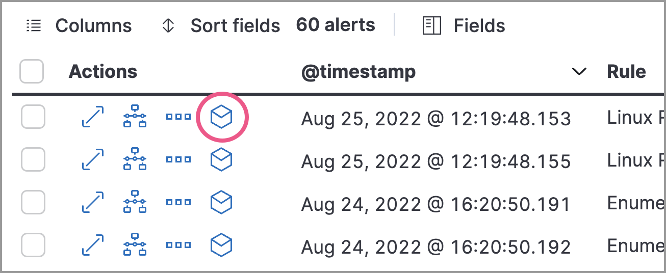

  3. Events that can be visually analyzed are denoted by a cubical Analyze event icon. Select this option to open the event in the visual analyzer.
    analyze event button
    Events that cannot be analyzed will not have the Analyze event option available. This might occur if the event has incompatible field mappings.
    analyze event timeline
You can also analyze events from Timelines.

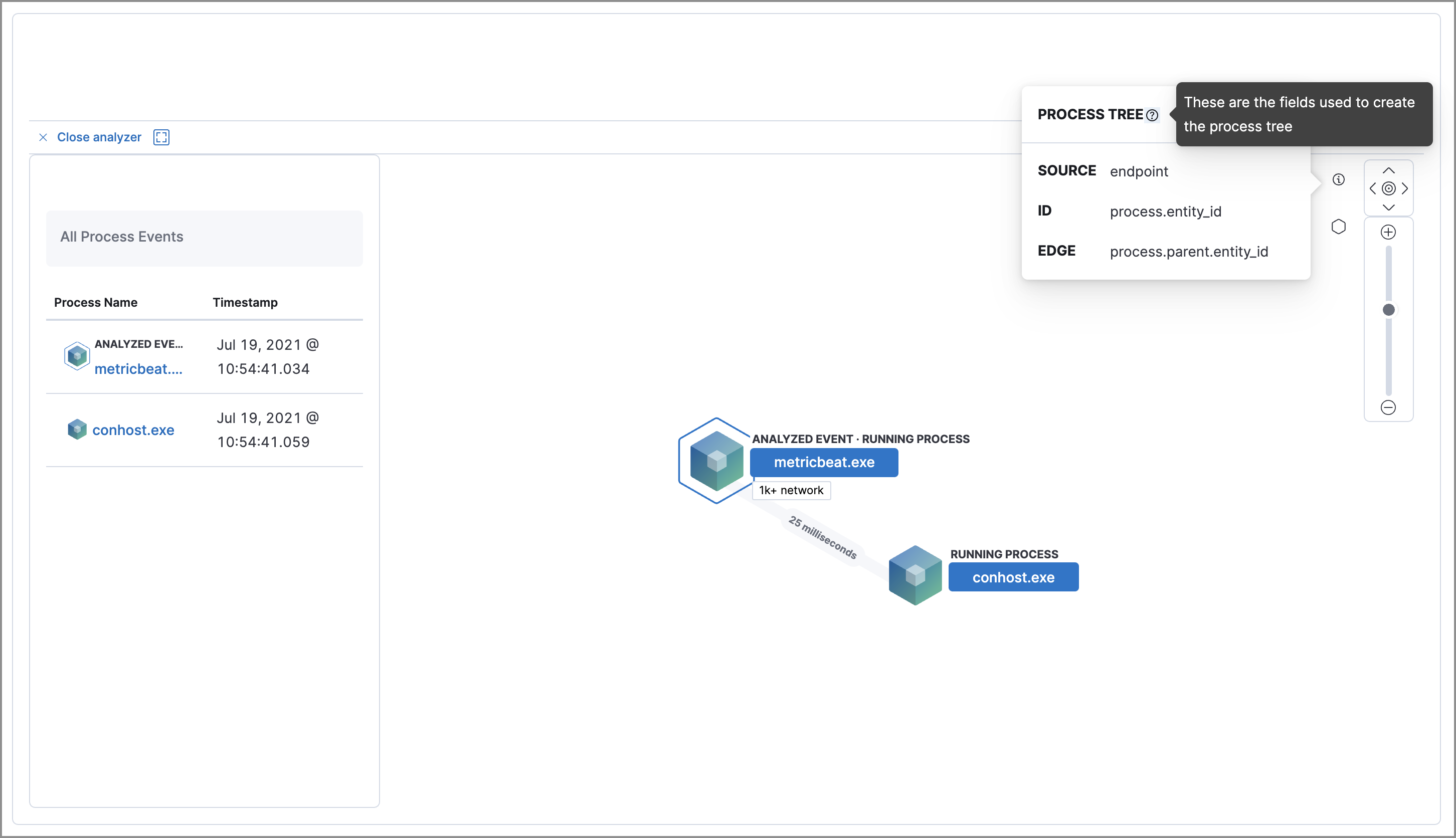

To understand what fields were used to create the process, select the Process Tree to show the schema that created the graphical view. The fields included are:
  • SOURCE: Can be either endpoint or winlogbeat
  • ID: Event field that uniquely identifies a node
  • EDGE: Event field which indicates the relationship between two nodes
process schema

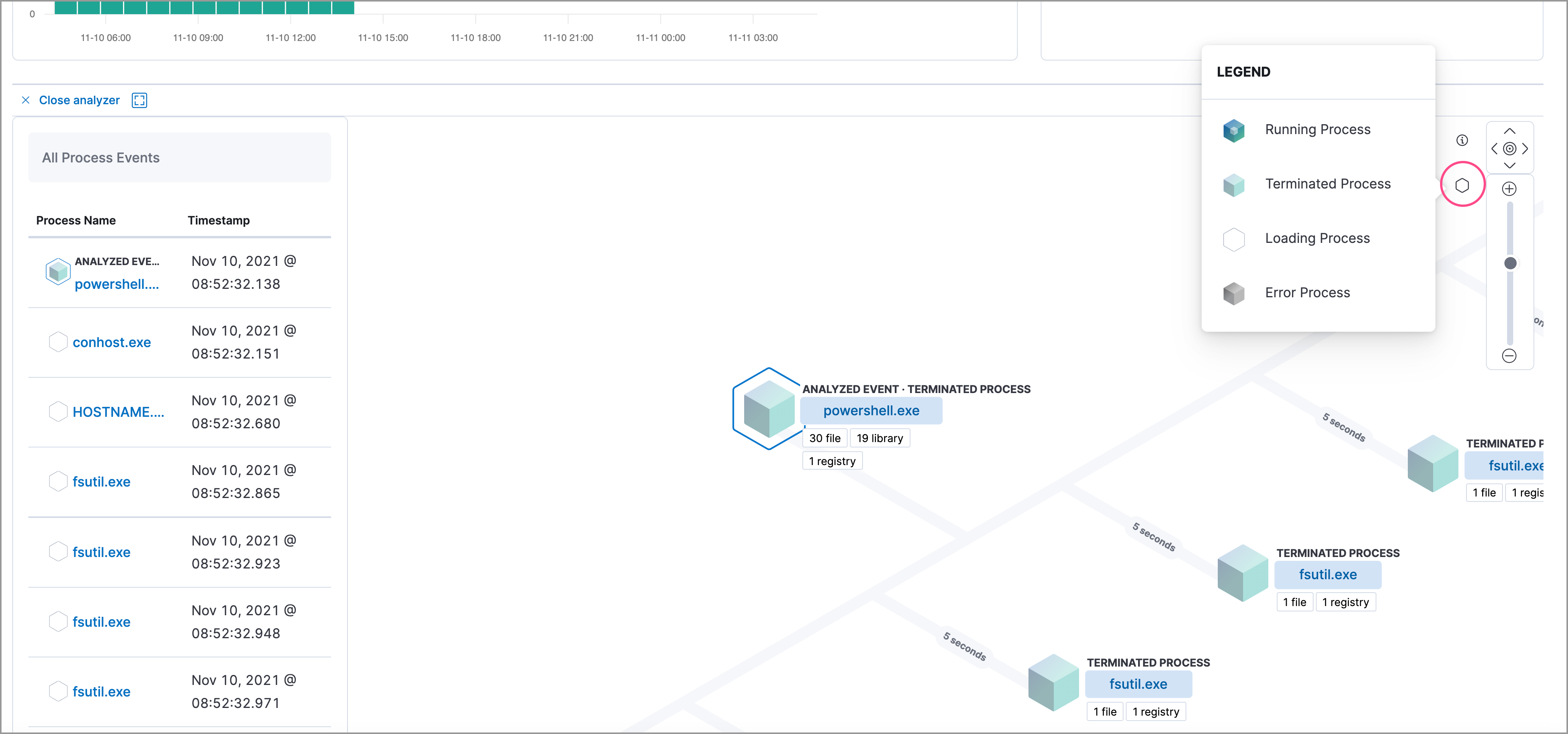

Click the Legend to show the state of each process node.
node legend

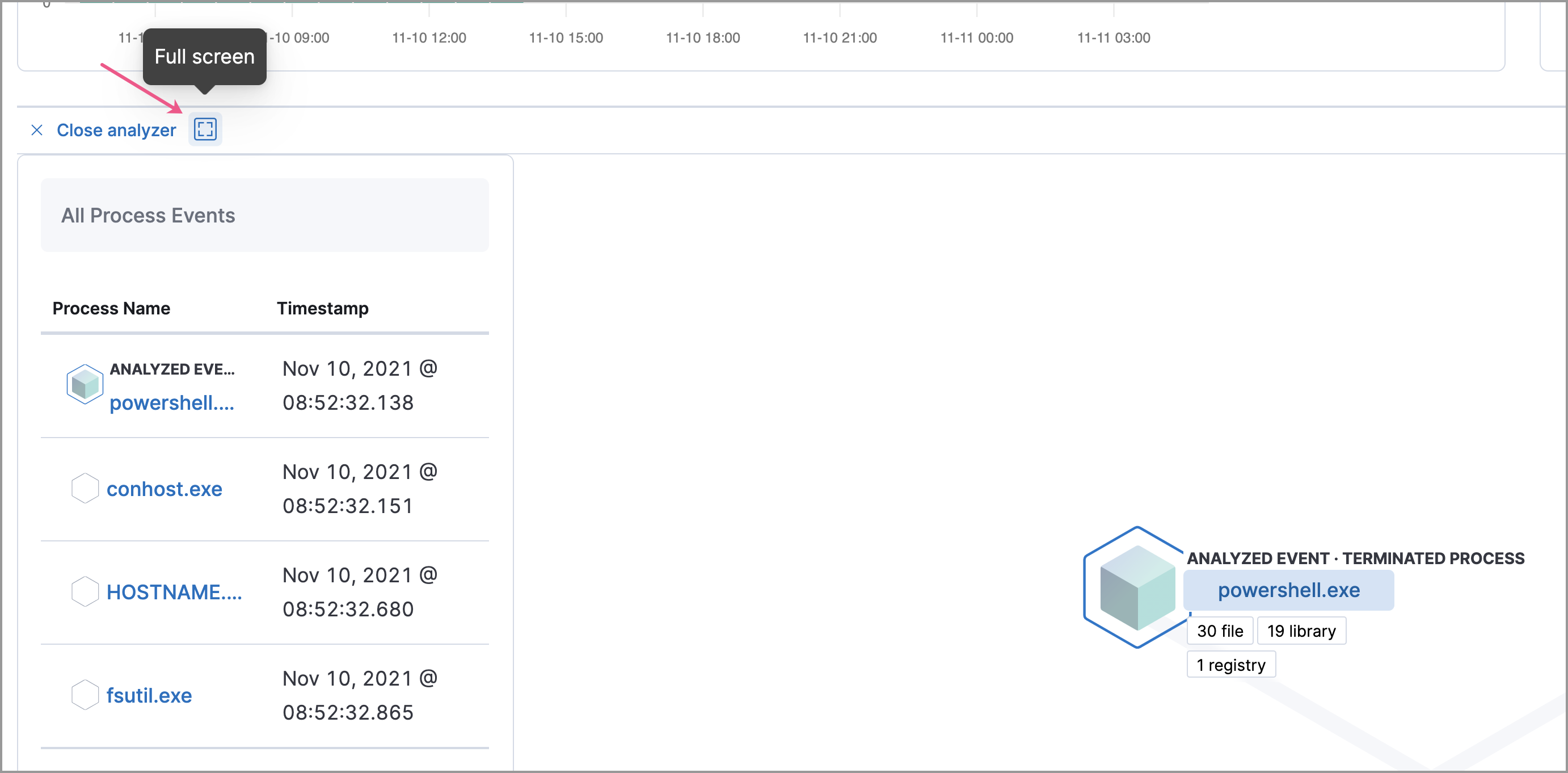

To expand the analyzer to a full screen, select the Full Screen icon above the left panel.
full screen analyzer

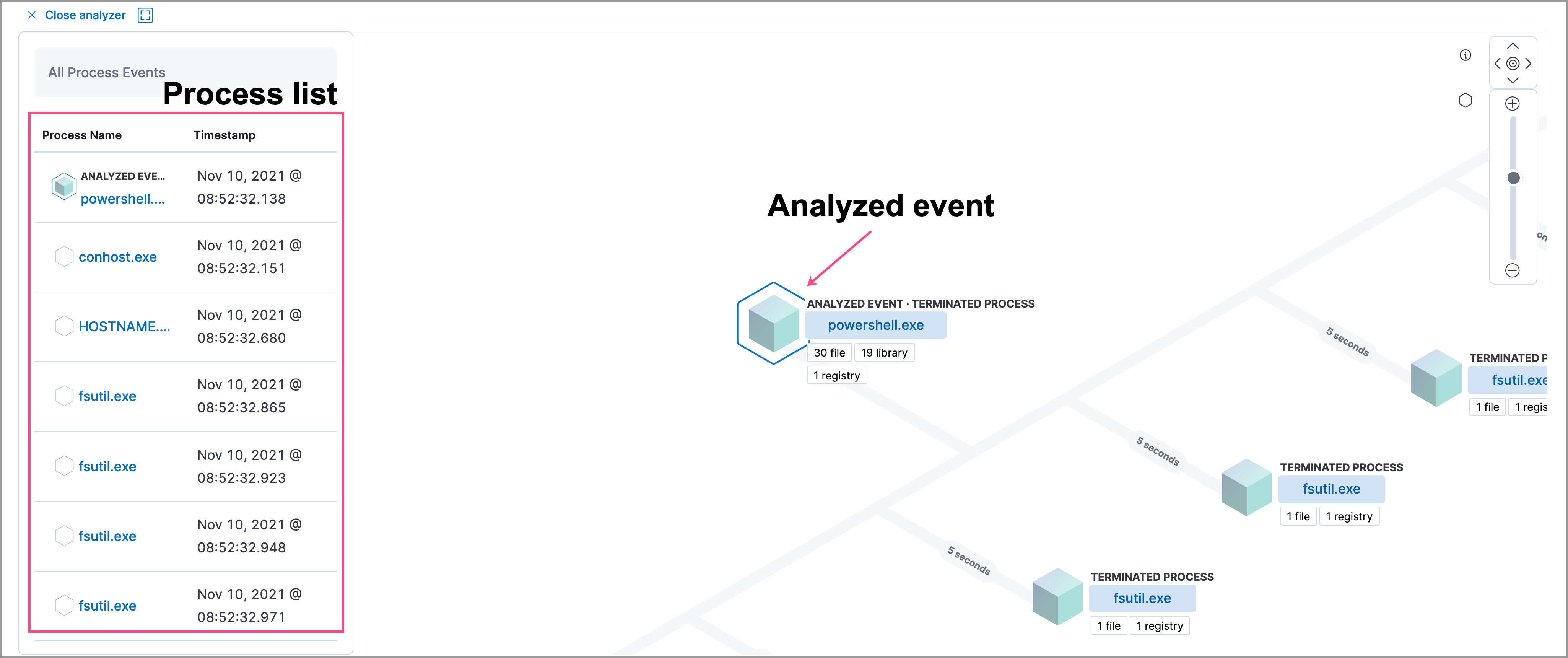

The left panel contains a list of all processes related to the event, starting with the event chain’s first process. Analyzed Events — the event you selected to analyze from the events list or Timeline — are highlighted with a light blue outline around the cube.
process list

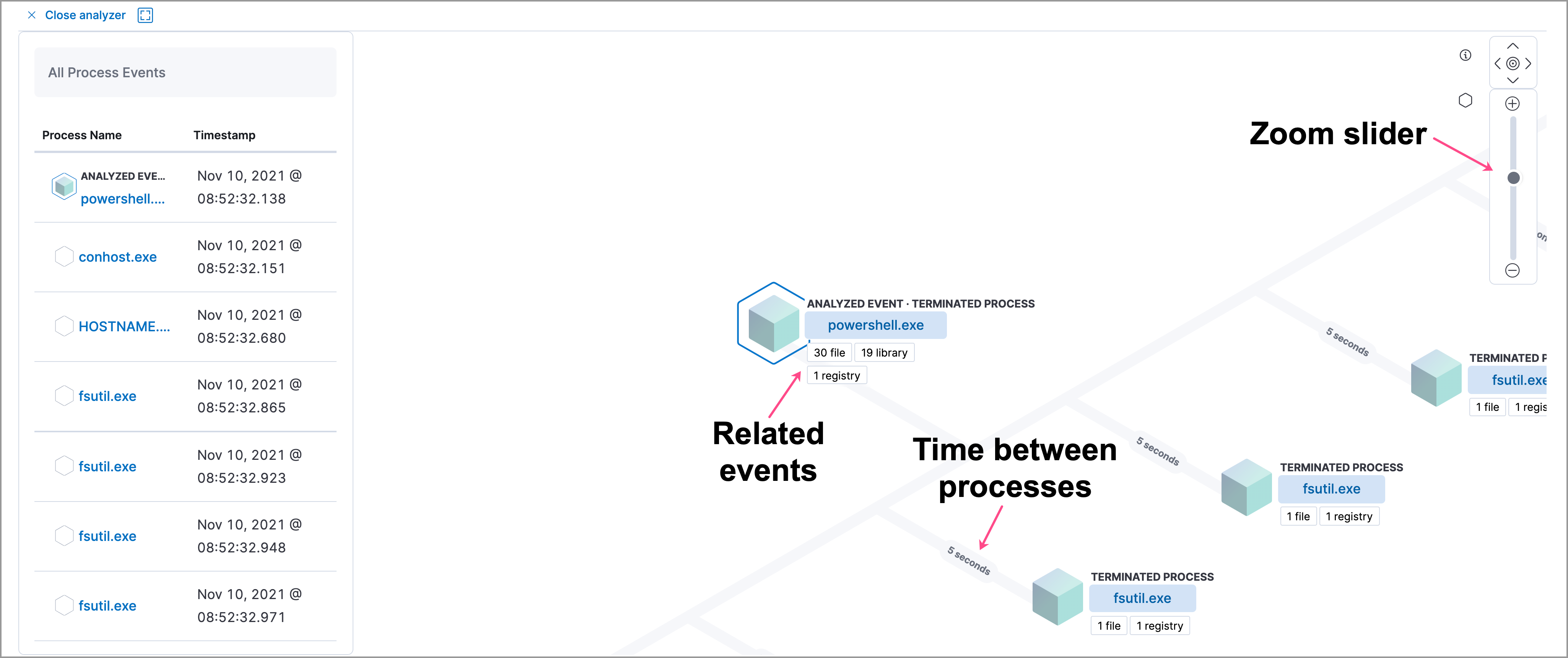

In the graphical view, you can:
  • Zoom in and out of the graphical view using the slider on the far right
  • Click and drag around the graphical view to more process relationships
  • Observe child process events that spawned from the parent process
  • Determine how much time passed between each process
  • Identify all events related to each process
graphical view

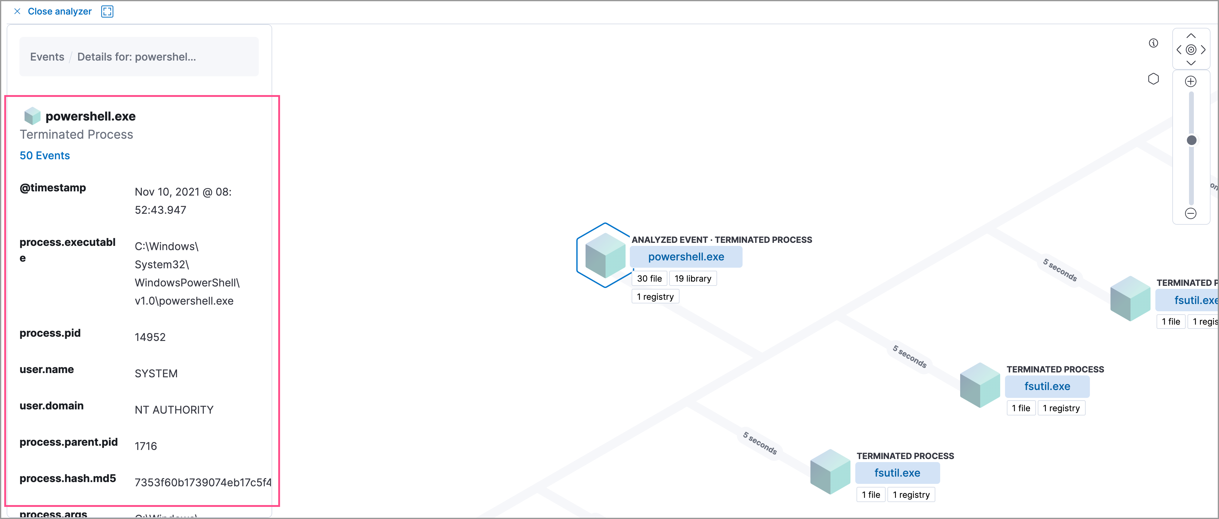

To learn more about each related process, select the process in the left panel or the graphical view. The left panel displays process details such as:
  • The number of events associated with the process
  • The timestamp of when the process was executed
  • The file path of the process within the host
  • The process-pid
  • The user name and domain that ran the process
  • Any other relevant process information
  • Any associated alerts
process details

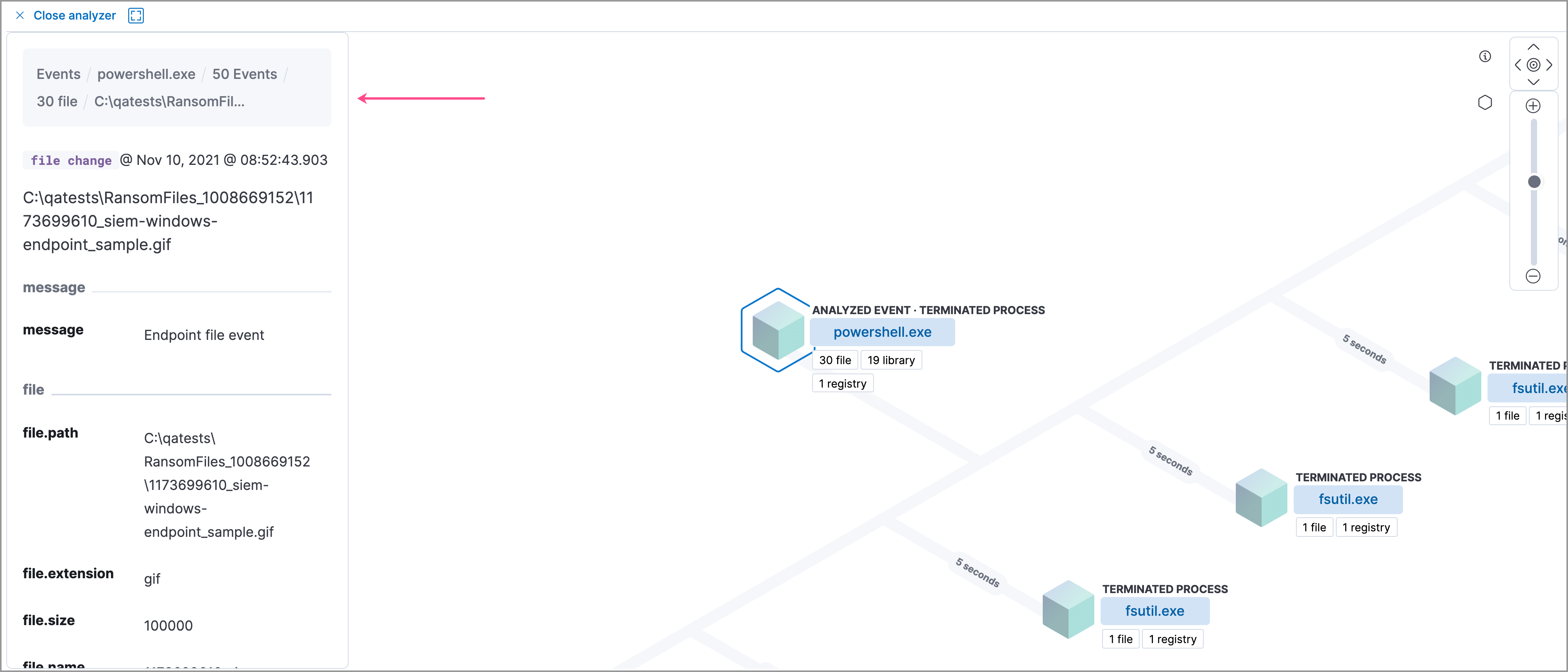

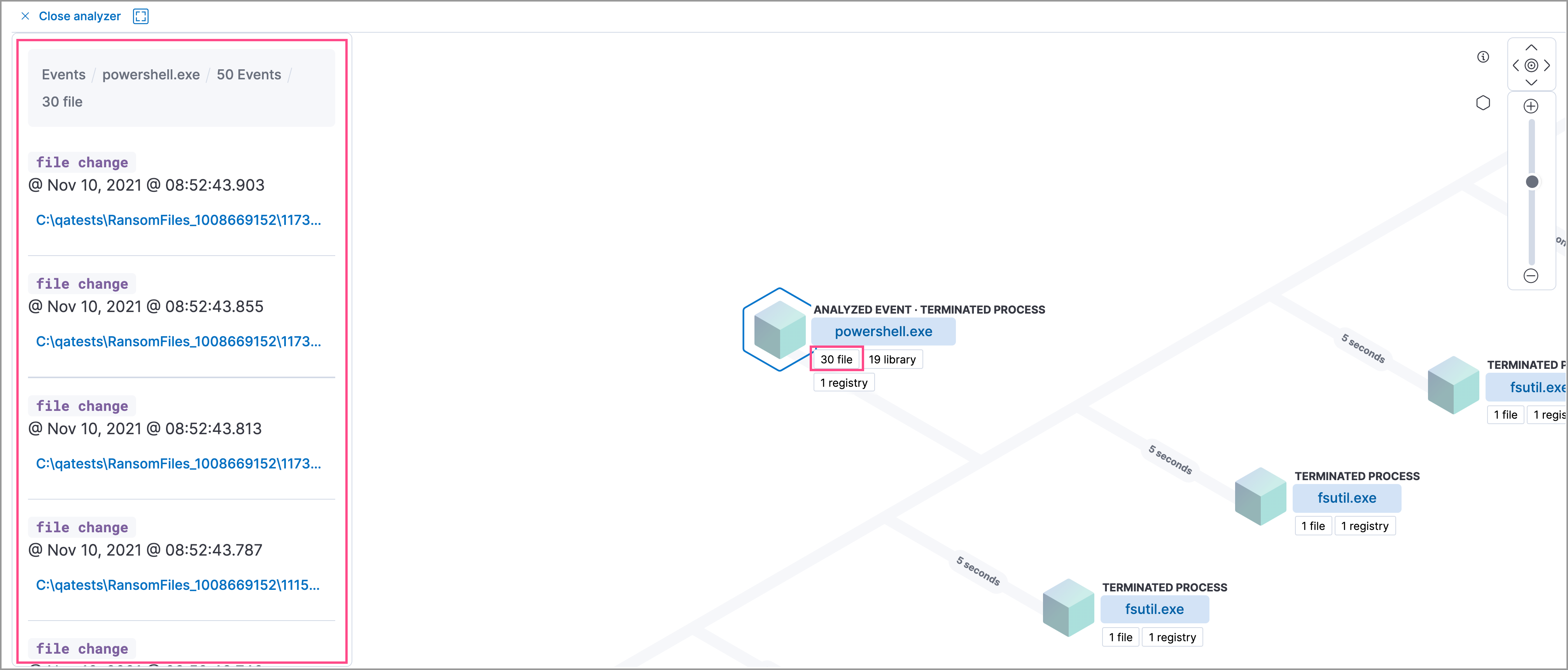

Access event details by selecting that event’s URL at the top of the process details view or choosing one of the event pills in the graphical view.
Events are categorized based on the event.category value.
event type
When you select an event.category pill, all the events within that category are listed in the left panel. To display more details about a specific event, select it from the list.
event details

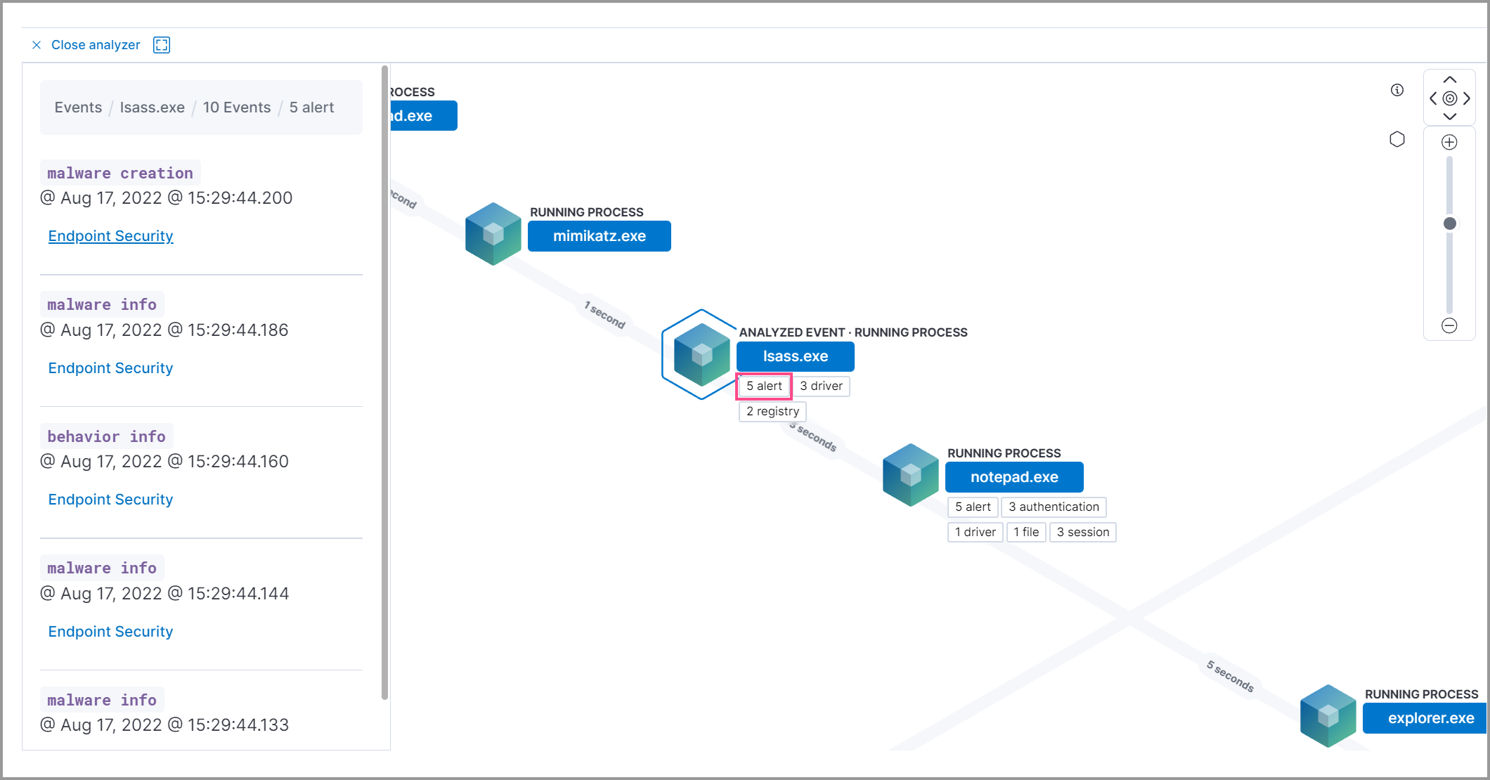

To examine alerts associated with the event, select the alert pill (x alert). The left pane lists the total number of associated alerts, and alerts are ordered from oldest to newest. Each alert shows the type of event that produced it (event.category), the event timestamp (@timestamp), and rule that generated the alert (kibana.alert.rule.name). Click on the rule name to open the alert’s details.
In the example screenshot below, five alerts were generated by the analyzed event (lsass.exe). The left pane displays the associated alerts and basic information about each one.
