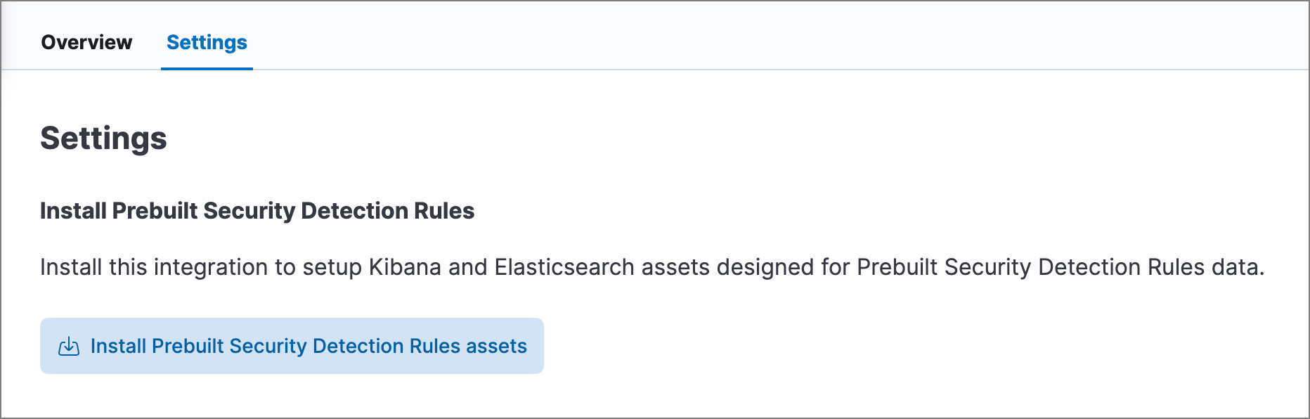

To download the latest version of prebuilt rules:
  1. In Kibana, go to Management → Integrations.
  2. Search for "Prebuilt Security Detection Rules."
  3. Select the integration, then select the Settings tab. The integration settings page is displayed.
    install prebuilt settings
  4. Click Install Prebuilt Security Detection Rules assets.

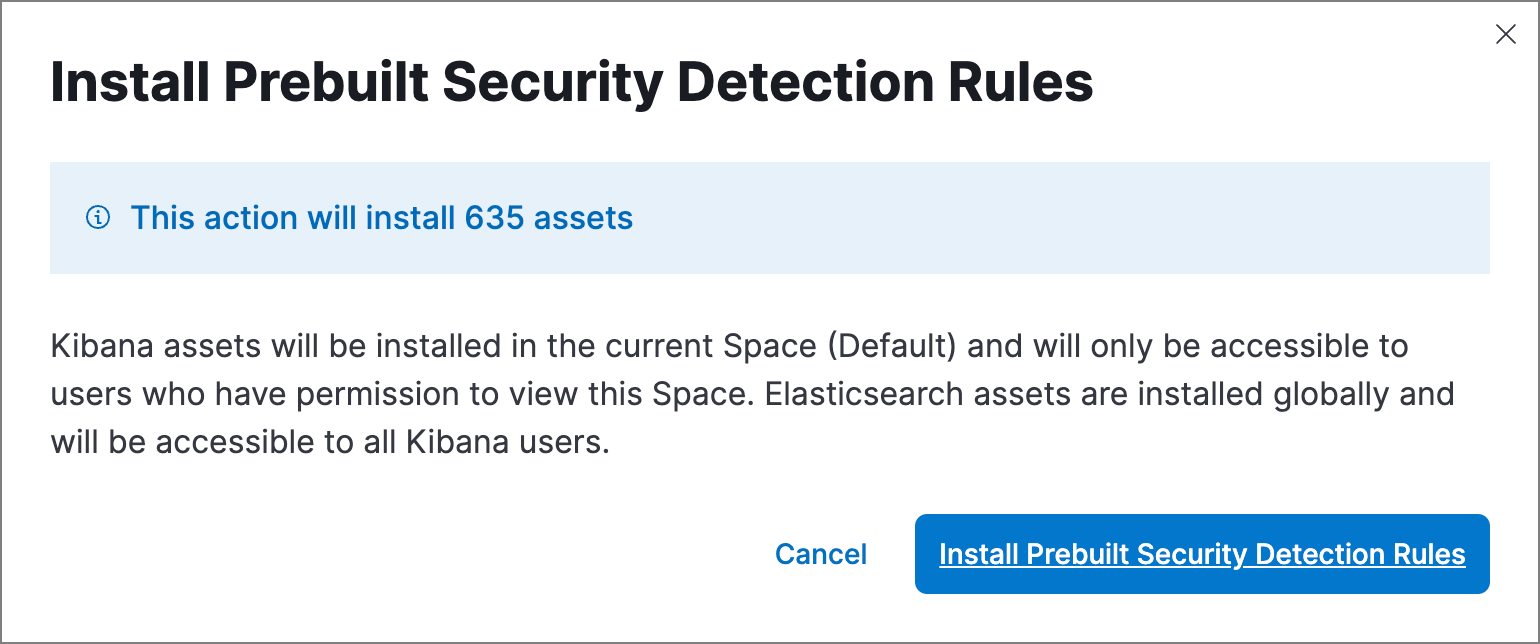

  5. Click Install Prebuilt Security Detection Rules to confirm the installation.
    install prebuilt rules

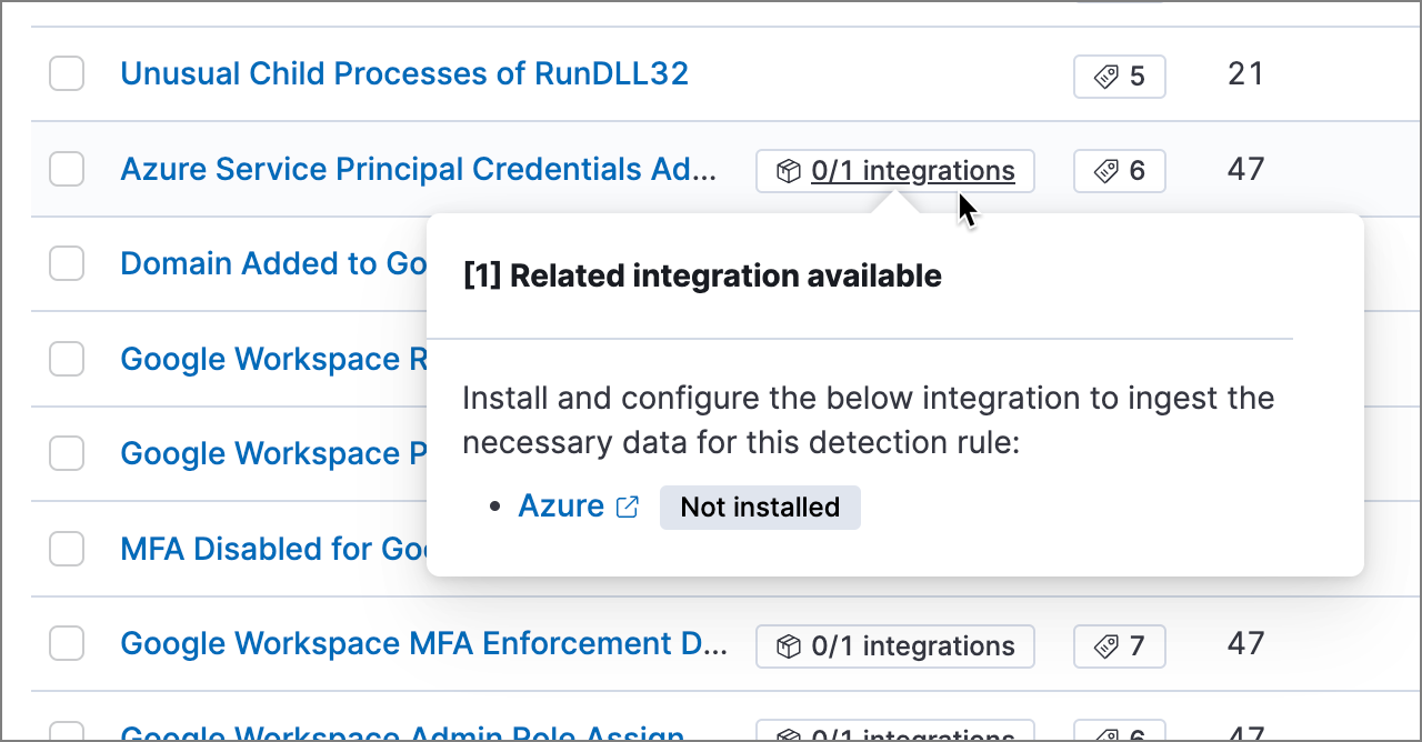

You can also check rules' related integrations in the Rules and Rule Monitoring tables. Click the integrations badge to display the related integrations in a popup.
Rules table with related integrations popup
You can hide the integrations badge in the Rules tables. Go to Kibana → Stack Management → Advanced Settings, then turn off securitySolution:showRelatedIntegrations.
