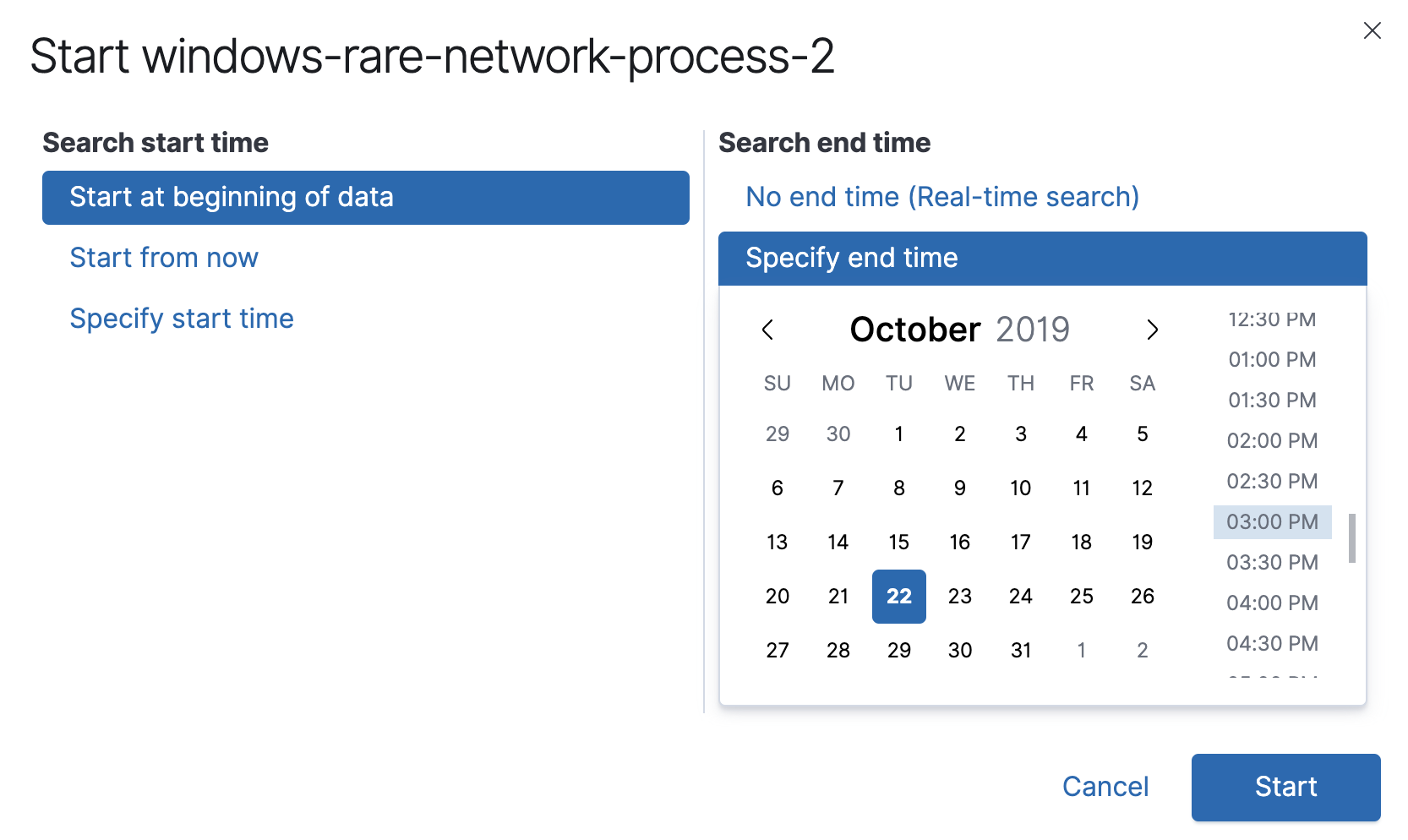

    The Start <job name> window is displayed.
    start job window
  11. Select the point of time from which the job will analyze anomalies.
  12. Click Start.
    After a while, results will start to appear on the Anomaly Explorer page.
