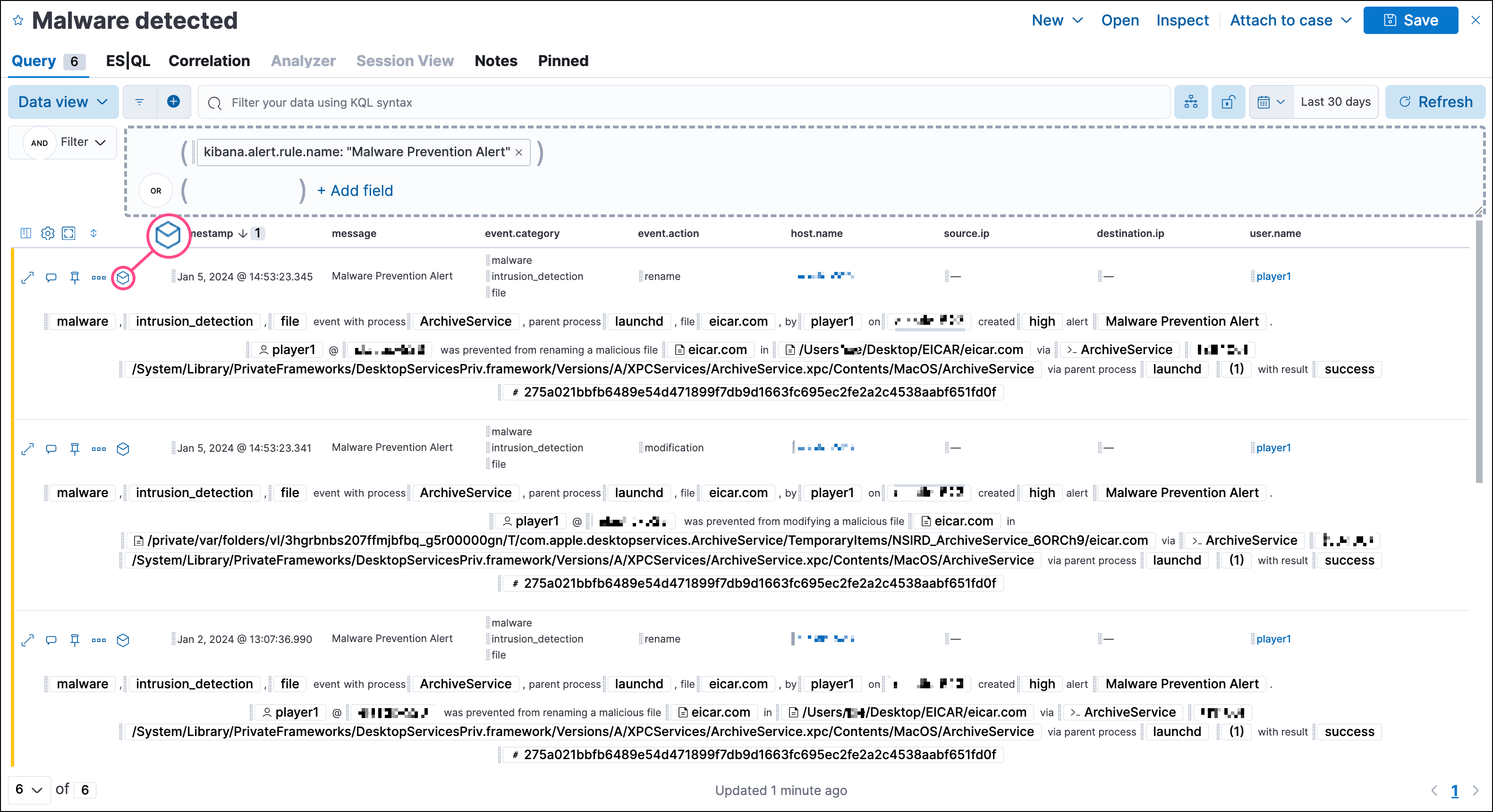

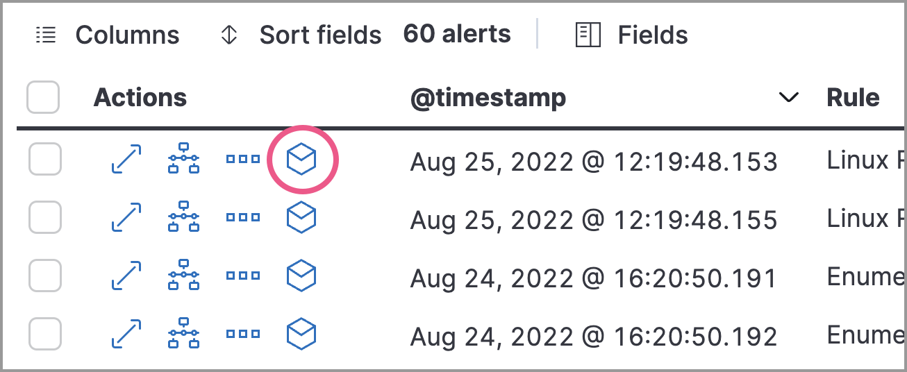

Events that can be visually analyzed are denoted by a cubical Analyze event icon. Select this option to open the event in the visual analyzer. The event analyzer is accessible from the Hosts, Alerts, and Timelines pages, as well as the alert details flyout.
