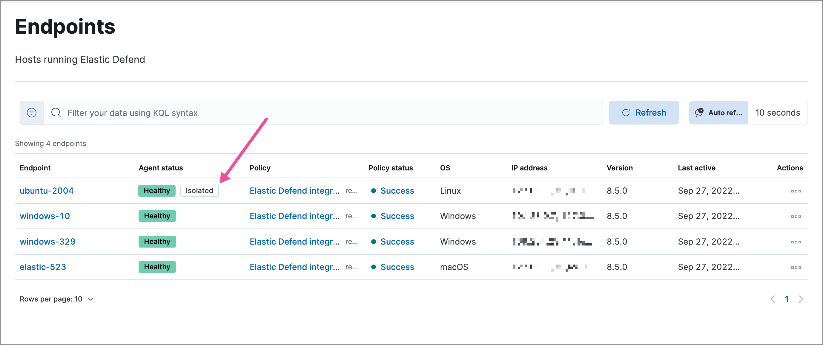

You can isolate a host from a detection alert’s details flyout, from the Endpoints page, or (with an Enterprise subscription) from the endpoint response console. Once a host is successfully isolated, an Isolated status displays next to the Agent status field, which you can view on the alert details flyout or Endpoints list table.

Isolate a host from an endpoint
Find Endpoints in the navigation menu or use the global search field, then either:
- Select the appropriate endpoint in the Endpoint column, and click Take action → Isolate host in the endpoint details flyout.
- Click the Actions menu (…) on the appropriate endpoint, then select Isolate host.

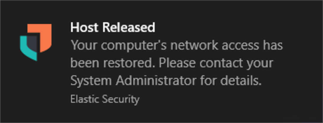

After the host is successfully released, the Isolated status is removed from the endpoint. Active end users receive a notification that the computer has been reconnected to the network:

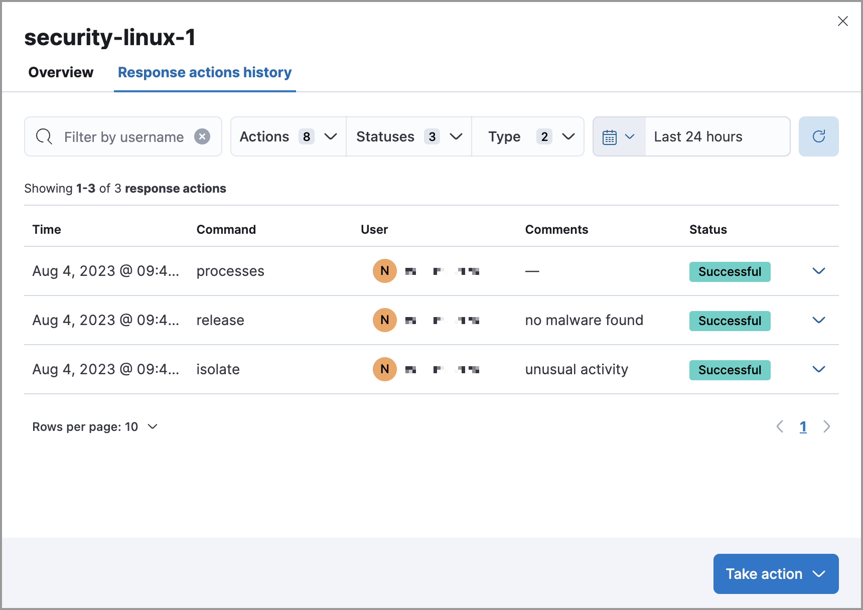

View host isolation history
editTo confirm if a host has been successfully isolated or released, check the response actions history, which logs the response actions performed on a host.
Go to the Endpoints page, click an endpoint’s name, then click the Response action history tab. You can filter the information displayed in this view. Refer to Response actions history for more details.
