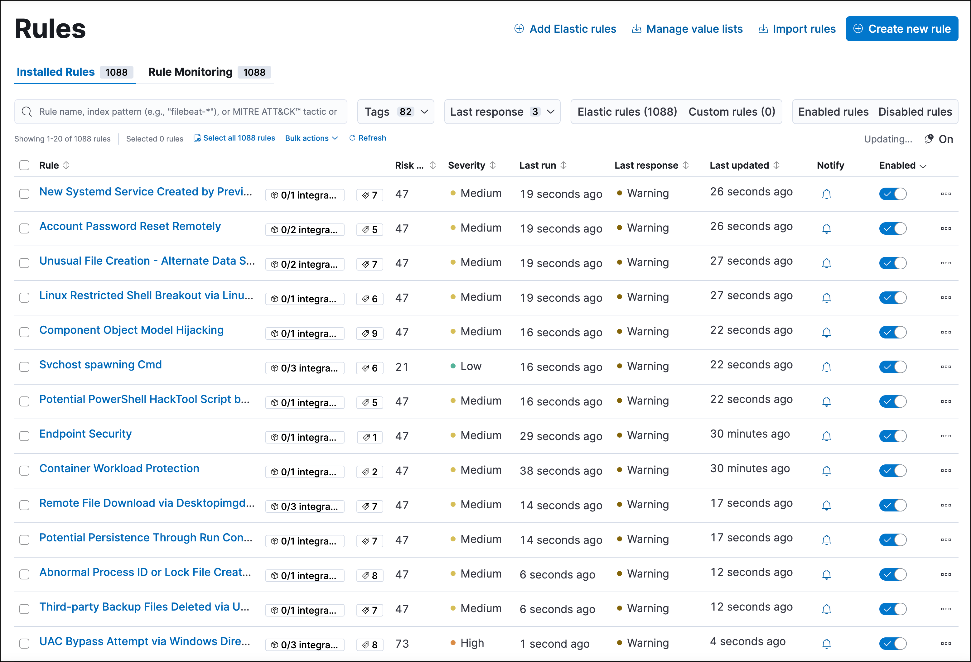

The Rules page allows you to view and manage all prebuilt and custom detection rules.
The Rules page
On the Rules page, you can:
Sort and filter the rules list
To sort the rules list, click any column header. To sort in descending order, click the column header again.
To filter the rules list, enter a search term in the search bar and press Return:
  • Rule name — Enter a word or phrase from a rule’s name.
  • Index pattern — Enter an index pattern (such as filebeat-*) to display all rules that use it.
  • MITRE ATT&CK tactic or technique — Enter a MITRE ATT&CK tactic name (such as Defense Evasion) or technique number (such as TA0005) to display all associated rules.
Searches for index patterns and MITRE ATT&CK tactics and techniques must match exactly, are case sensitive, and do not support wildcards. For example, to find rules using the filebeat-* index pattern, the search term filebeat-* is valid, but filebeat and file* are not because they don’t exactly match the index pattern. Likewise, the MITRE ATT&CK tactic Defense Evasion is valid, but Defense, defense evasion, and Defense* are not.
You can also filter the rules list by selecting the Tags, Last response, Elastic rules, Custom rules, Enabled rules, and Disabled rules filters next to the search bar.
The rules list retains your sorting and filtering settings when you navigate away and return to the page. These settings are also preserved when you copy the page’s URL and paste into another browser. Select Clear filters above the table to revert to the default view.
Check the current status of rules
The Last response column displays the current status of each rule, based on the most recent attempt to run the rule:
  • Succeeded: The rule completed its defined search. This doesn’t necessarily mean it generated an alert, just that it ran without error.
  • Failed: The rule encountered an error that prevented it from running. For example, a machine learning rule whose corresponding machine learning job wasn’t running.
  • Warning: Nothing prevented the rule from running, but it might have returned unexpected results. For example, a custom query rule tried to search an index pattern that couldn’t be found in Elasticsearch.
For machine learning rules, an indicator icon (Error icon from rules table) also appears in this column if a required machine learning job isn’t running. Click the icon to list the affected jobs, then click Visit rule details page to investigate to open the rule’s details page, where you can start the machine learning job.

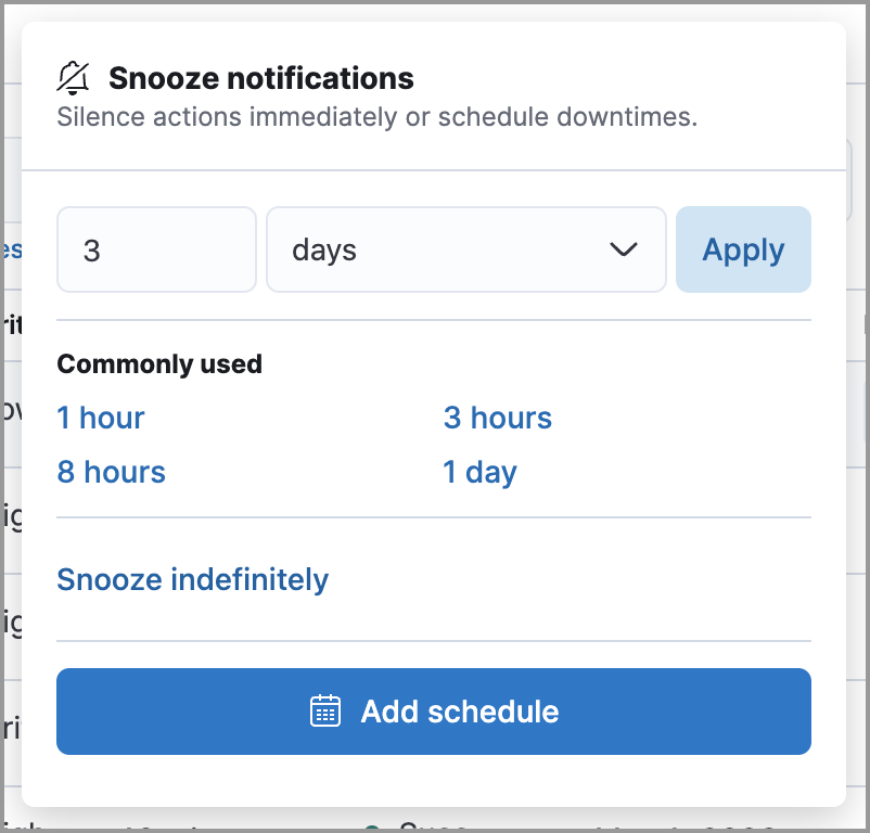

Snooze rule actions
Instead of turning rules off to stop alert notifications, you can snooze rule actions for a specified time period. When you snooze rule actions, the rule continues to run on its defined schedule, but won’t perform any actions or send alert notifications.
You can snooze notifications temporarily or indefinitely. When actions are snoozed, you can cancel or change the duration of the snoozed state. You can also schedule and manage recurring downtime for actions.
You can snooze rule notifications from the Installed Rules tab, the rule details page, or the Actions tab when editing a rule.

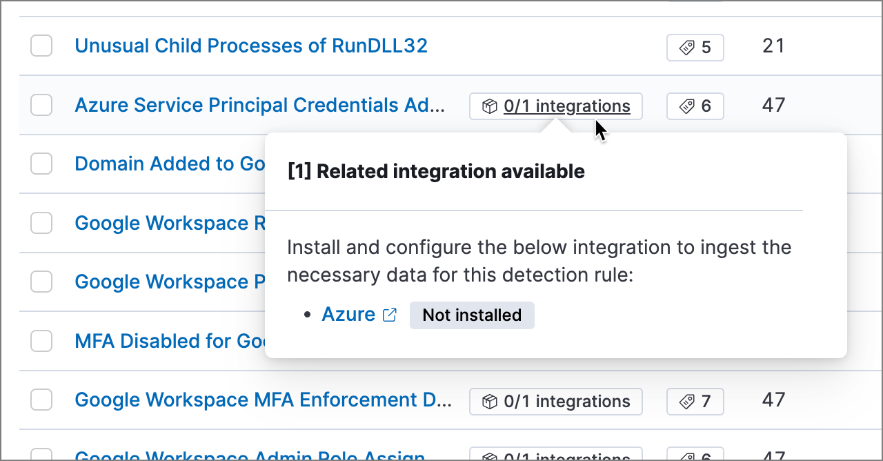

Confirm rule prerequisites
Many detection rules are designed to work with specific Elastic integrations and data fields. These prerequisites are identified in Related integrations and Required fields on a rule’s details page. Related integrations also displays each integration’s installation status and includes links for installing and configuring the listed integrations.
Additionally, the Setup guide section provides guidance on setting up the rule’s requirements.
Rule details page with Related integrations
You can also check rules' related integrations in the Installed Rules and Rule Monitoring tables. Click the integrations badge to display the related integrations in a popup.
Rules table with related integrations popup
