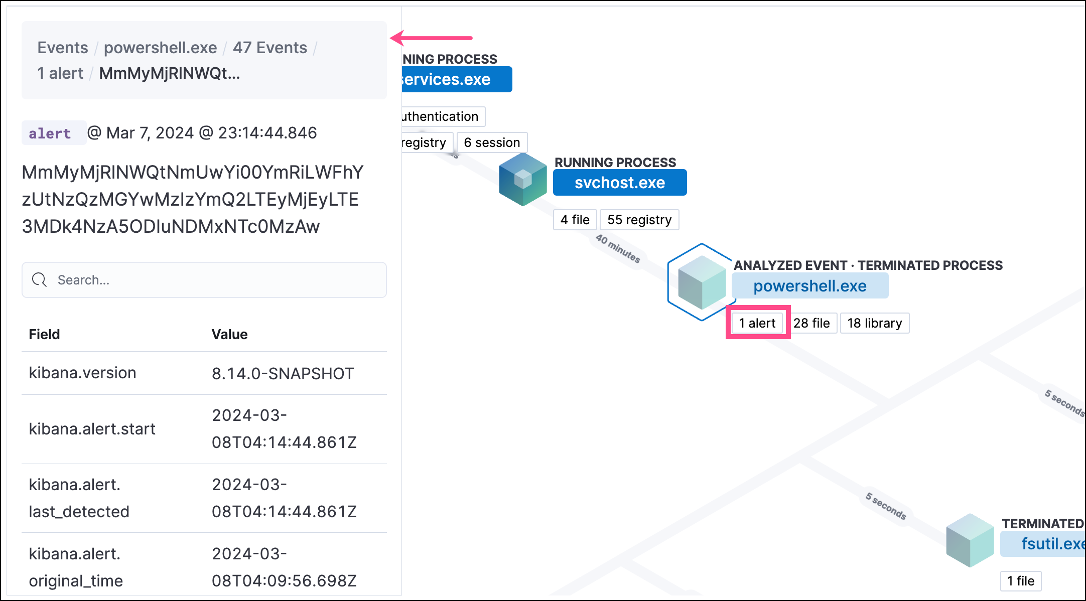

If you have a Platinum or Enterprise subscription, you can also examine alerts associated with events.
To examine alerts associated with the event, select the alert pill (x alert). The left pane lists the total number of associated alerts, and alerts are ordered from oldest to newest. Each alert shows the type of event that produced it (event.category), the event timestamp (@timestamp), and rule that generated the alert (kibana.alert.rule.name). Click on the rule name to open the alert’s details.
In the example screenshot below, five alerts were generated by the analyzed event (lsass.exe). The left pane displays the associated alerts and basic information about each one.
alert pill
