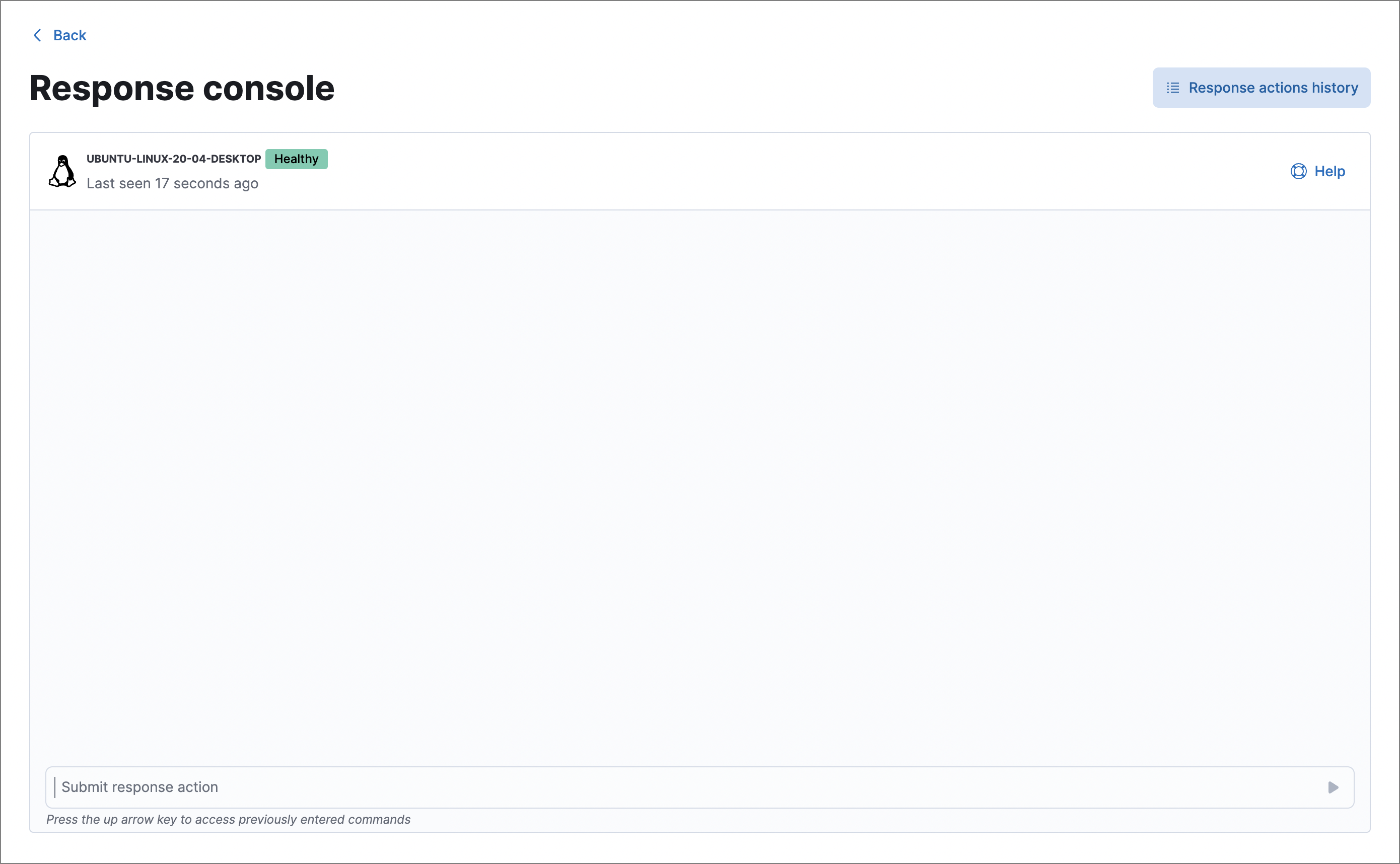

Response console UI
Launch the response console from any of the following places in Elastic Security:
  • Endpoints page → Actions menu (…​) → Respond
  • Endpoint details flyout → Take actionRespond
  • Alert details flyout → Take actionRespond
To perform an action on the endpoint, enter a response action command in the input area at the bottom of the console, then press Return. Output from the action is displayed in the console.

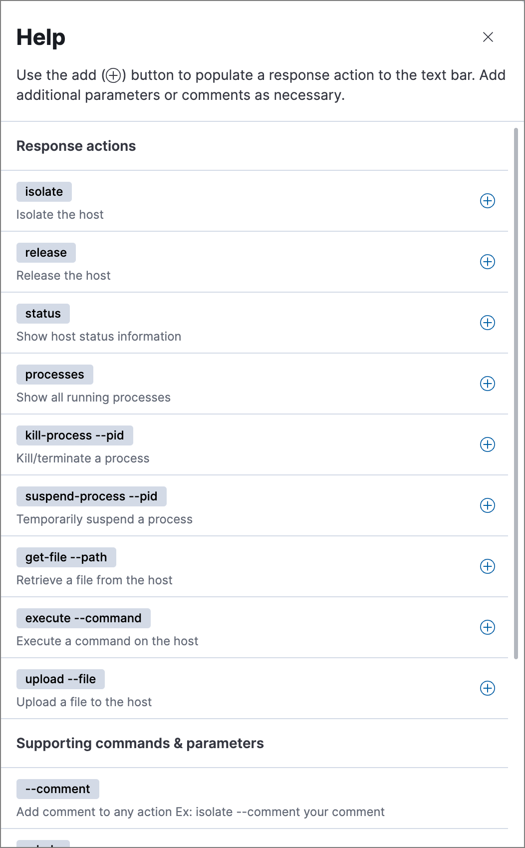

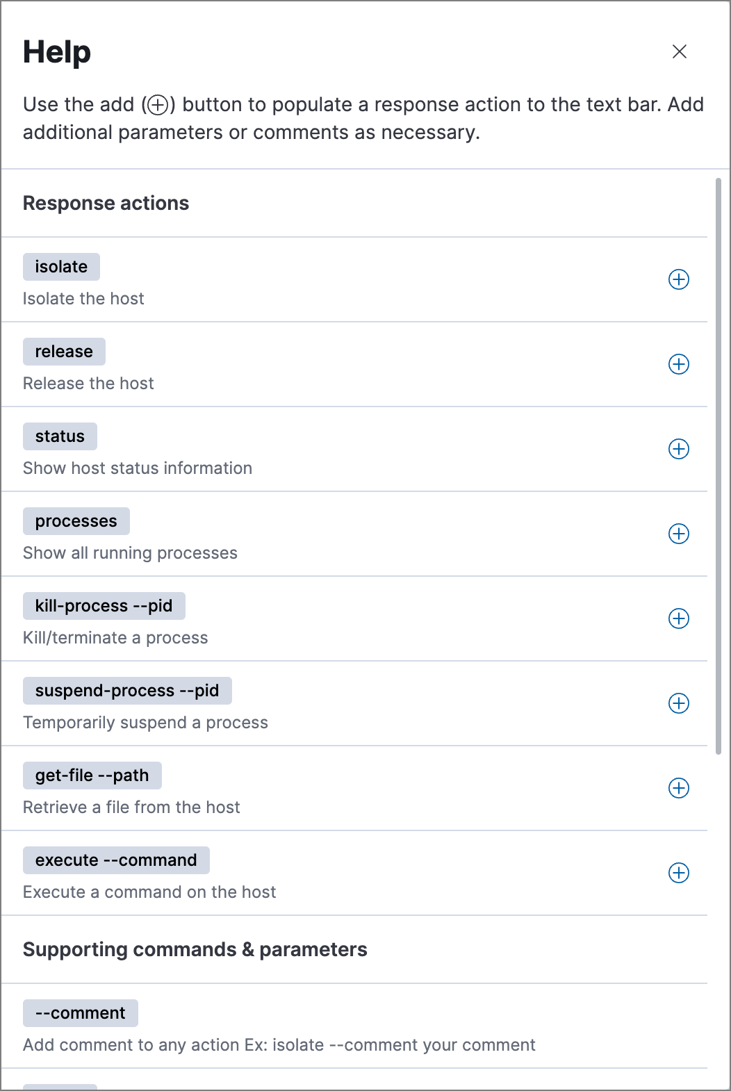

Help paneledit
Click Help icon Help in the upper-right to open the Help panel, which lists available response action commands and parameters as a reference.
This panel displays only the response actions that the user has privileges to perform.
Help panel
You can use this panel to build commands with less typing. Click the add icon (Add icon) to add a command to the input area, enter any additional parameters or a comment, then press Return to run the command.

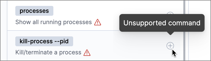

If the endpoint is running an older version of Elastic Agent, some response actions may not be supported, as indicated by an informational icon and tooltip. Upgrade Elastic Agent on the endpoint to be able to use the latest response actions.

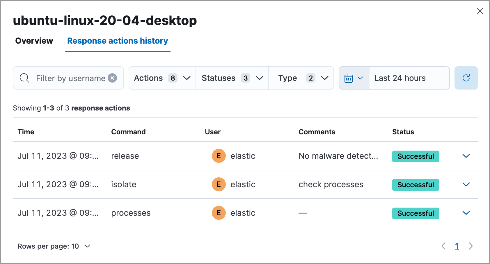

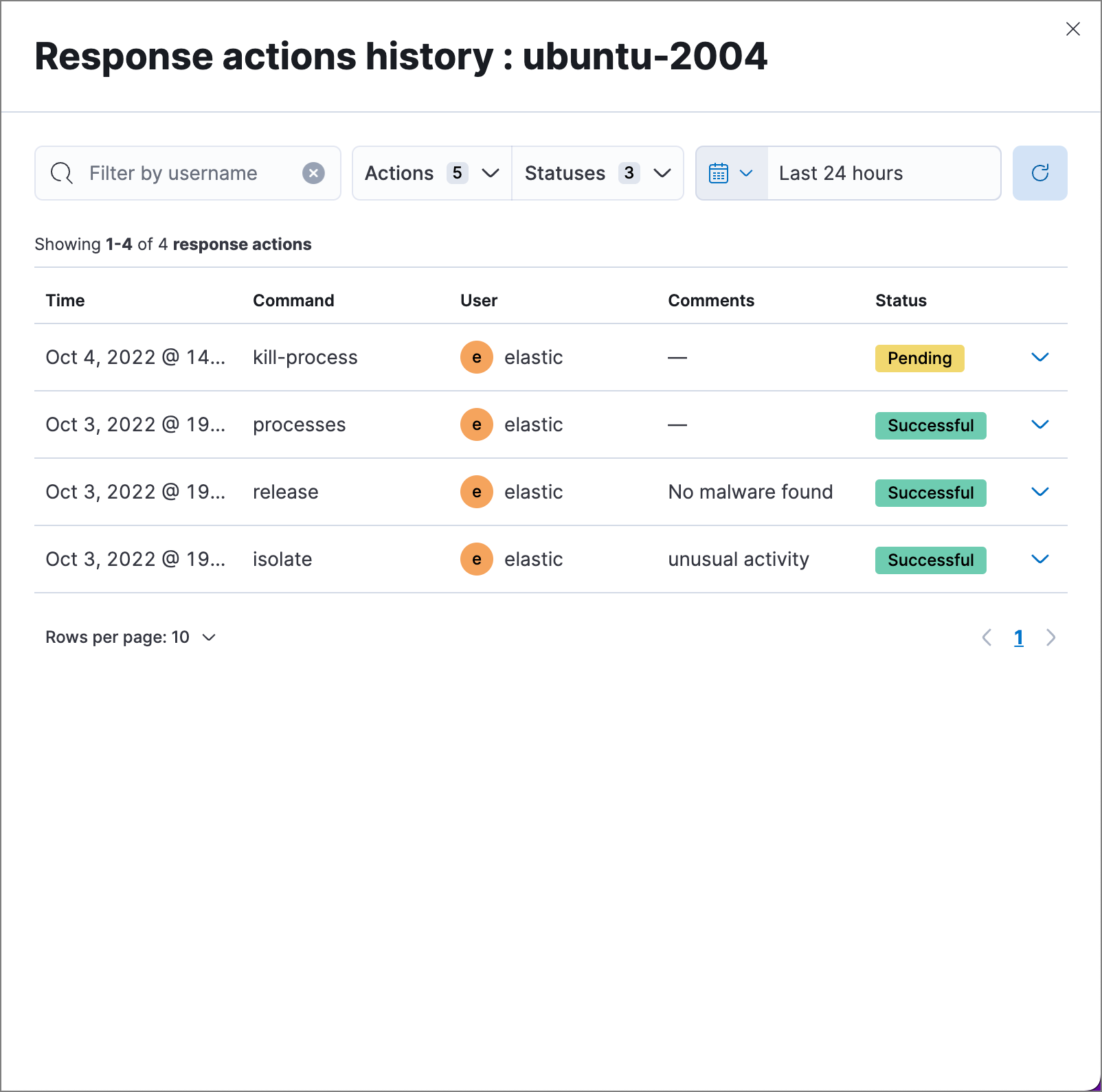

Response actions historyedit
Click Response actions history to display a log of the response actions performed on the endpoint, such as isolating a host or terminating a process. You can filter the information displayed in this view. Refer to Response actions history for more details.
