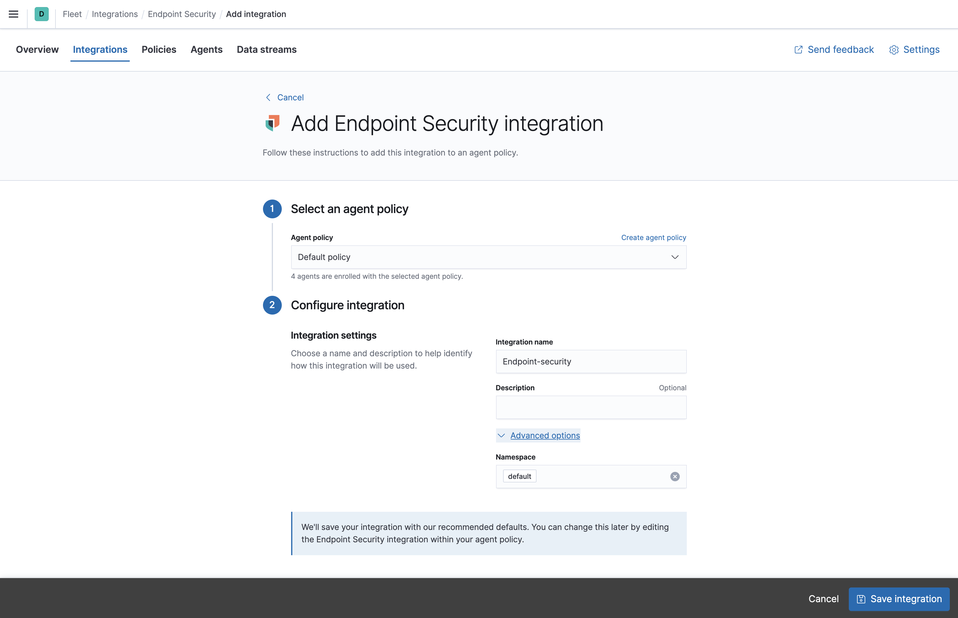

  2. On the Administration page of the Elastic Security app or the Endpoint Security integration page in Fleet, select Add Endpoint Security. The integration configuration page appears.
  3. Select a configuration for the Elastic Agent. You can use either the Default config, or add security integration to a custom or existing configuration. For more details on Elastic Agent configuration settings, see Configuration settings.
  4. Configure the Endpoint Security integration with a name and optional description. When configuration is complete, select Save integration. Kibana redirects you back to the administration section of the Elastic Security app.
    add elastic endpoint security

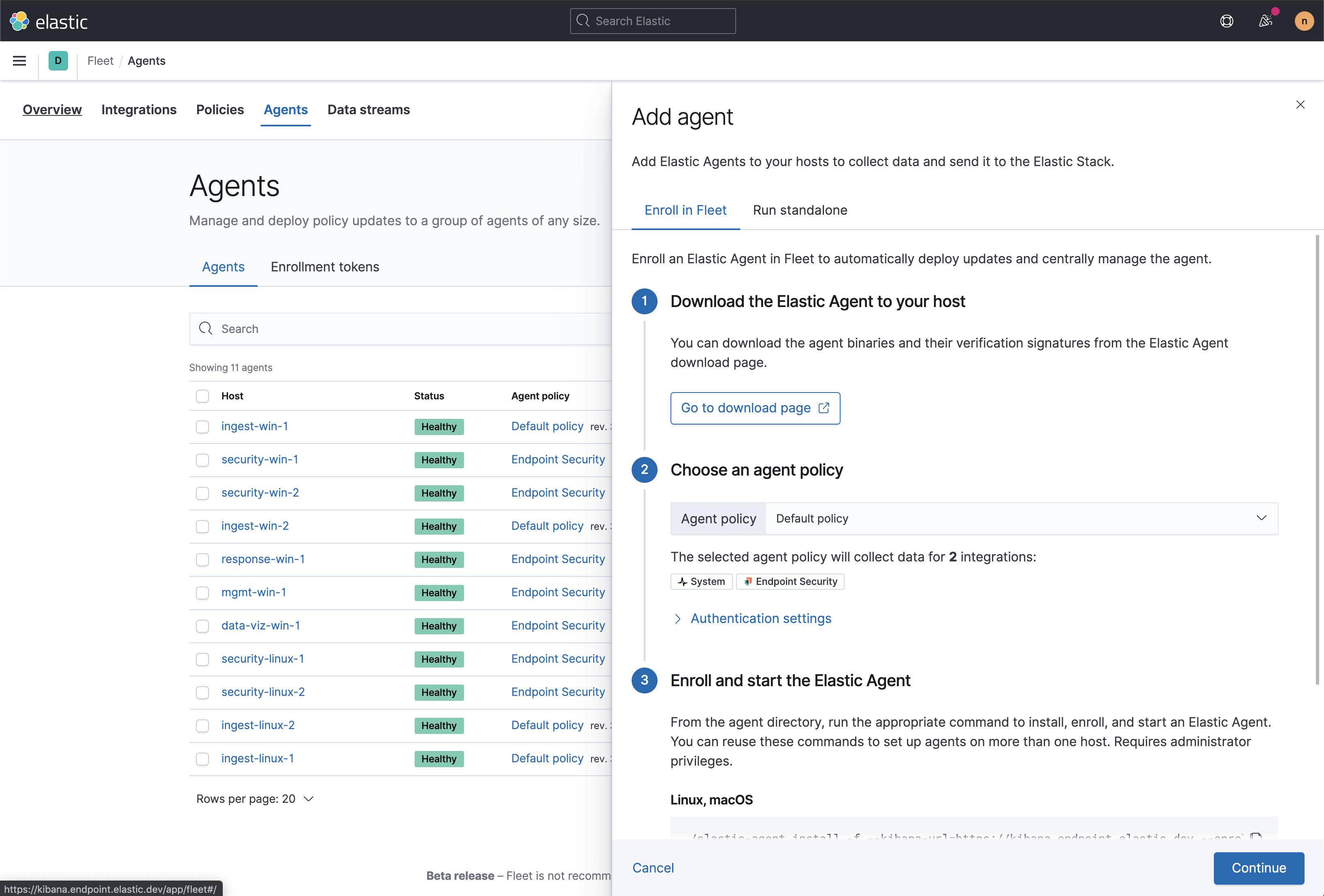

  1. Go to Fleet. Select Overview > Add agent.
    add agent
  2. In the Add agent pane of the Configurations section, download the Elastic Agent on your host’s machine.

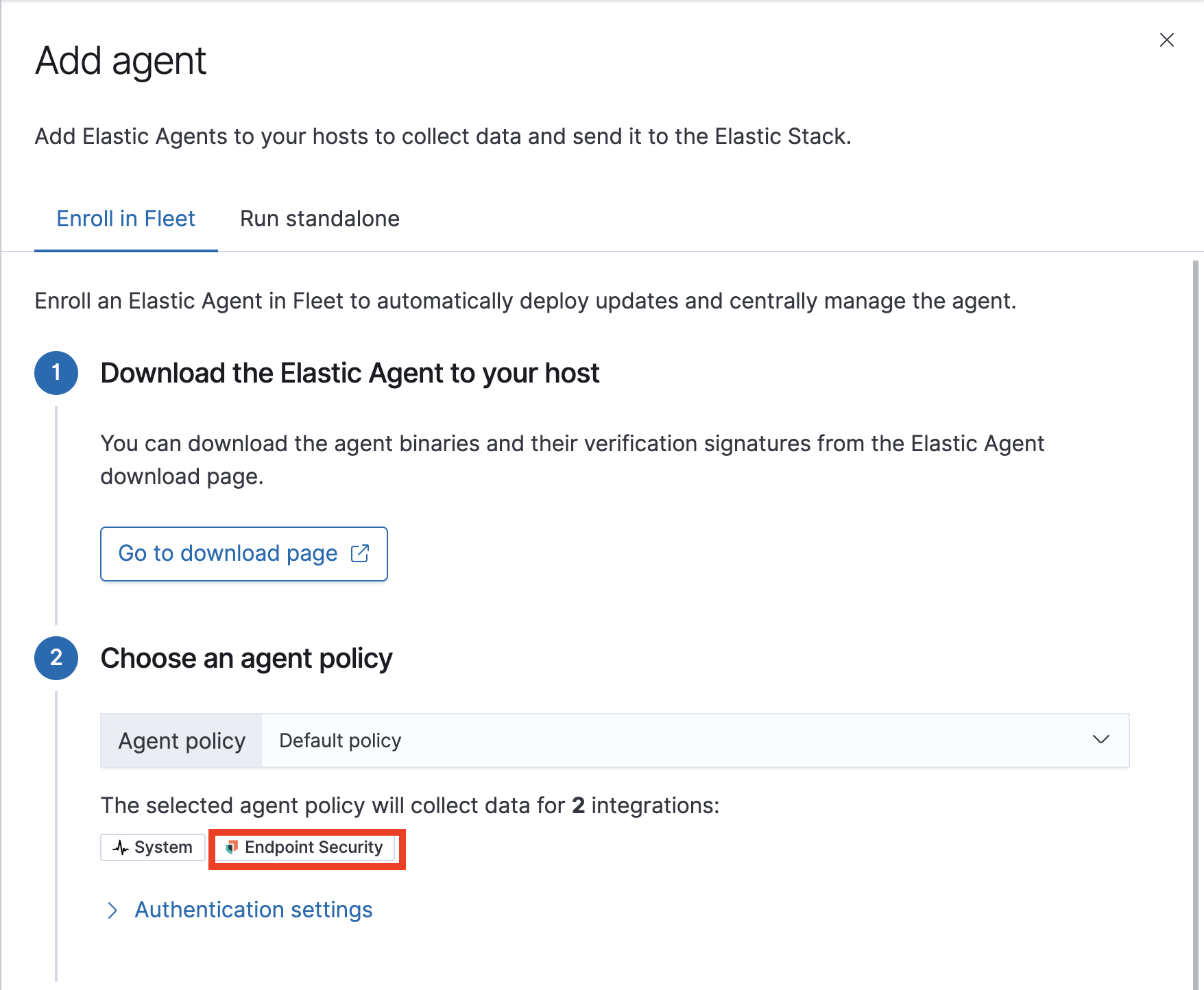

  3. After the download is complete, select an agent configuration. The selected integrations should include Endpoint Security.
    endpoint configuration
  4. After the Elastic Agent is installed on your host machine, open a command-line interface, and navigate to your Agent’s directory. Copy the commands from Fleet for your OS to enroll and run the Agent.
After you have enrolled the Elastic Agent on your host, select Continue. The host now appears in the Endpoints list, located on the Administration page in the Elastic Security app.

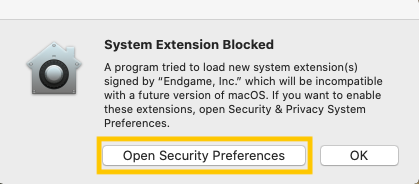

When running the Elastic Agent with endpoint integrated on macOS 10.13, 10.14 and 10.15, you will be prompted to approve a kernel extension from "Endgame, Inc". To approve the extension:
Endgame Sensor users can approve the kernel the same way for the Elastic Endgame app.
  1. Select Open Security Preferences. The Security and Privacy window opens.
    system extension

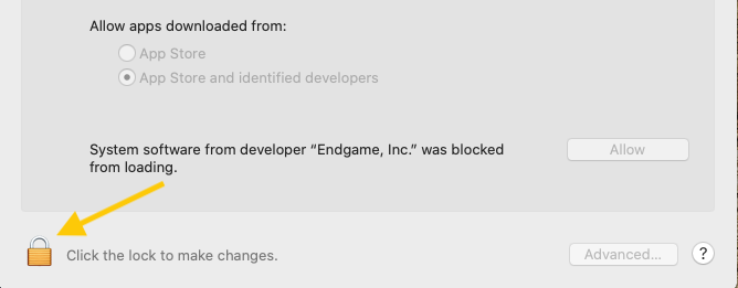

  2. Select the Lock icon at the bottom left of the window to make changes to your security settings.
    unlock security panel

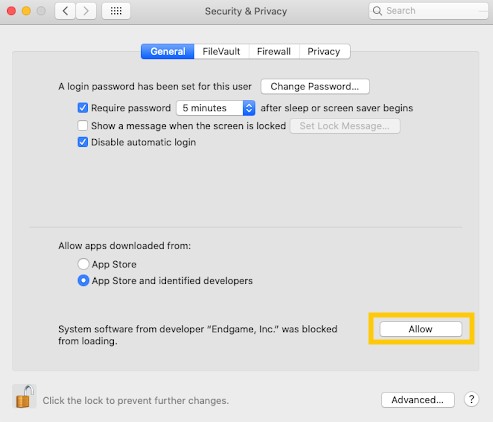

  3. Allow "Endgame, Inc" by selecting the Allow button.
    allow endgame
