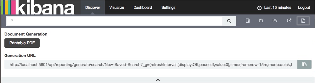

To verify your Reporting installation, point your web browser at
http://localhost:5601/
to open Kibana. The Generate Report button is added to the Toolbar:
