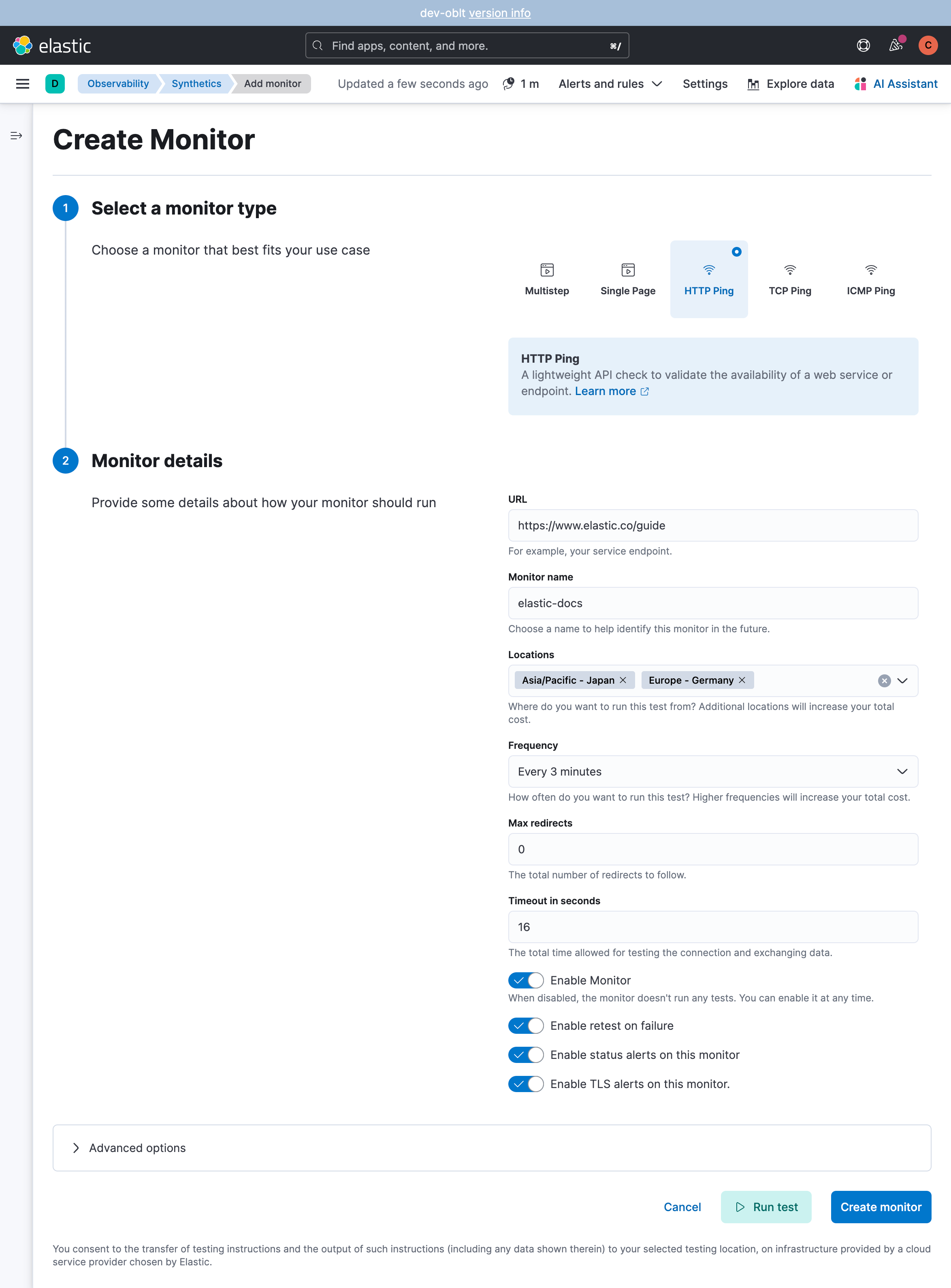

To use the UI to add a lightweight monitor:
Find
Syntheticsin the global search field.Click Create monitor.
Set the monitor type to HTTP, TCP, or ICMP pings.
In Locations, select one or more locations.
NoteIf you don’t see any locations listed, refer to the troubleshooting guide for guidance.
If you’ve added a Private Location, you’ll see the Private Location in the list of Locations.
Set the Frequency, and configure the monitor as needed.
Click Advanced options for more configuration options.
In Advanced options, select which Kibana spaces the monitor will be visible in. You can select multiple spaces or choose to make the monitor visible in all spaces. For an HTTP monitor, Advanced options → Authentication sets how the monitor signs in to the endpoint: None, Basic, Kerberos, or NTLM. A monitor can use one method at a time, and the fields change to match the one you select. For what each field holds and which locations support it, refer to the HTTP options. (Optional) Click Run test to verify that the test is valid.
NoteWhen you create or edit a monitor, default alert rules, including monitor status and TLS certificate rules, are automatically set up. You can review and manage these rules under Settings → Alerting in the Synthetics app.

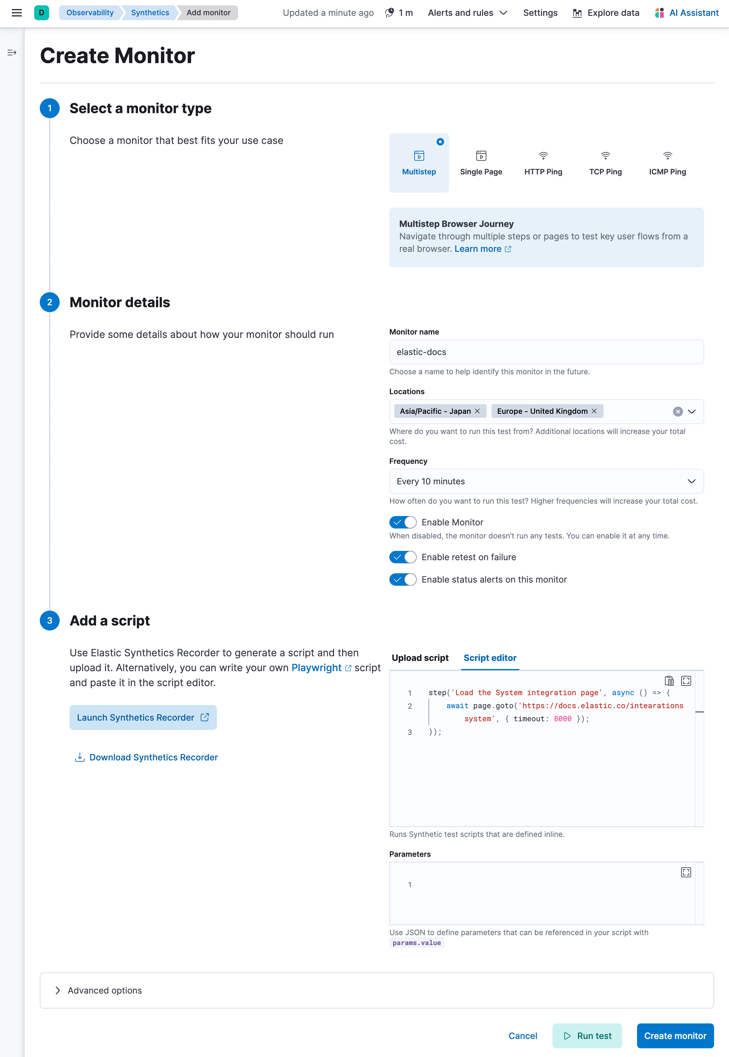

To use the UI to add a browser monitor:
Set the monitor type to Browser Journey or Multistep, depending on your Elastic Stack version.
Set the Frequency.
Add steps to the Script editor code block directly. The
journeykeyword isn’t required, and variables likepageandparamswill be part of your script’s scope. You cannotimportany dependencies when using inline browser monitors.NoteAlternatively, you can use the Script recorder option. You can use the Elastic Synthetics Recorder to interact with a web page, export journey code that reflects all the actions you took, and upload the results in the UI. For more information, refer to Use the Synthetics Recorder.
Click Advanced options to see more ways to configure your monitor.
- Use Data options to add context to the data coming from your monitors.
- Use Maintenance windows to prevent alerts from being triggered during scheduled downtime.
- Use the Synthetics agent options to provide fine-tuned configuration for the synthetics agent. Read more about available options in Use the Synthetics CLI.
Select which Kibana spaces the monitor will be visible in. You can select multiple spaces or choose to make the monitor visible in all spaces.
