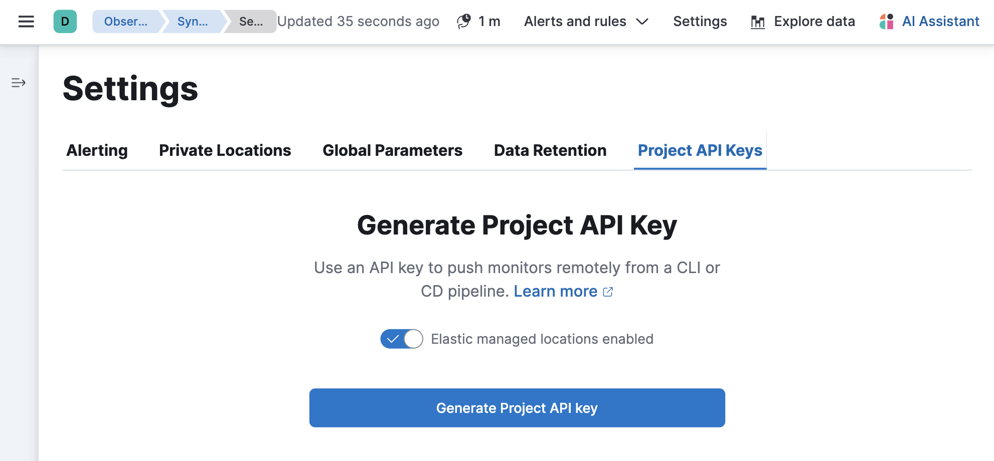

To generate an API key:
- Go to Synthetics in Kibana.
- Click Settings.
- Switch to the Project API Keys tab.
Click Generate Project API key.
To generate a Project API key, you must be logged in as a user with the privileges described in Writer role.

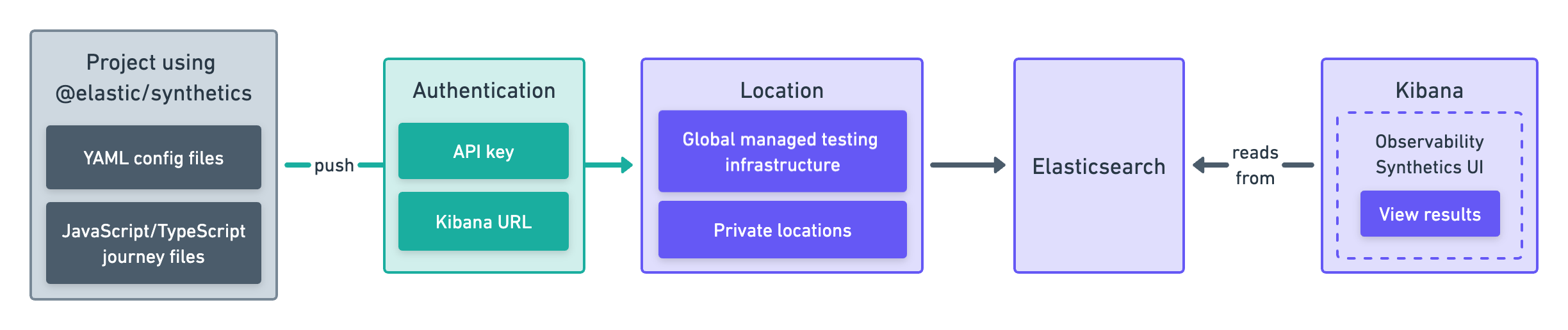

Push all monitor configurations to an Elastic deployment. Run the following command from inside your project:
npx @elastic/synthetics push --auth $SYNTHETICS_API_KEY --url <kibana-url>
One monitor will appear in the Synthetics app for each journey or
lightweight monitor, and you’ll manage all monitors from your local environment.
