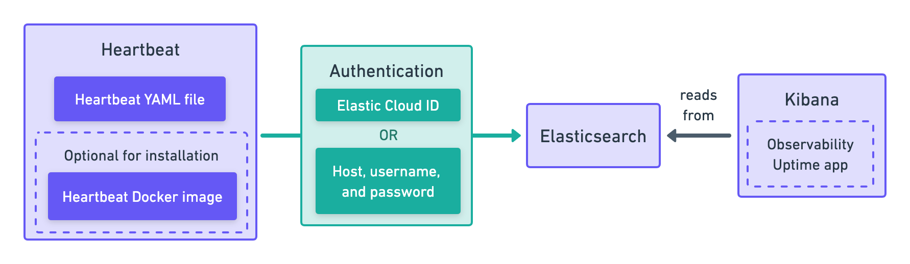

Diagram showing which pieces of software are used to configure monitors

Connect to the Elastic Stackedit
After configuring the monitor, run it in Docker and connect the monitor to the Elastic Stack.
You’ll need to retrieve your Elasticsearch credentials for either an Elastic Cloud ID or another Elasticsearch Cluster.
The example below, shows how to run synthetics tests indexing data into Elasticsearch. You’ll need to insert your actual cloud.id and cloud.auth values to successfully index data to your cluster.

View in Kibanaedit
Heartbeat is now sending synthetic monitoring data to the Elastic Stack. Navigate to the Uptime app in Kibana, where you can see screenshots of each run, set up alerts in case of test failures, and more.
