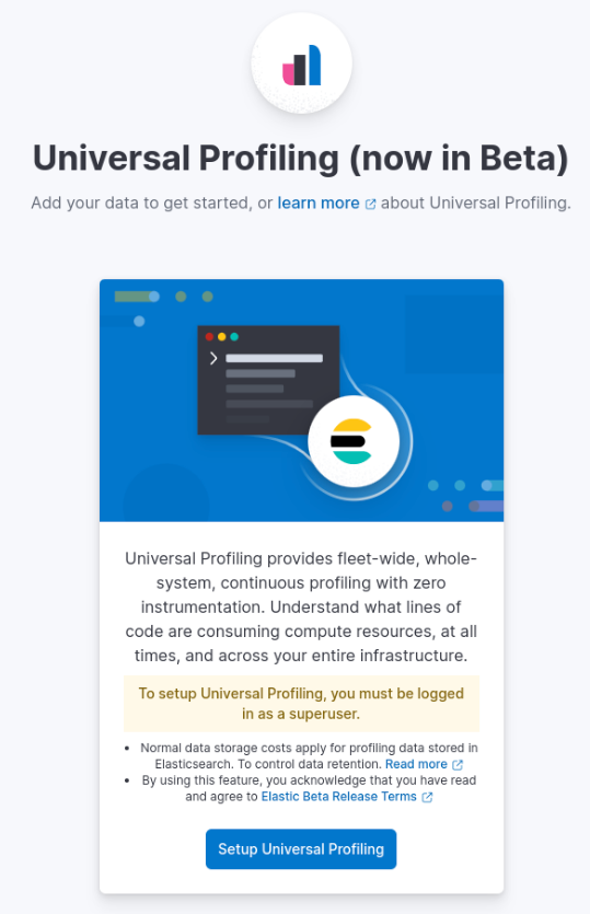

After enabling Universal Profiling on your deployment for the first time, select any subheading under Universal Profiling in the navigation menu to open the following page:
profiling setup popup
Click Set up Universal Profiling to configure data ingestion.
To configure data ingestion, you need elevated privileges, typically the elastic user.

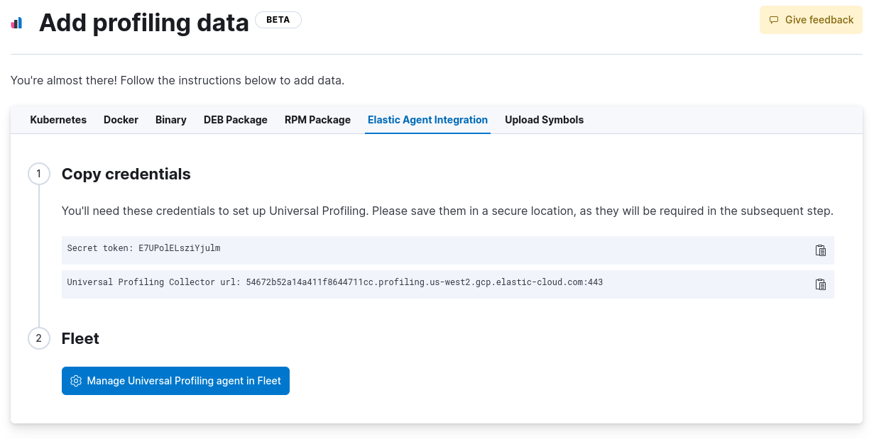

To install the host-agent using the Elastic Agent and the Universal Profiling Agent integration, complete the following steps:
  1. Copy the secret token and Universal Profiling Collector url from the Elastic Agent Integration
    profiling elastic agent
  2. Click Manage Universal Profiling Agent in Fleet to complete the integration.
  3. On the Integrations page, click Add Universal Profiling Agent.

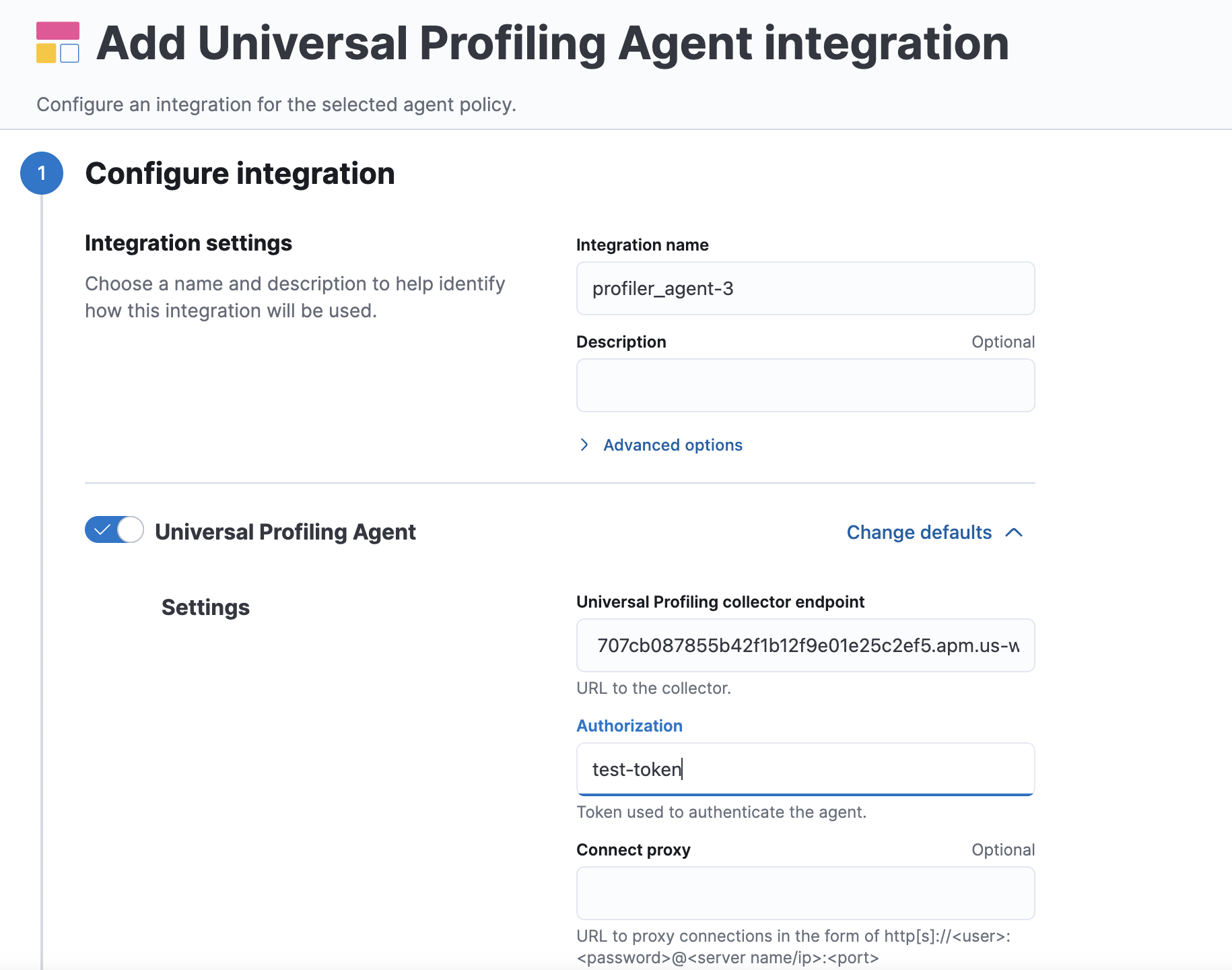

  4. In Universal Profiling Agent → Settings, add the information you copied from the Add profiling data page:
    1. Add the Universal Profiling collector URL to the Universal Profiling collector endpoint field.
    2. Add the secret token to the Authorization field.
      profililing elastic agent creds
  5. Click Save and continue.

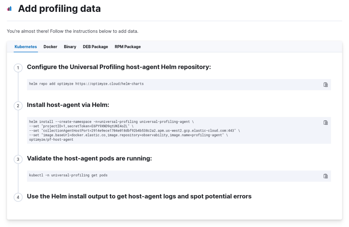

The host-agent profiles your fleet. You need to install and configure it on every machine that you want to profile. The host-agent needs root / CAP_SYS_ADMIN privileges to run.
After clicking Set up Universal Profiling in the previous step, you’ll see the instructions for installing the host-agent. You can also find these instructions by clicking the Add data button in the top-right corner of the page.
The following is an example of the provided instructions for Kubernetes:
profiling k8s hostagent
