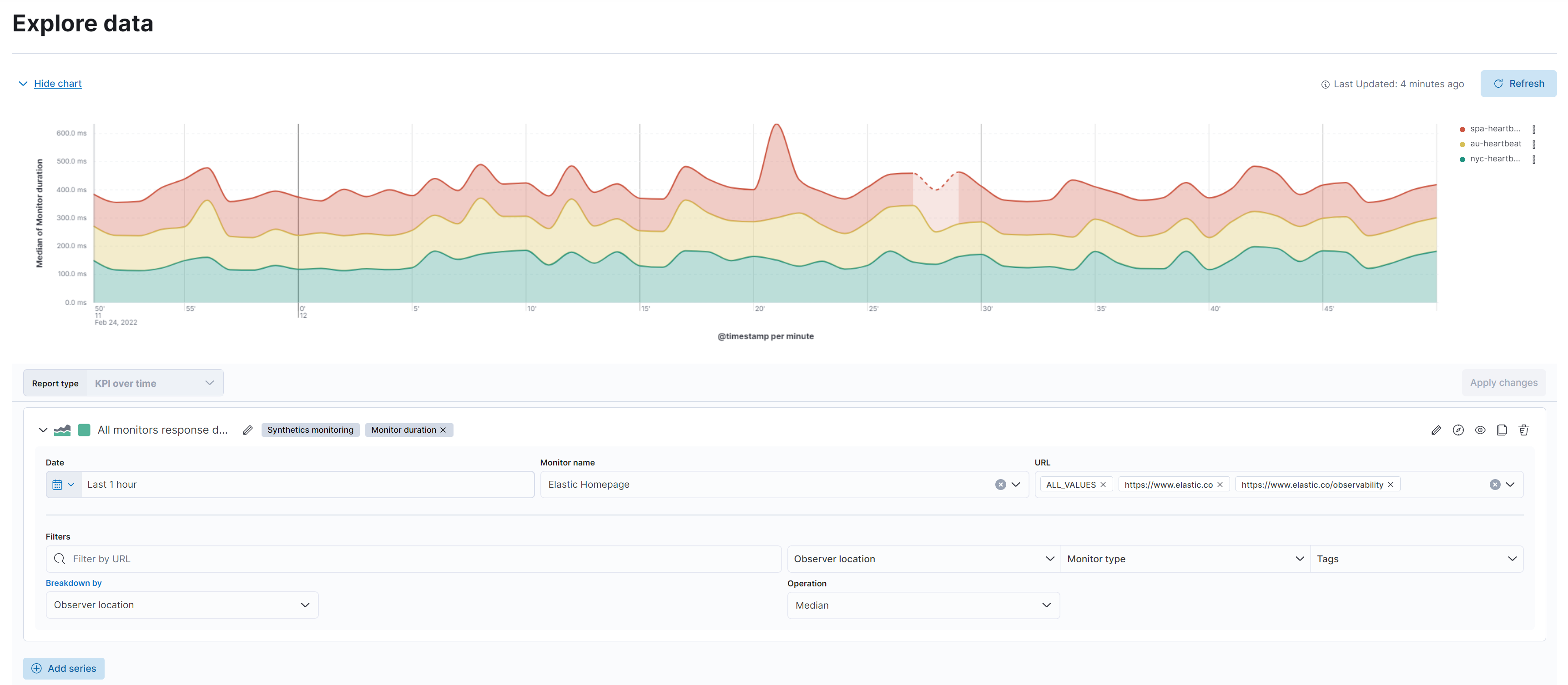

Based on the Uptime data you are sending to your deployment, you can create various visualizations relating to monitor durations, pings over time, or any of the available data types.
Explore data for Uptime
Monitor duration
The Uptime monitor duration time-series chart displays the timing for each check that Heartbeat performed.
This visualization helps you to gain insights into how quickly requests resolve by the targeted endpoint and give you a sense of how frequently a host or endpoint was down in your selected time span.

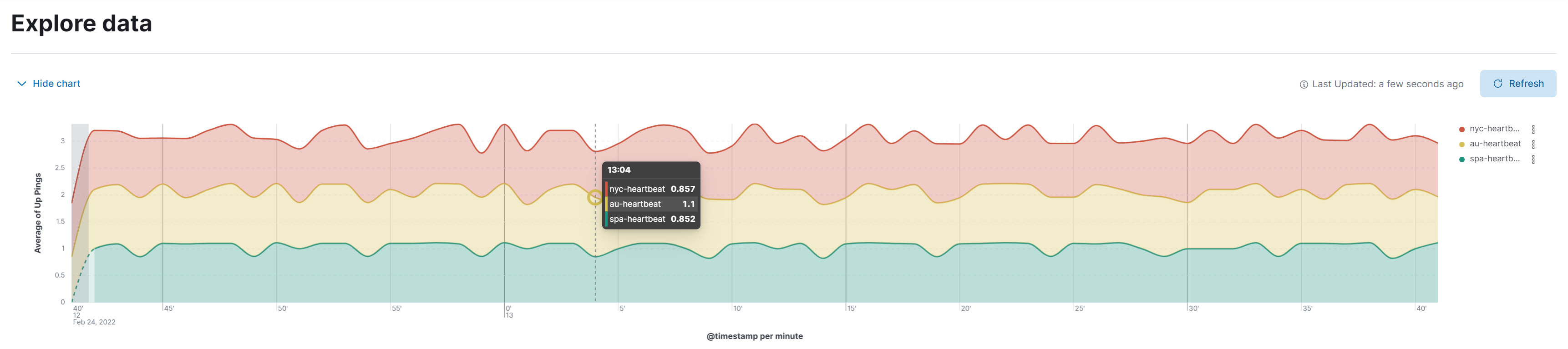

Pings histogram
The Uptime pings chart is a graphical representation of the check statuses over time.

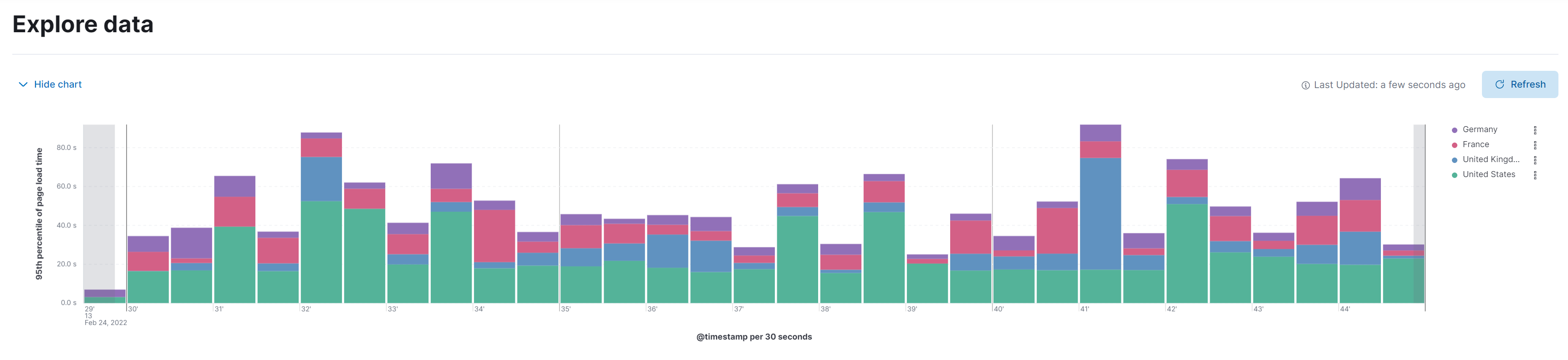

Based on the User Experience data from your instrumented applications, you can create detailed visualizations for performance distributions, key performance indicators (KPI) over time, and for core web vitals of your web applications.
Explore data for User Experience (page load time)
KPI over time
The KPI over time histogram represents the performance indicators based on the metric you select.
By default, the Page views metric is selected.
Performance distribution
The Performance distribution time-series chart enables you to examine the perceived performance of your web applications based on the metric you select.
By default, the Page load time metric is selected.
Core web vitals
The Core web vitals chart is a graphical representation of key metrics, such as load performance, load responsiveness, and visual stability, for each of your web applications.
By default, the Largest contentful paint metric is selected. Hover over the chart to display crosshairs with performance indicators for each web application: poor, average, and good.
