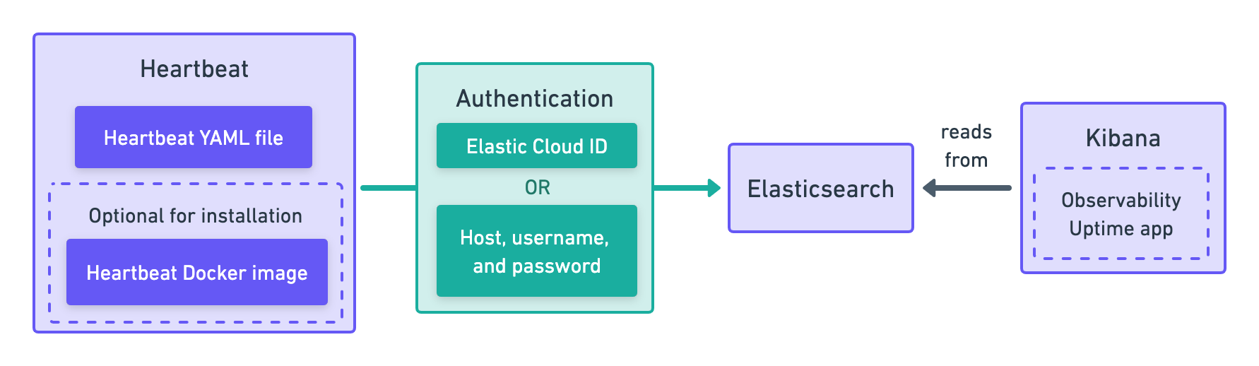

Connect to the Elastic Stack
editAfter configuring the monitor, run it in Docker and connect the monitor to the Elastic Stack.
You’ll need to retrieve your Elasticsearch credentials for either an Elastic Cloud ID or another Elasticsearch Cluster.
The example below, shows how to run synthetics tests indexing data into Elasticsearch.
You’ll need to insert your actual cloud.id and cloud.auth values to successfully index data to your cluster.

If you aren’t using Elastic Cloud, replace -E cloud.id and -E cloud.auth with your Elasticsearch hosts,
username, and password:
docker run \ --rm \ --name=heartbeat \ --user=heartbeat \ --volume="$PWD/heartbeat.yml:/usr/share/heartbeat/heartbeat.yml:ro" \ --cap-add=NET_RAW \ docker.elastic.co/beats/heartbeat:8.7.1 heartbeat -e \ -E output.elasticsearch.hosts=["localhost:9200"] \ -E output.elasticsearch.username=elastic \ -E output.elasticsearch.password=changeme
