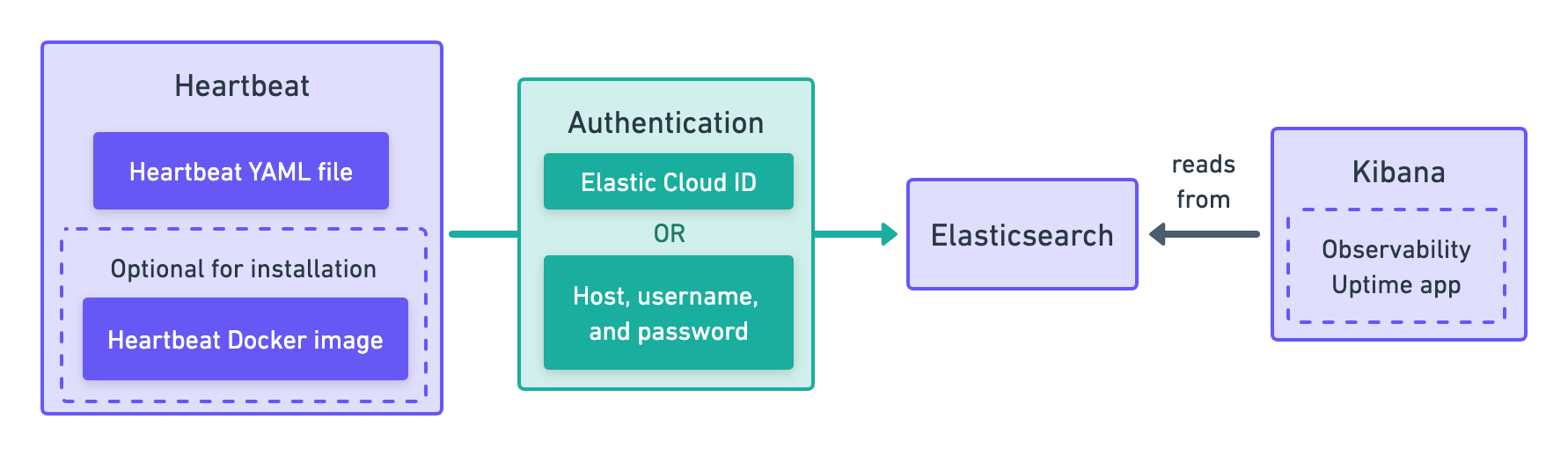

Heartbeatedit
Heartbeat is a lightweight daemon that you install on a remote server to periodically check the status of your services and determine if they are available. Performance data is then gathered and reported back to Heartbeat, where it’s formatted and sent to the Elastic Stack.
This approach is only recommended for lightweight checks, and works well for system administrators wanting to configure lightweight monitors using YAML files. You should not use this approach to create browser monitors. If you want to create browser monitors, use Project Monitors or the Uptime app instead.
Get started in Use Heartbeat.
synthetics get started heartbeat

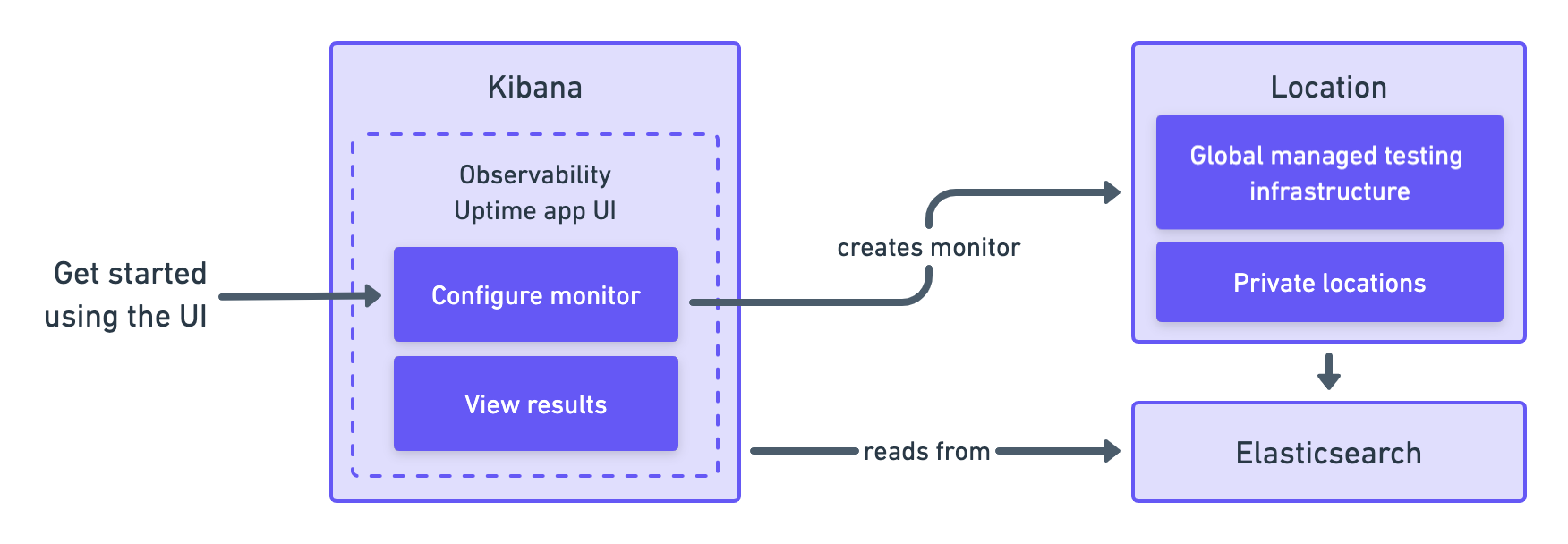

Uptime appedit
The Uptime app is an application in Kibana. You can create monitors directly in the Uptime app using the user interface. To try out this beta functionality, you will need to enable Monitor Management.
This approach works well if you want to configure and update monitors using a UI in your browser. However, this functionality is in beta and is subject to change.
Get started in Use the Uptime app.
synthetics get started ui
