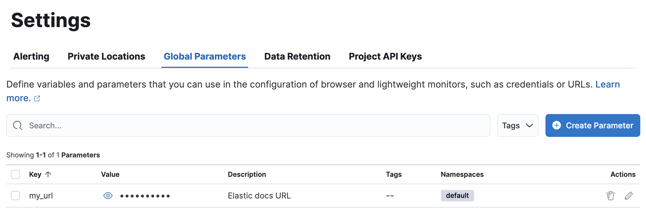

Global parameters in Kibana
In the Synthetics app:
  1. Go to Settings.
  2. Go to the Global parameters tab.
  3. Define parameters.
Global parameters tab on the Synthetics Settings page in Kibana

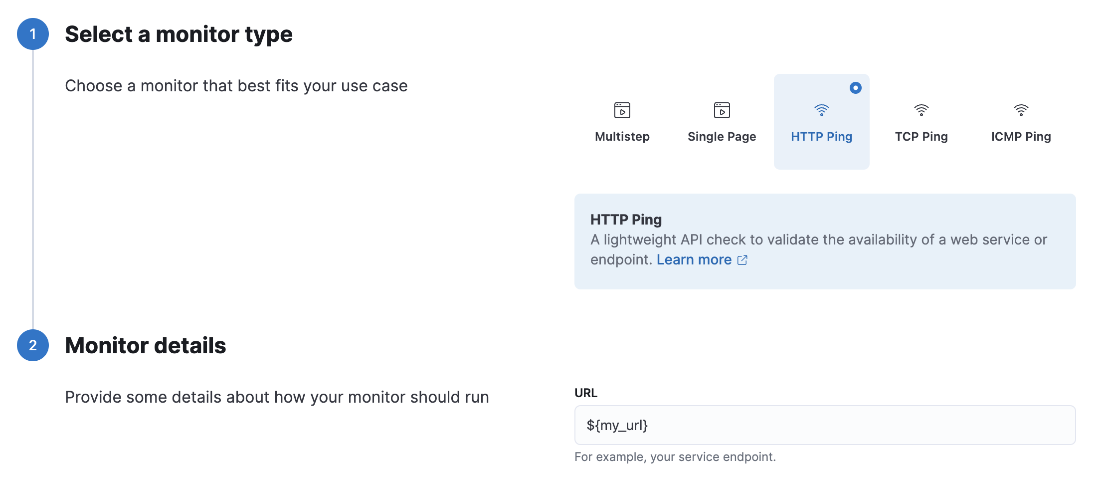

To use a param in a lightweight monitor that is created in the Synthetics UI, wrap the name of the param in ${} (for example, ${my_url}).
Use a param in a lightweight monitor created in the Synthetics UI

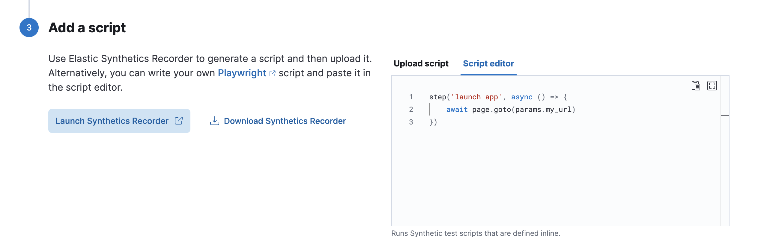

To use a param in a browser monitor that is created in the Synthetics UI, add params. before the name of the param (for example, params.my_url).
Use a param in a browser monitor created in the Synthetics UI
