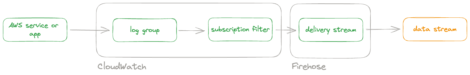

Monitor CloudWatch logs
In this section, you’ll learn how to export log events from CloudWatch logs to an Elastic cluster by using Amazon Data Firehose.
You’ll go through the following steps:
  • Install AWS integration in Kibana
  • Select a CloudWatch log group to monitor
  • Create a delivery stream in Amazon Data Firehose
  • Set up a subscription filter to forward the logs using the Firehose stream
  • Visualize your logs in Kibana

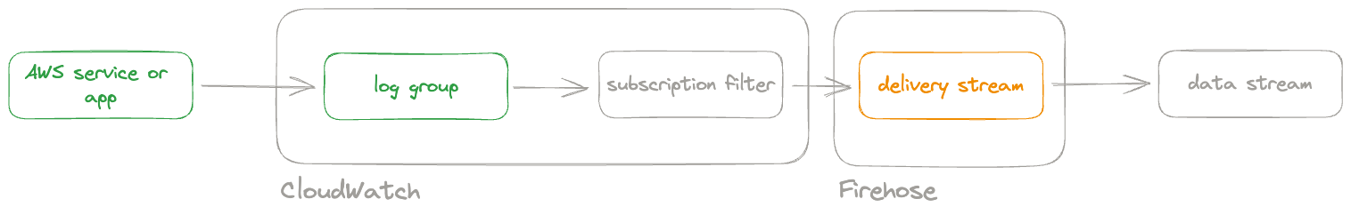

Step 3: Create a stream in Amazon Data Firehose
Amazon Firehose Stream
  1. Go to the AWS console and navigate to Amazon Data Firehose.
  2. Click Create Firehose stream and choose the source and destination of your Firehose stream. Unless you are streaming data from Kinesis Data Streams, set source to Direct PUT and destination to Elastic.
  3. Provide a meaningful Firehose stream name that will allow you to identify this delivery stream later.
    For advanced use cases, source records can be transformed by invoking a custom Lambda function. When using Elastic integrations, this should not be required.
  4. From the Destination settings panel, specify the following settings:
    • To find the Elasticsearch endpoint URL:
      1. Go to the Elastic Cloud console
      2. Find your deployment in the Hosted deployments card and select Manage.
      3. Under Applications click Copy endpoint next to Elasticsearch.
      4. Make sure that your Elasticsearch endpoint URL includes .es. between the deployment name and region. Example: https://<deployment_name>.es.<region>.<csp>.elastic-cloud.com
    • To create the API key:
      2. Select Open Kibana.
      3. Expand the left-hand menu, under Management select Stack management > API Keys and click Create API key. If you are using an API key with Restrict privileges, make sure to review the Indices privileges to provide at least auto_configure and write permissions for the indices you will be using with this delivery stream.
    • Content encoding: To reduce the data transfer costs, use GZIP encoding.
    • Retry duration: Determines how long Firehose continues retrying the request in the event of an error. A duration between 60 and 300 seconds should be suitable for most use cases.
  5. It is recommended to configure S3 backup for failed records from the Backup settings panel. These backups can be used to restore data losses caused by unforeseen service outages.
The Firehose stream is now ready to send logs to your Elastic Cloud deployment.
Step 4: Send Lambda function log events to a Firehose stream
CloudWatch subscription filter
To send log events from CloudWatch to Firehose, open the log group where the Lambda service is logging and create a subscription filter.
Create a subscription filter for Amazon Data Firehose
The subscription filter allows you to pick log events from the log group and forward them to other services, such as an Amazon Kinesis stream, an Amazon Data Firehose stream, or AWS Lambda.
  1. On the log group page, select Subscription filters and click the Create Amazon Data Firehose subscription filter button.

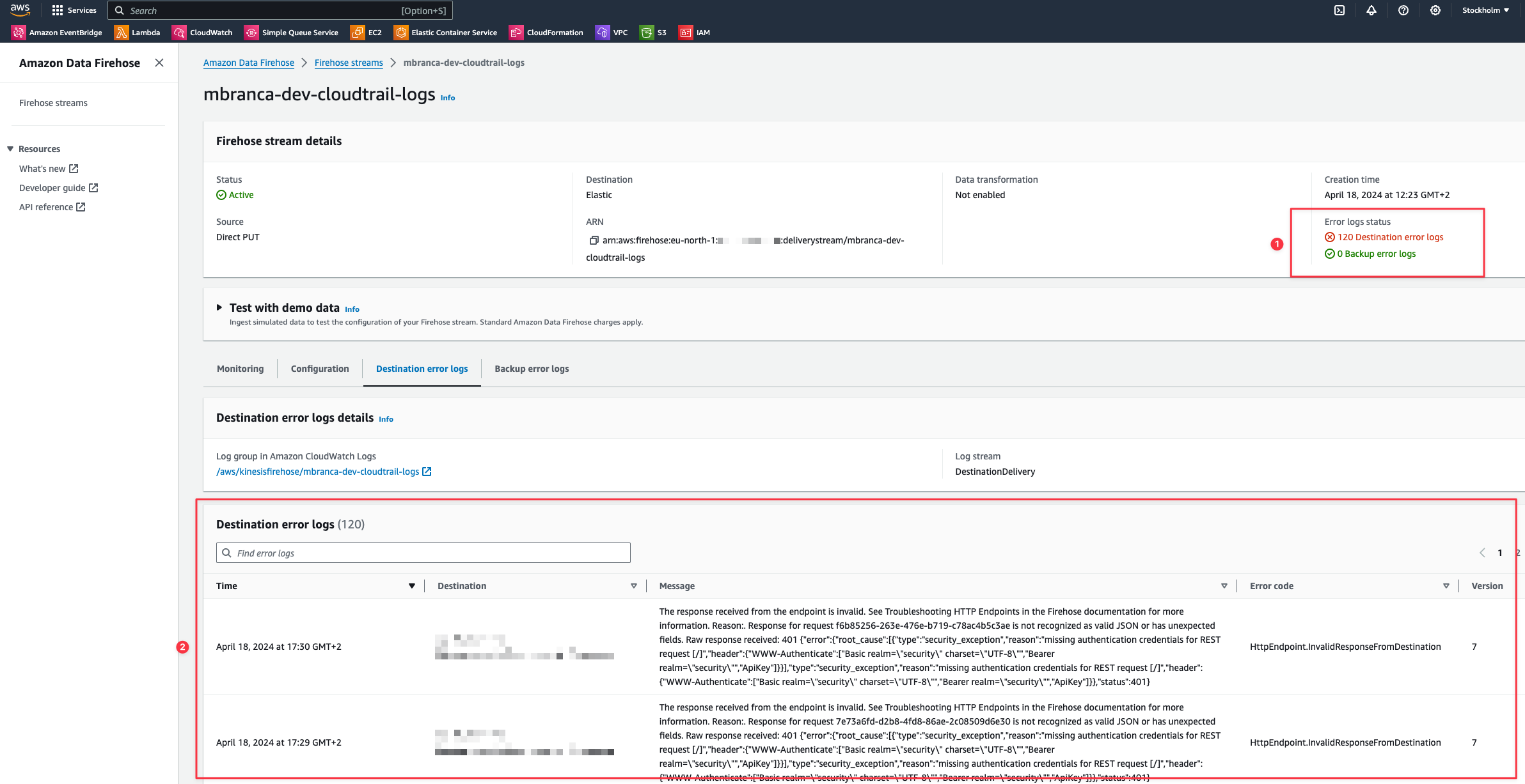

Check if there are destination error logs
On the AWS console, navigate to your Firehose stream and check for entries in the Destination error logs section.
If everything is running smoothly, this list is empty. If there’s an error, you can check the details. The following example shows a delivery stream that fails to send records to the Elastic stack due to bad authentication settings:
Firehose destination errors
The Firehose delivery stream reports:
  • The number of failed deliveries.
  • The failure detail.
