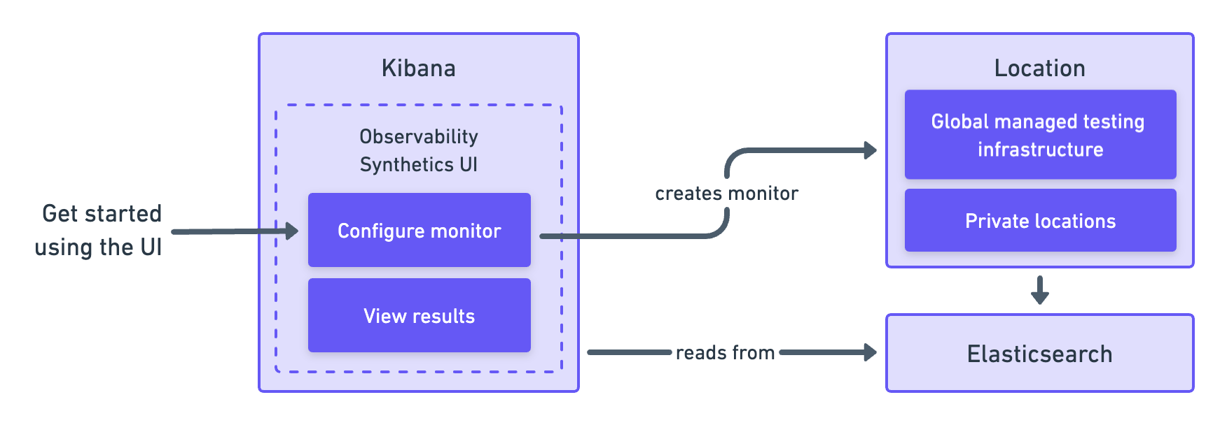

You can create synthetic monitors directly in the Synthetics app in Kibana.
![Diagram showing which pieces of software are used to configure monitors](images/synthetics-get-started-ui.png)
This is one of two approaches you can use to set up a synthetic monitor.

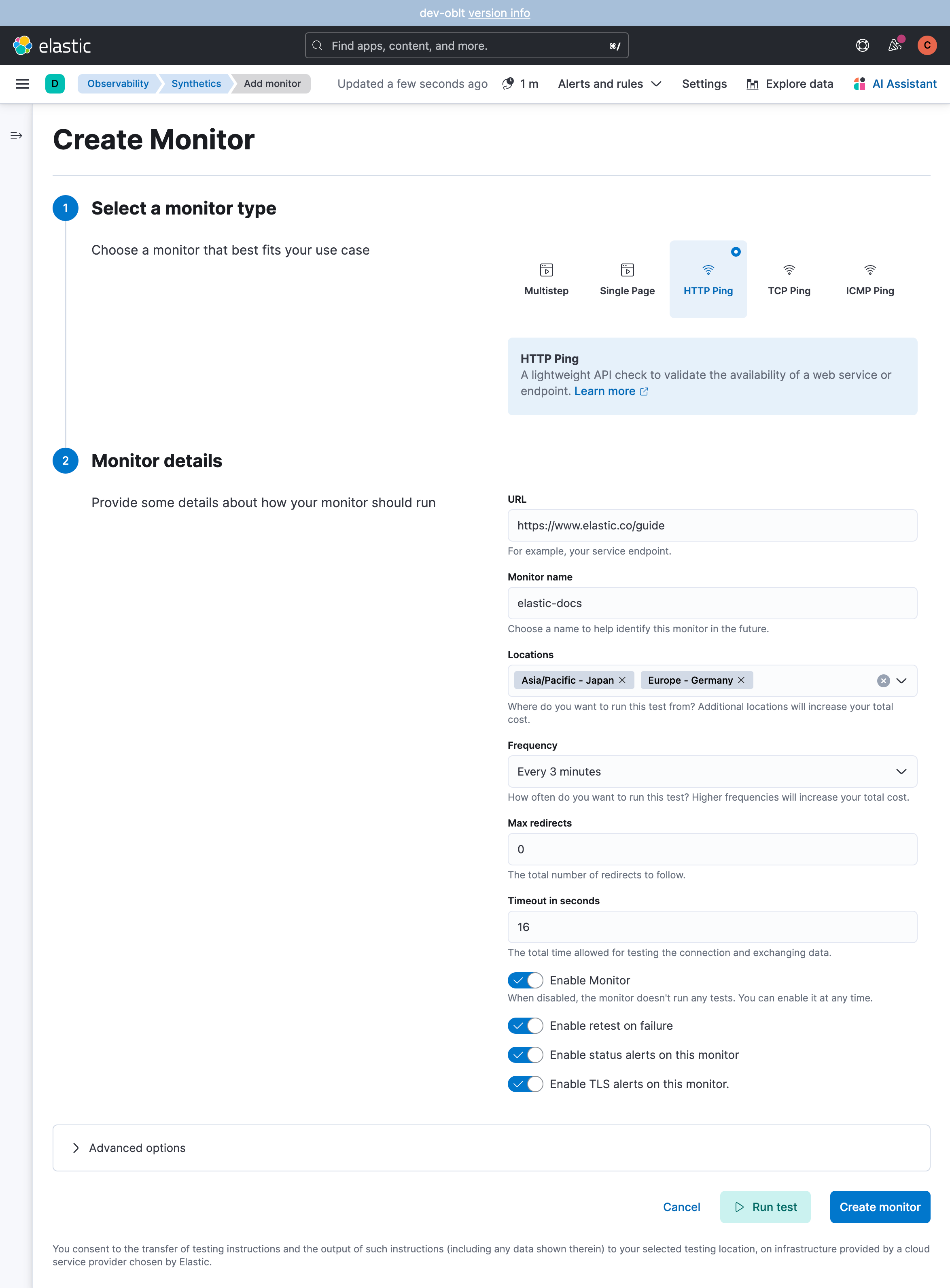

To use the Synthetics app to add a lightweight monitor:
- Go to Synthetics in Kibana.
- Click Create monitor.
- Set the monitor type to HTTP Ping, TCP Ping, or ICMP Ping.

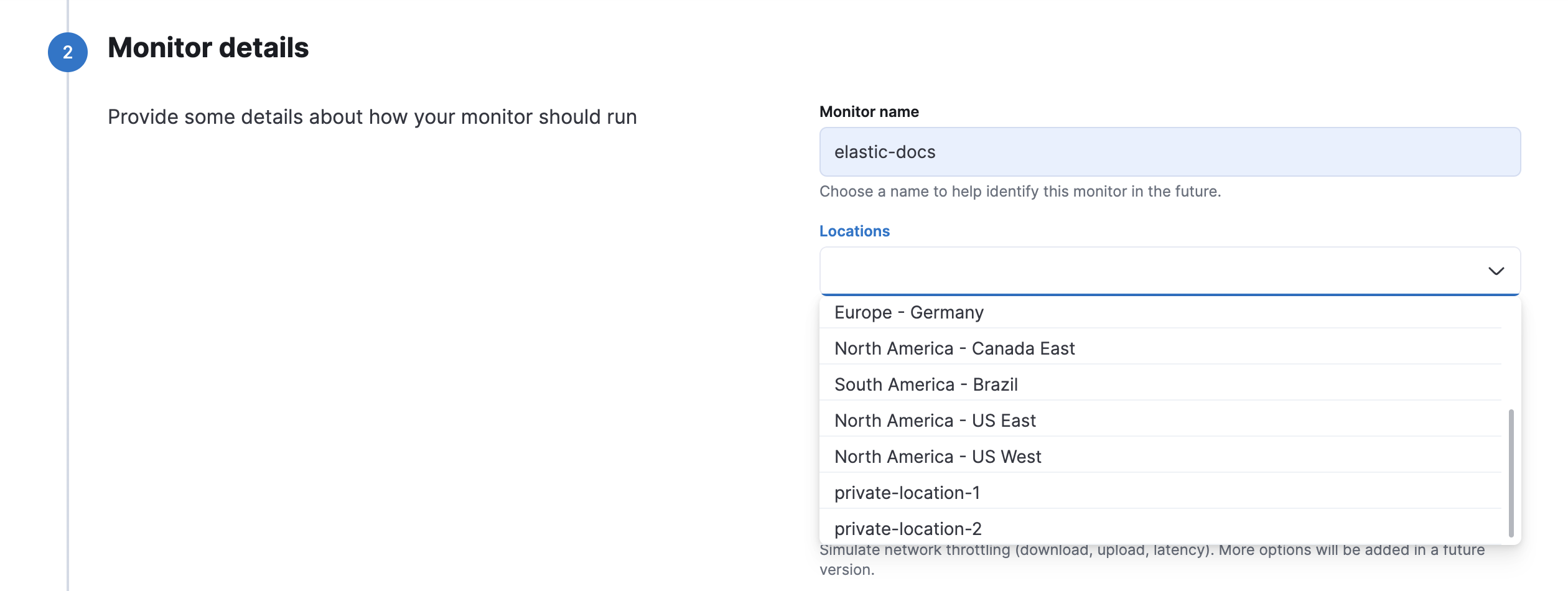

In Locations, select one or more locations.
If you don’t see any locations listed, refer to the troubleshooting guide for guidance.
- Set the Frequency, and configure the monitor as needed.
- Click Advanced options to see more ways to configure your monitor.
- (Optional) Click Run test to verify that the test is valid.
If you’ve added a Private Location, you’ll see your new Private Location in the list of Locations.

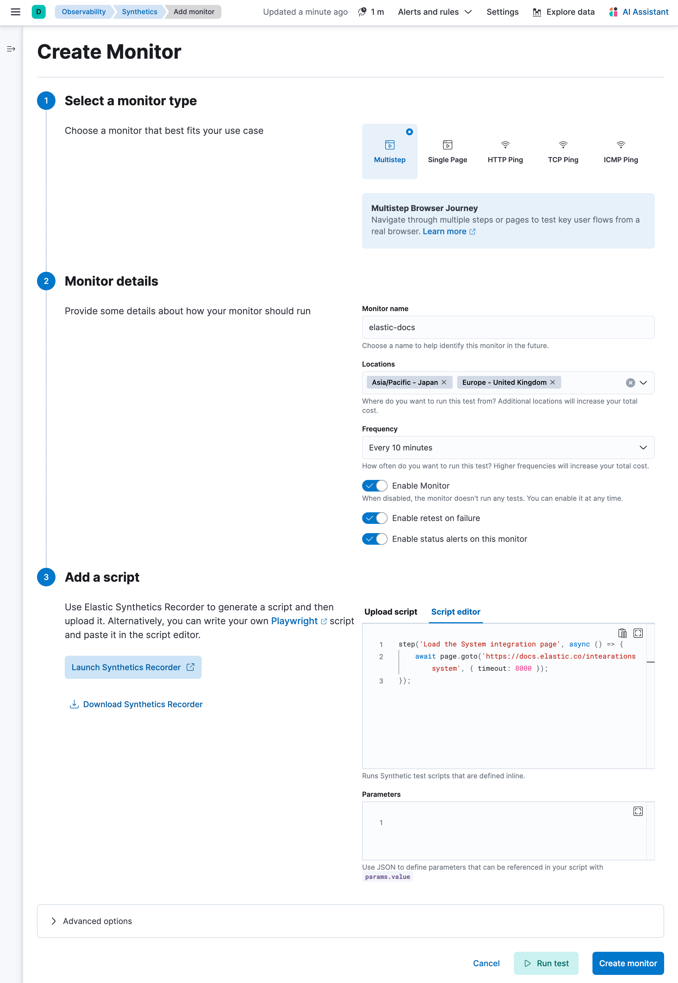

- Set the monitor type to Multistep.
- Set the Frequency.
Add steps to the Script editor code block directly. The
journey
keyword isn’t required, and variables likepage
andparams
will be part of your script’s scope. You cannotimport
any dependencies when using inline browser monitors.Alternatively, you can use the Script recorder option. You can use the Elastic Synthetics Recorder to interact with a web page, export journey code that reflects all the actions you took, and upload the results to Synthetics app. For more information, refer to Use the Synthetics Recorder.
- Use Data options to add context to the data coming from your monitors.
- Use the Synthetics agent options to provide fine-tuned configuration for the synthetics agent. Read more about available options in Use the CLI.
