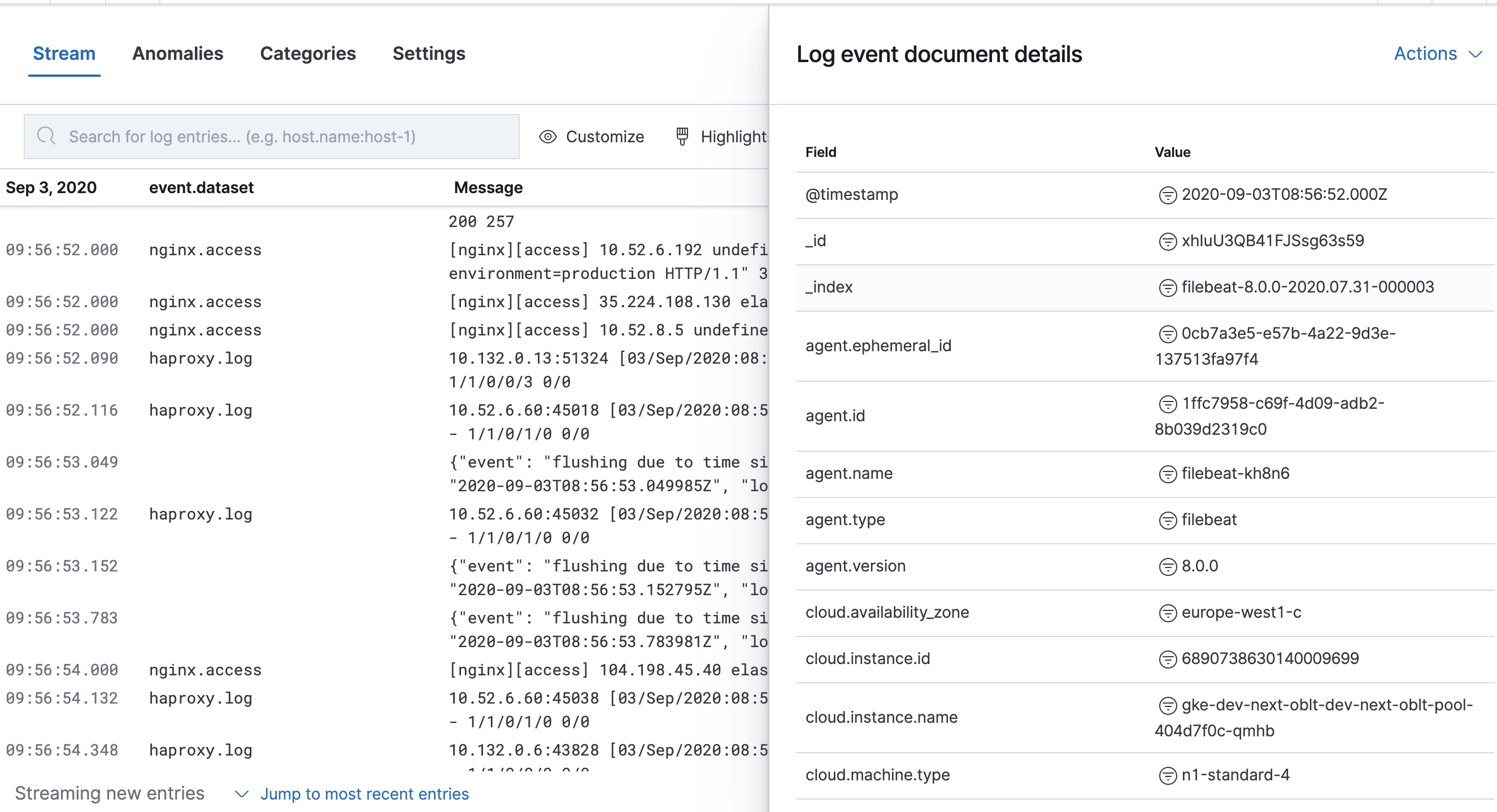

Inspect log event details
editWhen you have searched and filtered your logs for a specific log event, you may want to examine the metadata and the structured fields associated with that event. To view the Log event document details fly-out, hover over the log event, click View actions for line, and then select View details. To further enhance the workflow of monitoring logs, the icons next to each field value enable you to filter the logs per that value.

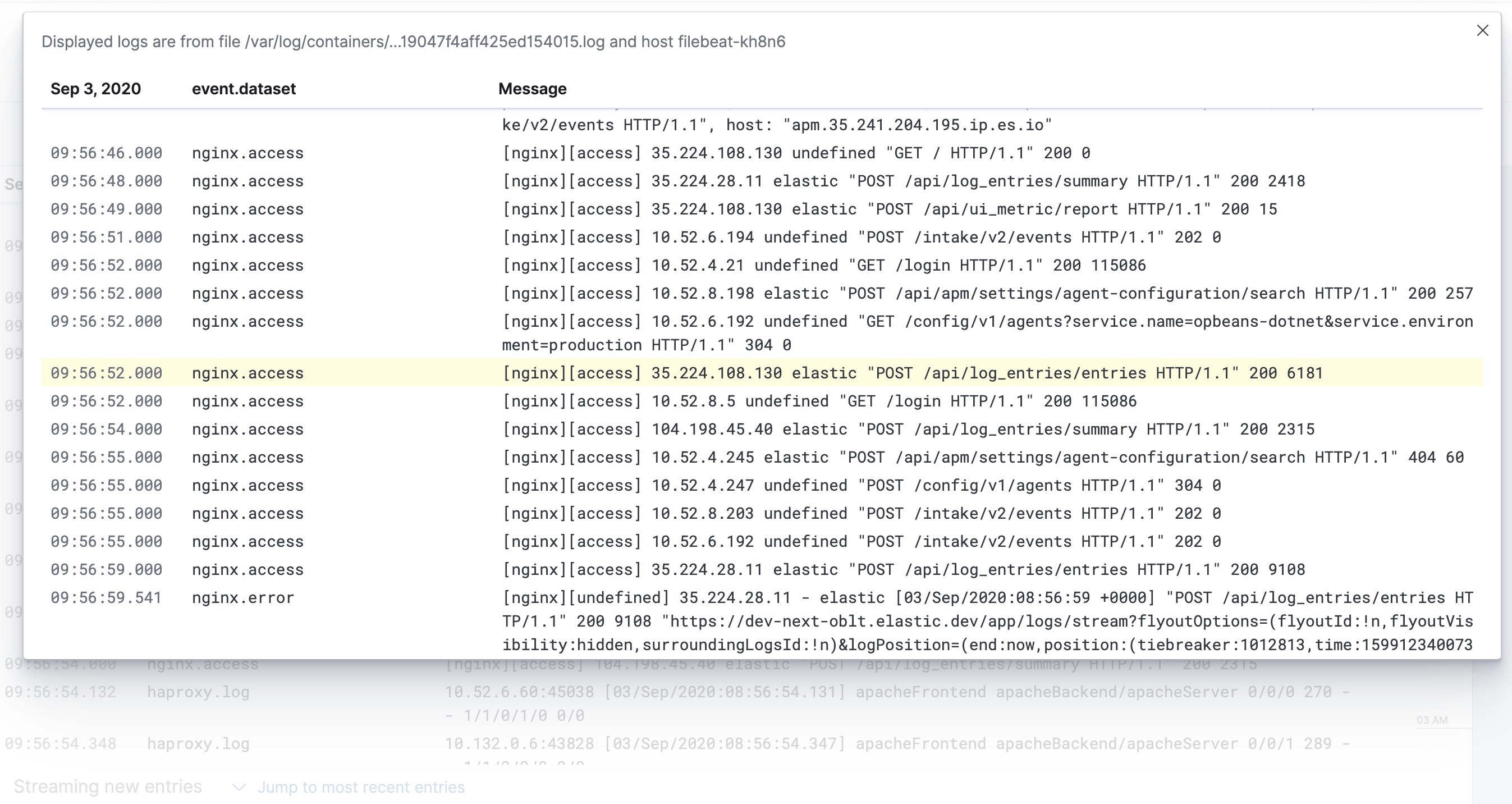

View contextual logs
editOnce your logs are filtered, and you find an interesting log line, the real context you are looking for is
what happened before and after that log line within that data source. For example, you are running
containerized applications on a Kubernetes cluster, you filter the logs for the term error, and you find an
interesting error log line. The context you want is what happened before and after the error line within the
logs of this container and application.
Hover over the log event, click View actions for line, and then select View in context. The context is preserved and helps you find the root cause as soon as possible.
