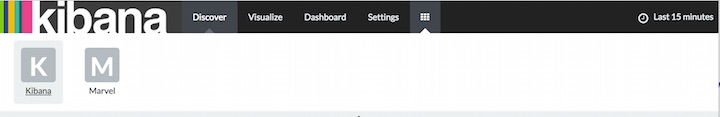

To verify your Marvel installation, point your web browser at your Kibana host, click the App Switcher icon in the Kibana menu bar, and select Marvel.
Marvel should display a list of the clusters you are monitoring.
