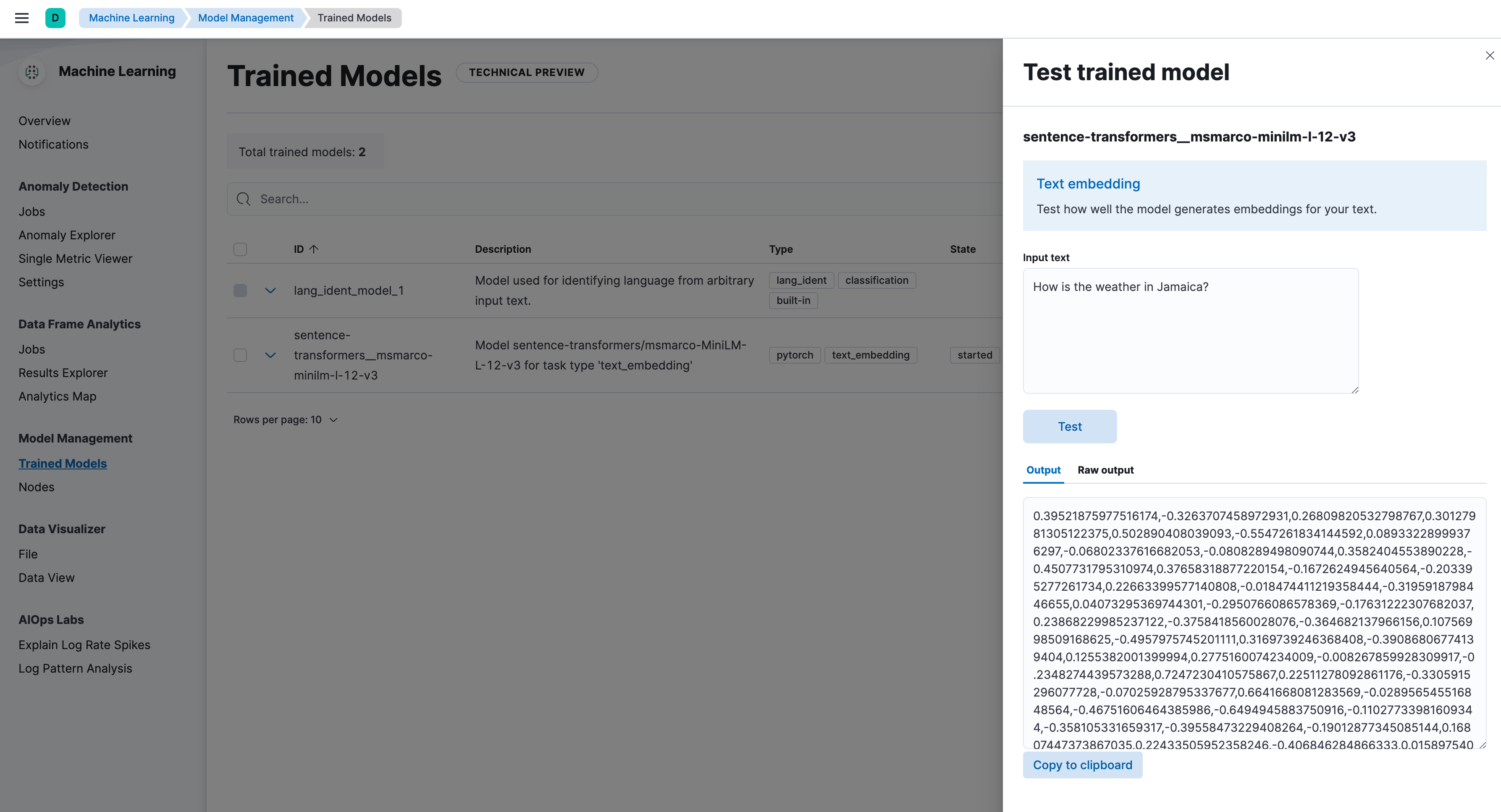

Test the text embedding model
editDeployed models can be evaluated in Kibana under Machine Learning > Trained Models by selecting the Test model action for the respective model.

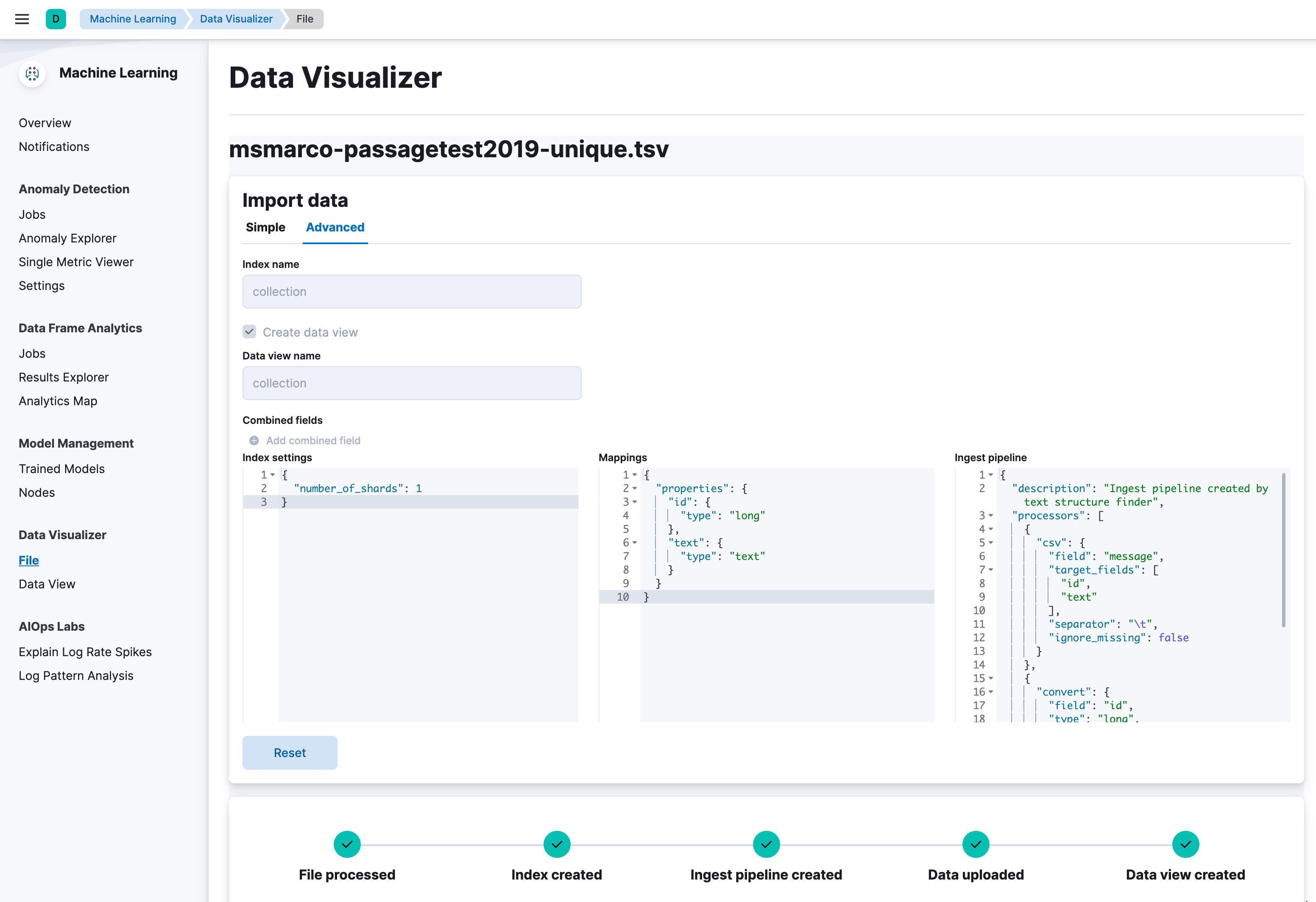

Upload the file by using the
Data Visualizer.
Name the first column id and the second one text. The index name is
collection. After the upload is done, you can see an index named collection
with 182469 documents.

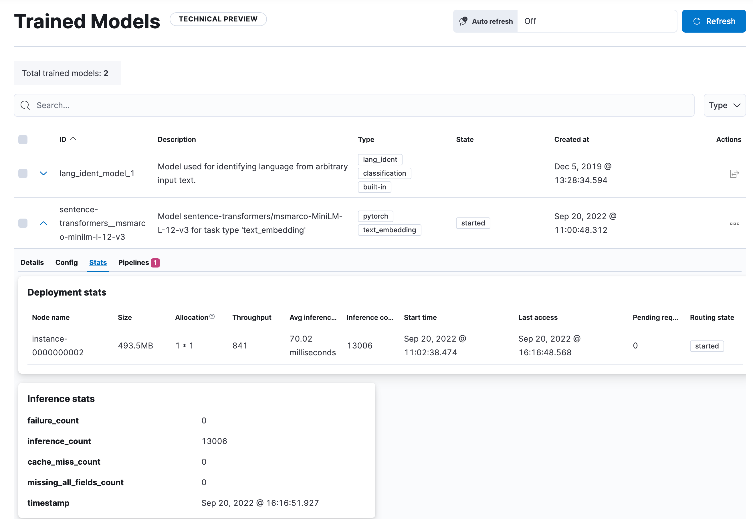

The default batch size for reindexing is 1000. Reducing |
The API call returns a task ID that can be used to monitor the progress:
GET _tasks/<task_id>
You can also open the model stat UI to follow the progress.
After the reindexing is finished, the documents in the new index contain the inference results – the vector embeddings.
