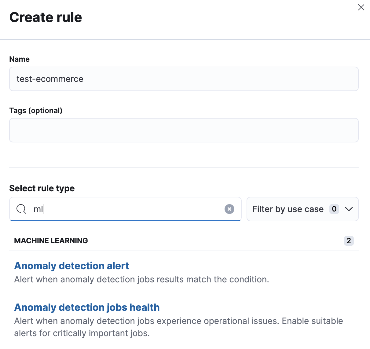

In Stack Management > Rules, you can create both types of machine learning rules:
![Creating a new machine learning rule](images/ml-rule.png)
In the Machine Learning app, you can create only anomaly detection alert rules; create them from the anomaly detection job wizard after you start the job or from the anomaly detection job list.

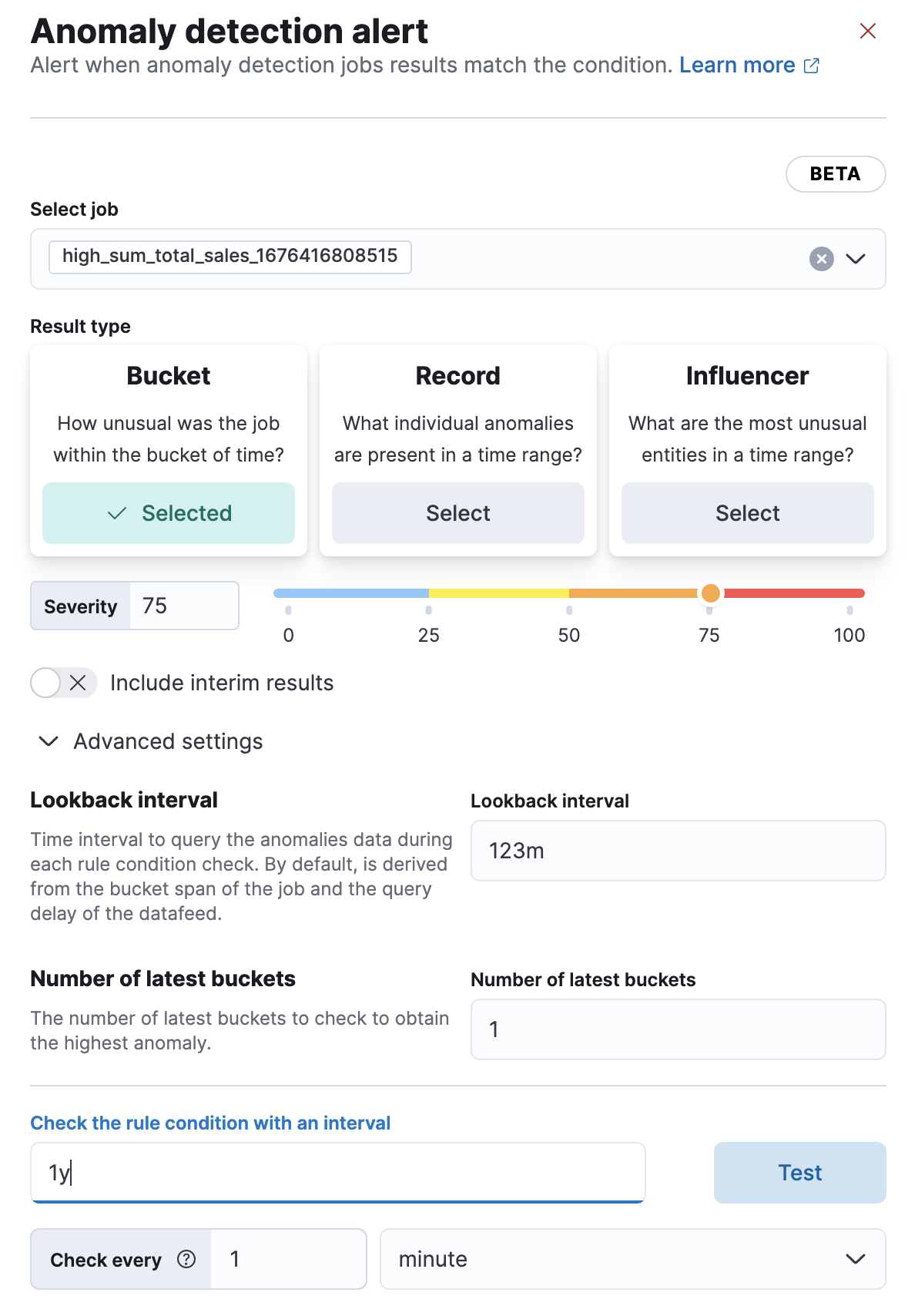

When you create an anomaly detection alert rule, you must select the job that the rule applies to.
You must also select a type of machine learning result. In particular, you can create rules based on bucket, record, or influencer results.
![Selecting result type, severity, and test interval](images/ml-anomaly-alert-severity.png)
For each rule, you can configure the anomaly_score
that triggers the action.
The anomaly_score
indicates the significance of a given anomaly compared to
previous anomalies. The default severity threshold is 75 which means every
anomaly with an anomaly_score
of 75 or higher triggers the associated action.
You can select whether you want to include interim results. Interim results are created by the anomaly detection job before a bucket is finalized. These results might disappear after the bucket is fully processed. Include interim results if you want to be notified earlier about a potential anomaly even if it might be a false positive. If you want to get notified only about anomalies of fully processed buckets, do not include interim results.
You can also configure advanced settings. Lookback interval sets an interval that is used to query previous anomalies during each condition check. Its value is derived from the bucket span of the job and the query delay of the datafeed by default. It is not recommended to set the lookback interval lower than the default value as it might result in missed anomalies. Number of latest buckets sets how many buckets to check to obtain the highest anomaly from all the anomalies that are found during the Lookback interval. An alert is created based on the anomaly with the highest anomaly score from the most anomalous bucket.
You can also test the configured conditions against your existing data and check the sample results by providing a valid interval for your data. The generated preview contains the number of potentially created alerts during the relative time range you defined.
You must also provide a check interval that defines how often to evaluate the rule conditions. It is recommended to select an interval that is close to the bucket span of the job.

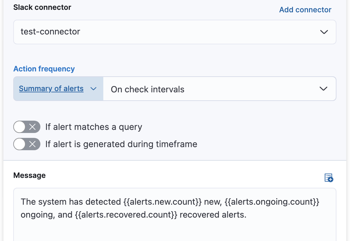

After you select a connector, you must set the action frequency. You can choose to create a summary of alerts on each check interval or on a custom interval. For example, send slack notifications that summarize the new, ongoing, and recovered alerts:
![Adding an alert summary action to the rule](images/ml-anomaly-alert-action-summary.png)
If you choose a custom action interval, it cannot be shorter than the rule’s check interval.

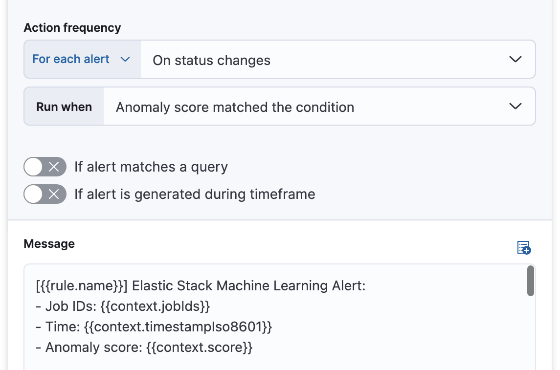

Alternatively, you can set the action frequency such that actions run for each alert. Choose how often the action runs (at each check interval, only when the alert status changes, or at a custom action interval). You must also choose an action group, which indicates whether the action runs when the anomaly score is matched or when the alert is recovered. For example:
![Adding an action for each alert in the rule](images/ml-anomaly-alert-action-score-matched.png)

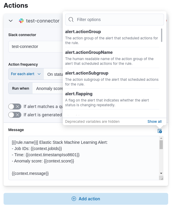

You can further refine the conditions under which actions run by specifying that actions only run they match a KQL query or when an alert occurs within a specific time frame.
There is a set of variables that you can use to customize the notification messages for each action. Click the icon above the message text box to get the list of variables or refer to Action variables.
![Customizing your message](images/ml-anomaly-alert-messages.png)

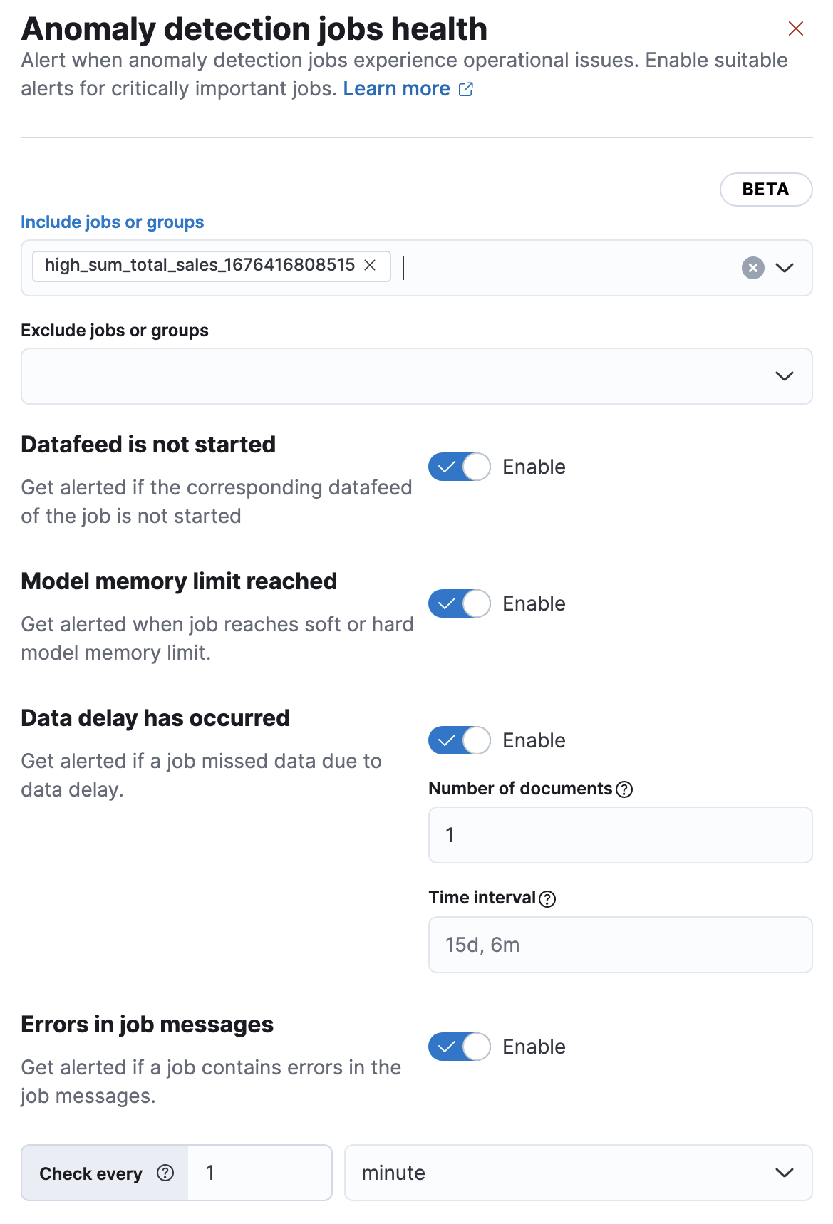

When you create an anomaly detection jobs health rule, you must select the job or group that the rule applies to. If you assign more jobs to the group, they are included the next time the rule conditions are checked.
You can also use a special character (*
) to apply the rule to all your jobs.
Jobs created after the rule are automatically included. You can exclude jobs
that are not critically important by using the Exclude field.
Enable the health check types that you want to apply. All checks are enabled by default. At least one check needs to be enabled to create the rule. The following health checks are available:
- Datafeed is not started
- Notifies if the corresponding datafeed of the job is not started but the job is in an opened state. The notification message recommends the necessary actions to solve the error.
- Model memory limit reached
- Notifies if the model memory status of the job reaches the soft or hard model memory limit. Optimize your job by following these guidelines or consider amending the model memory limit.
- Data delay has occurred
- Notifies when the job missed some data. You can define the threshold for the amount of missing documents you get alerted on by setting Number of documents. You can control the lookback interval for checking delayed data with Time interval. Refer to the Handling delayed data page to see what to do about delayed data.
- Errors in job messages
- Notifies when the job messages contain error messages. Review the notification; it contains the error messages, the corresponding job IDs and recommendations on how to fix the issue. This check looks for job errors that occur after the rule is created; it does not look at historic behavior.
![Selecting health checkers](images/ml-health-check-config.png)

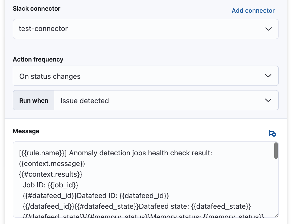

Anomaly detection jobs health rule actionsedit
You can optionally send notifications when the rule conditions are met and when they are no longer met. In particular, this rule type supports:
- actions that run when an issue is detected
- recovery actions that run when the rule conditions are no longer met
For each action, you must choose a connector, which provides connection information for a Kibana service or third-party integration. You must set the action frequency, which involves choosing how often to run the action (for example, at each check interval, only when the alert status changes, or at a custom action interval). You must also choose one of the action groups (for example, the action runs when the issue is detected or when it is recovered).
![Adding an action for each alert in the rule](images/ml-health-check-action.png)
You can pass rule values to an action to provide contextual details in the notification messages. For the list of variables that you can include in the message, click the icon above the message text box or refer to Action variables.
After you save the configurations, the rule appears in the Stack Management > Rules list; you can check its status and see the overview of its configuration information.
