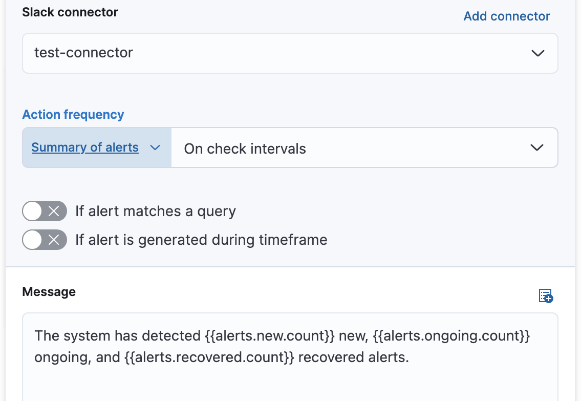

After you select a connector, you must set the action frequency. You can choose to create a summary of alerts on each check interval or on a custom interval. For example, send slack notifications that summarize the new, ongoing, and recovered alerts:
![Adding an alert summary action to the rule](images/ml-anomaly-alert-action-summary.png)
If you choose a custom action interval, it cannot be shorter than the rule’s check interval.

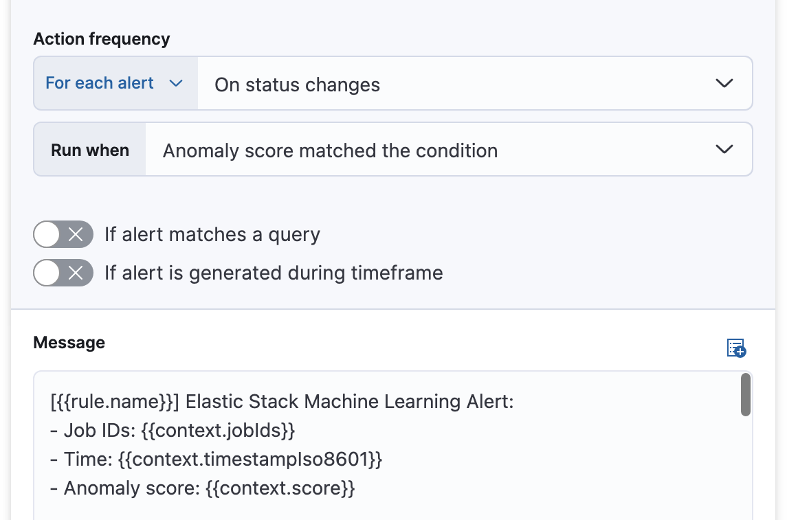

Alternatively, you can set the action frequency such that actions run for each alert. Choose how often the action runs (at each check interval, only when the alert status changes, or at a custom action interval). You must also choose an action group, which indicates whether the action runs when the anomaly score is matched or when the alert is recovered. For example:
![Adding an action for each alert in the rule](images/ml-anomaly-alert-action-score-matched.png)
You can further refine the conditions under which actions run by specifying that actions only run they match a KQL query or when an alert occurs within a specific time frame.
There is a set of variables that you can use to customize the notification messages for each action. Click the icon above the message text box to get the list of variables or refer to Action variables.

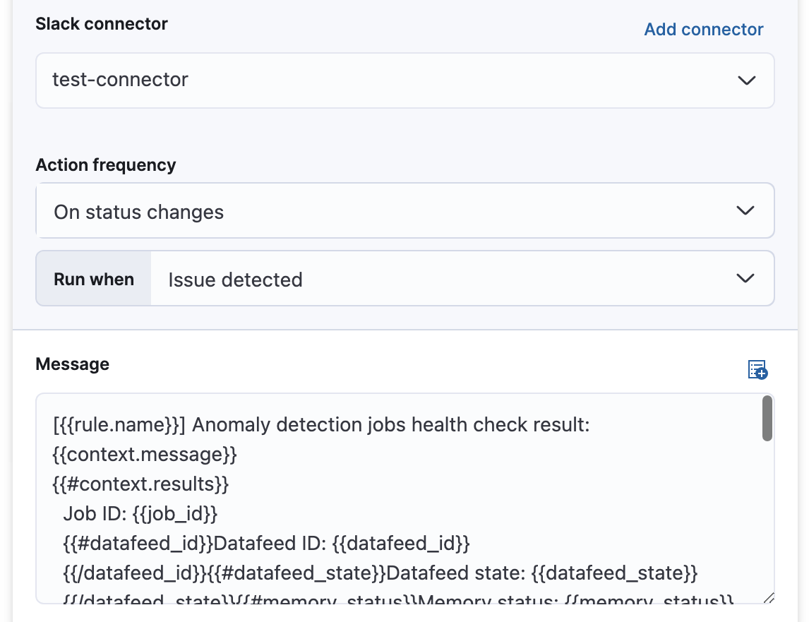

For each action, you must choose a connector, which provides connection information for a Kibana service or third-party integration. You must set the action frequency, which involves choosing how often to run the action (for example, at each check interval, only when the alert status changes, or at a custom action interval). You must also choose one of the action groups (for example, the action runs when the issue is detected or when it is recovered).
![Adding an action for each alert in the rule](images/ml-health-check-action.png)
You can pass rule values to an action to provide contextual details in the notification messages. For the list of variables that you can include in the message, click the icon above the message text box or refer to Action variables.
