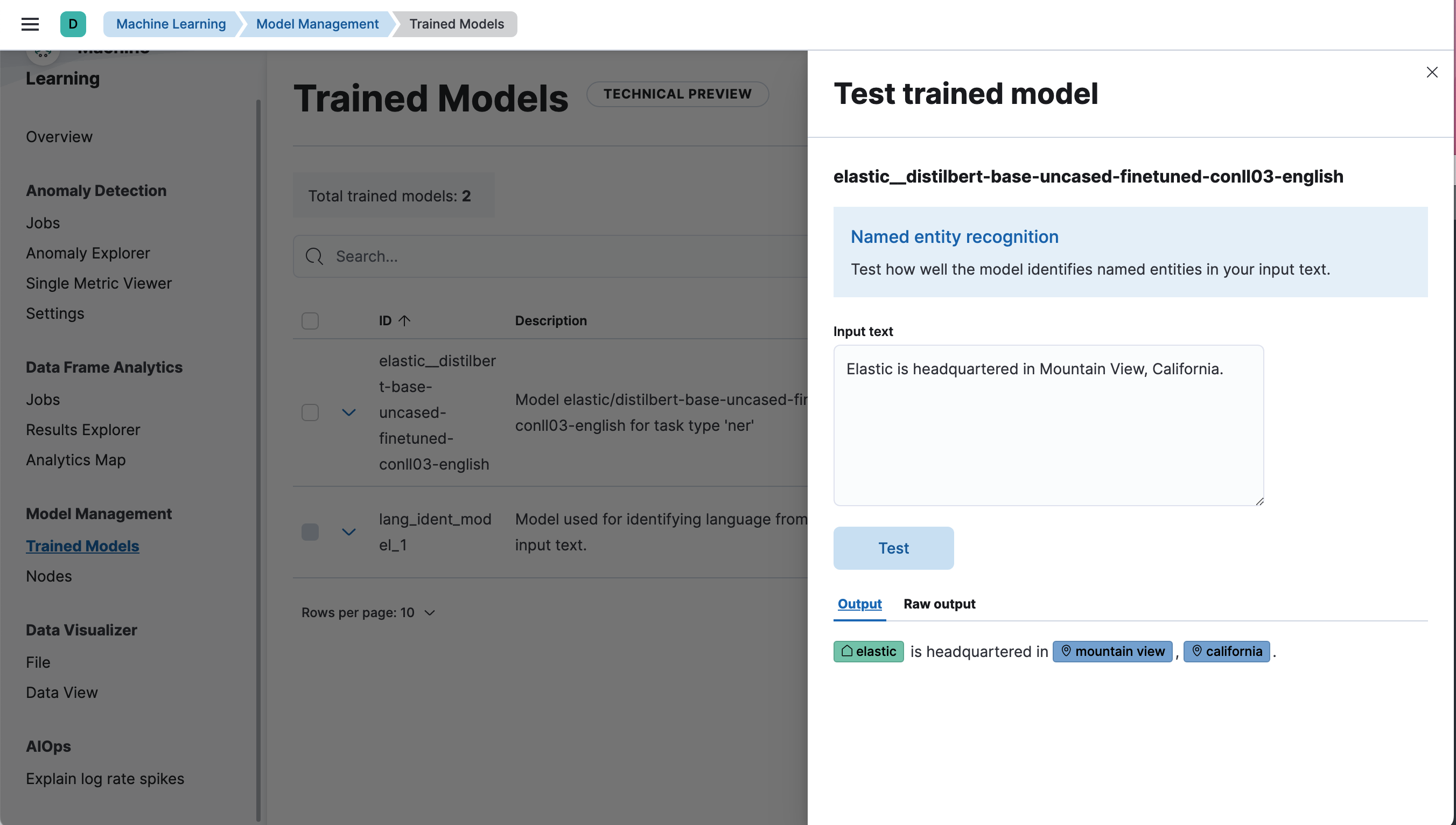

Test the NER model
editDeployed models can be evaluated in Kibana under Machine Learning > Trained Models by selecting the Test model action for the respective model.

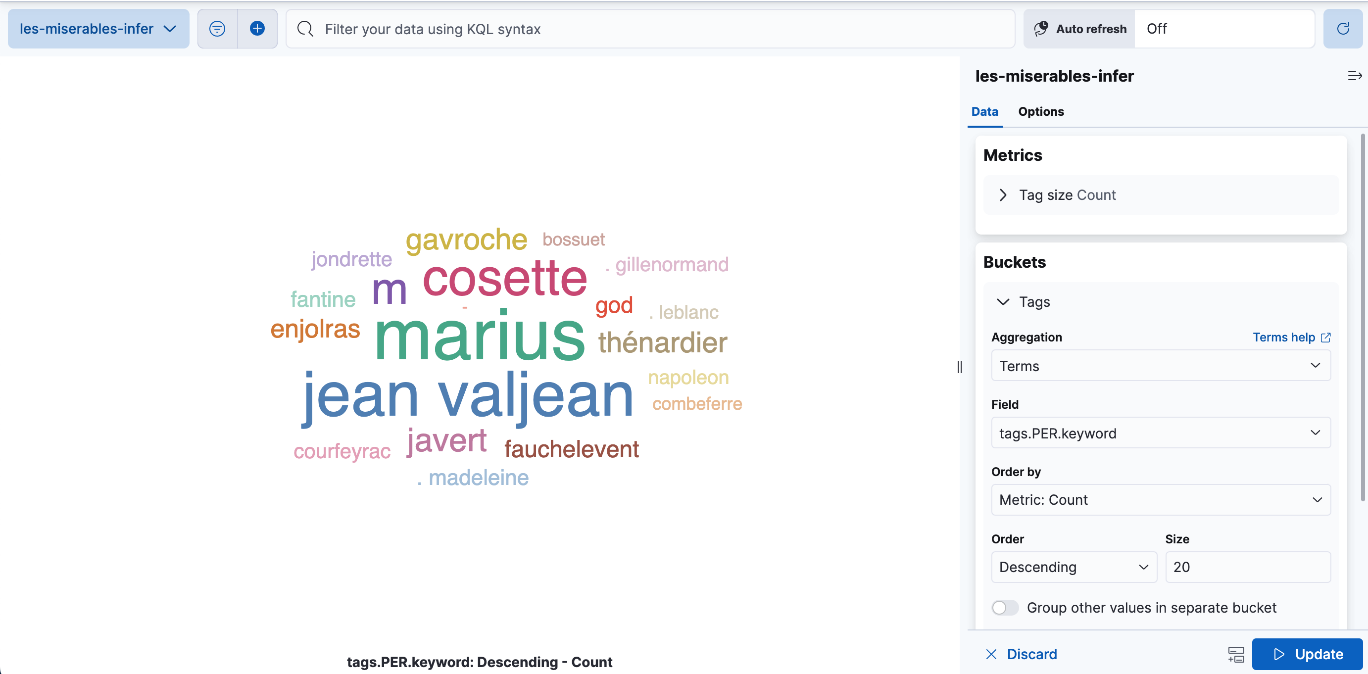

Visualize results
editYou can create a tag cloud to visualize your data processed by the inference pipeline. A tag cloud is a visualization that scales words by the frequency at which they occur. It is a handy tool for viewing the entities found in the data.
In Kibana, open Stack management > Data views, and create a new
data view from the les-miserables-infer index pattern.
Open Dashboard and create a new dashboard. Select the Aggregation based-type > Tag cloud visualization. Choose the new data view as the source.
Add a new bucket with a term aggregation, select the tags.PER.keyword field,
and increase the size to 20.
Optionally, adjust the time selector to cover the data points in the data view if you selected a time field when creating it.
Update and save the visualization.
