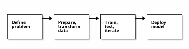

The workflow for supervised learning consists of the following stages:
Supervised learning workflow
These are iterative stages, meaning that after evaluating each step, you might need to make adjustments before you move further.
