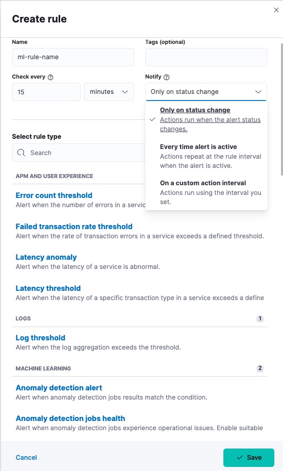

On the Create rule window, give a name to the rule and optionally provide
tags. Specify the time interval for the rule to check detected anomalies or job
health changes. It is recommended to select an interval that is close to the
bucket span of the job. You can also select a notification option with the
Notify selector. An alert remains active as long as the configured conditions
are met during the check interval. When there is no matching condition in the
next interval, the Recovered
action group is invoked and the status of the
alert changes to OK
. For more details, refer to the documentation of
general rule details.
Select the rule type you want to create under the machine learning section and continue to configure it depending on whether it is an anomaly detection alert or an anomaly detection job health rule.

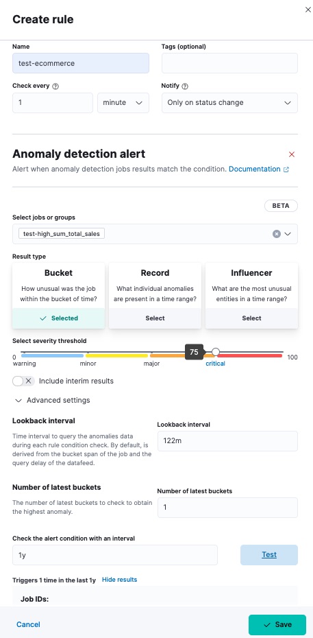

Anomaly detection alertedit
Select the job that the rule applies to.
You must select a type of machine learning result. In particular, you can create rules based on bucket, record, or influencer results.
For each rule, you can configure the anomaly_score
that triggers the action.
The anomaly_score
indicates the significance of a given anomaly compared to
previous anomalies. The default severity threshold is 75 which means every
anomaly with an anomaly_score
of 75 or higher triggers the associated action.
You can select whether you want to include interim results. Interim results are created by the anomaly detection job before a bucket is finalized. These results might disappear after the bucket is fully processed. Include interim results if you want to be notified earlier about a potential anomaly even if it might be a false positive. If you want to get notified only about anomalies of fully processed buckets, do not include interim results.
You can also configure advanced settings. Lookback interval sets an interval that is used to query previous anomalies during each condition check. Its value is derived from the bucket span of the job and the query delay of the datafeed by default. It is not recommended to set the lookback interval lower than the default value as it might result in missed anomalies. Number of latest buckets sets how many buckets to check to obtain the highest anomaly from all the anomalies that are found during the Lookback interval. An alert is created based on the anomaly with the highest anomaly score from the most anomalous bucket.
You can also test the configured conditions against your existing data and check the sample results by providing a valid interval for your data. The generated preview contains the number of potentially created alerts during the relative time range you defined.
As the last step in the rule creation process, define the actions that occur when the conditions are met.

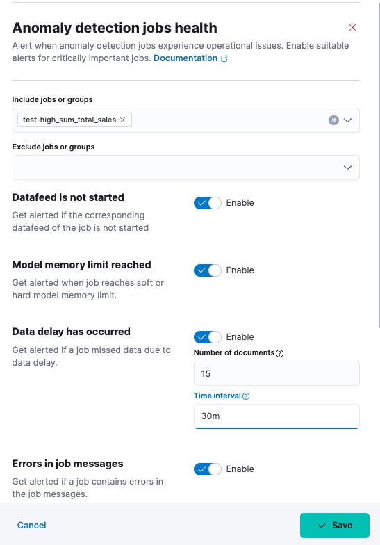

Anomaly detection jobs healthedit
Select the job or group that the rule applies to. If you assign more jobs to the group, they are included the next time the rule conditions are checked.
You can also use a special character (*
) to apply the rule to all your jobs.
Jobs created after the rule are automatically included. You can exclude jobs
that are not critically important by using the Exclude field.
Enable the health check types that you want to apply. All checks are enabled by default. At least one check needs to be enabled to create the rule. The following health checks are available:
- Datafeed is not started
- Notifies if the corresponding datafeed of the job is not started but the job is in an opened state. The notification message recommends the necessary actions to solve the error.
- Model memory limit reached
- Notifies if the model memory status of the job reaches the soft or hard model memory limit. Optimize your job by following these guidelines or consider amending the model memory limit.
- Data delay has occurred
- Notifies when the job missed some data. You can define the threshold for the amount of missing documents you get alerted on by setting Number of documents. You can control the lookback interval for checking delayed data with Time interval. Refer to the Handling delayed data page to see what to do about delayed data.
- Errors in job messages
- Notifies when the job messages contain error messages. Review the notification; it contains the error messages, the corresponding job IDs and recommendations on how to fix the issue. This check looks for job errors that occur after the rule is created; it does not look at historic behavior.

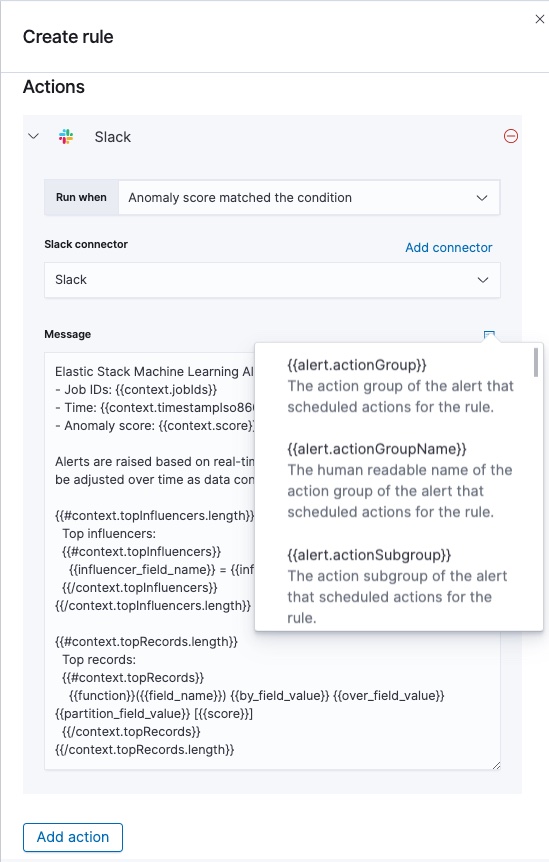

Defining actionsedit

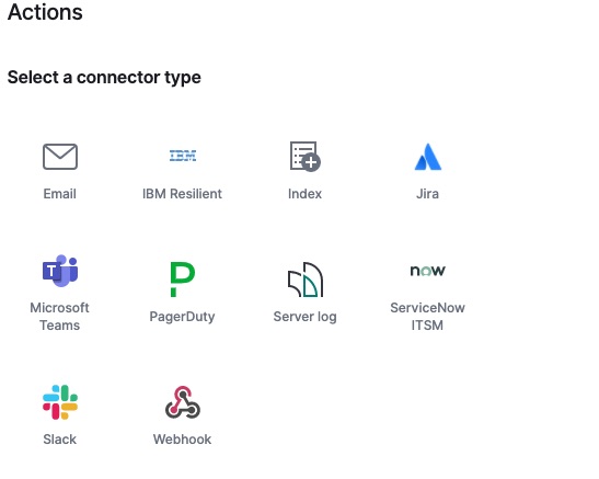

Connect your rule to actions that use supported built-in integrations by selecting a connector type. Connectors are Kibana services or third-party integrations that perform an action when the rule conditions are met.
For example, you can choose Slack as a connector type and configure it to send a message to a channel you selected. You can also create an index connector that writes the JSON object you configure to a specific index. It’s also possible to customize the notification messages. A list of variables is available to include in the message, like job ID, anomaly score, time, top influencers, datafeed ID, memory status and so on based on the selected rule type. Refer to Action variables to see the full list of available variables by rule type.
After you save the configurations, the rule appears in the Alerts and Actions list where you can check its status and see the overview of its configuration information.
The name of an alert is always the same as the job ID of the associated anomaly detection job that triggered it. You can mute the notifications for a particular anomaly detection job on the page of the rule that lists the individual alerts. You can open it via Alerts and Actions by selecting the rule name.
