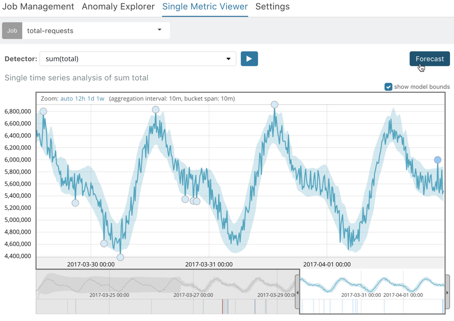

  1. Go to the Single Metric Viewer and select one of the jobs that you created in this tutorial. For example, select the total-requests job.
  2. Click Forecast.

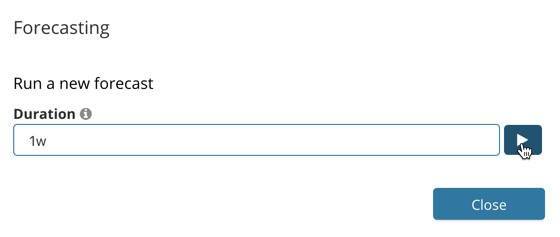

  3. Specify a duration for your forecast. This value indicates how far to extrapolate beyond the last record that was processed. You must use time units, such as 30d for 30 days. For more information, see Time Units. In this example, we use a duration of 1 week:
    Specify a duration of 1w

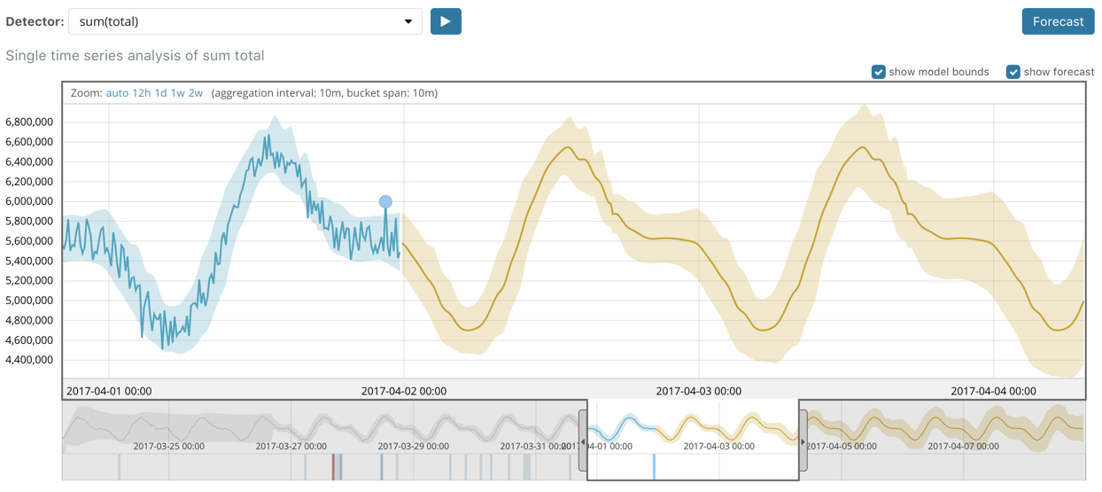

  4. View the forecast in the Single Metric Viewer:
    View a forecast from the Single Metric Viewer
    The yellow line in the chart represents the predicted data values. The shaded yellow area represents the bounds for the predicted values, which also gives an indication of the confidence of the predictions. Note that the bounds generally increase with time (that is to say, the confidence levels decrease), since you are forecasting further into the future. Eventually if the confidence levels are too low, the forecast stops.

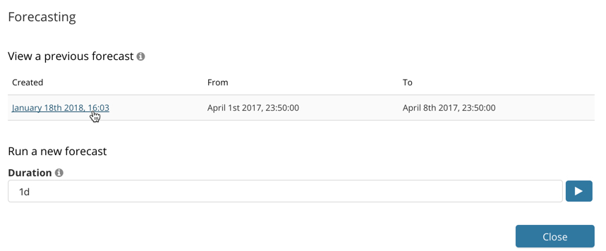

    1. After you restart the datafeed, re-open the forecast by selecting the job in the Single Metric Viewer, clicking Forecast, and selecting your forecast from the list. For example:
      Open a forecast in the Single Metric Viewer

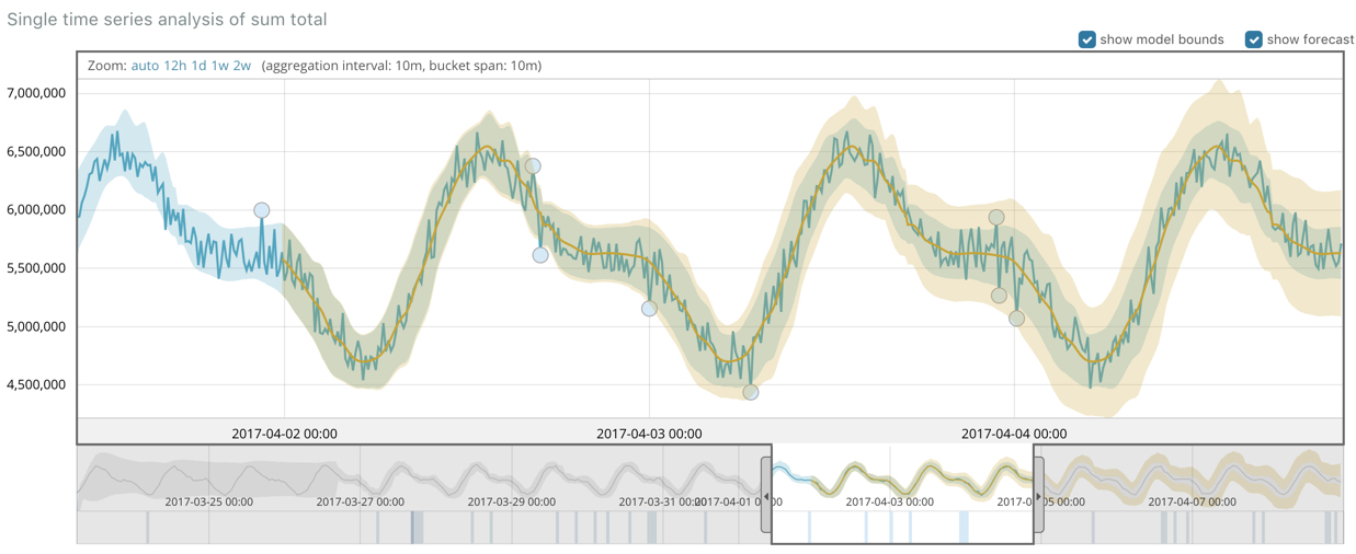

    2. View the forecast and actual data in the Single Metric Viewer:
      View a forecast over actual data in the Single Metric Viewer
      The chart contains the actual data values, the bounds for the expected values, the anomalies, the forecast data values, and the bounds for the forecast. This combination of actual and forecast data gives you an indication of how well the machine learning features can extrapolate the future behavior of the data.
