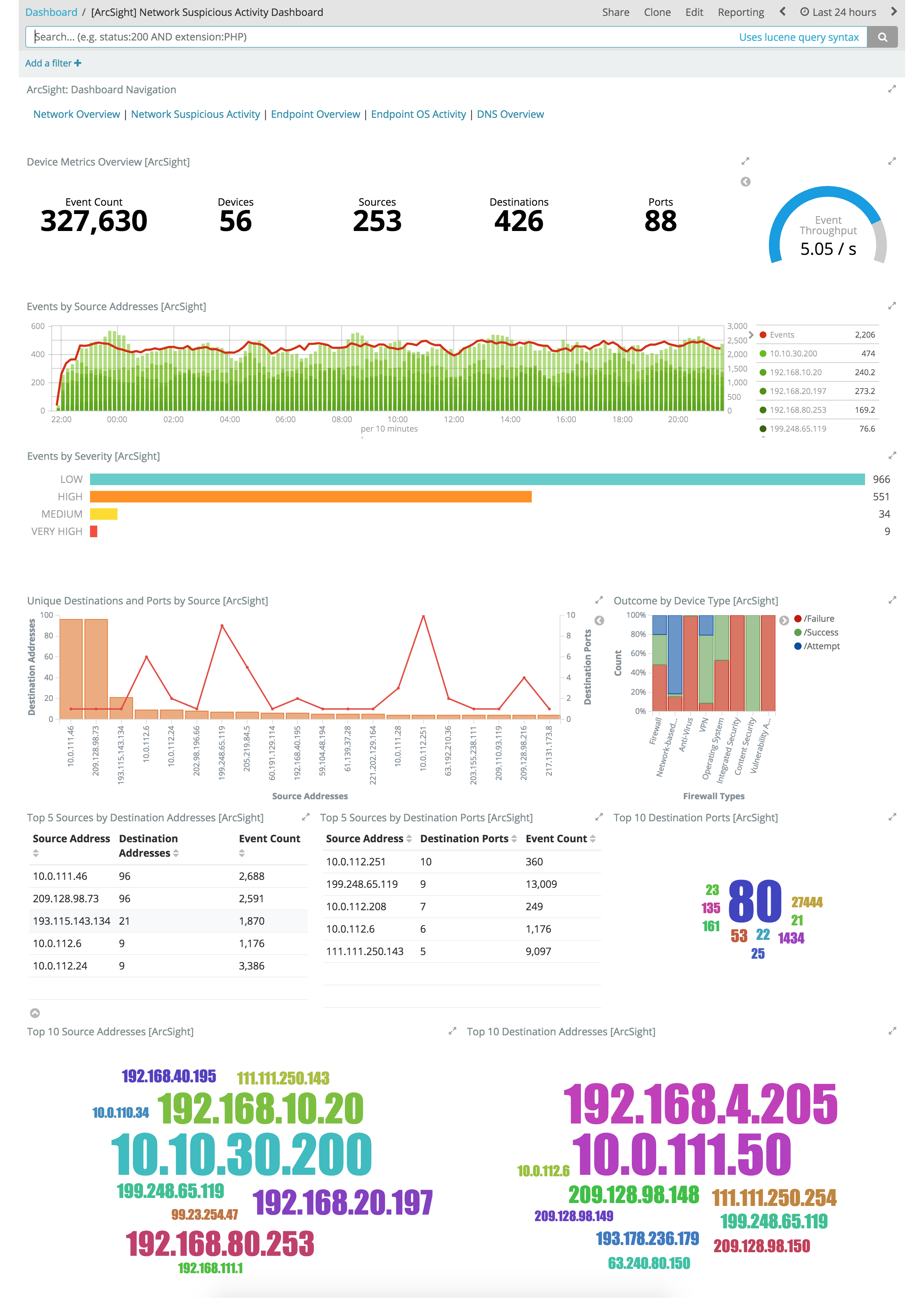

Exploring Your Security Dataedit
Once the Logstash ArcSight module starts receiving events, you can immediately begin using the packaged Kibana dashboards to explore and visualize your security data. The dashboards rapidly accelerate the time and effort required for security analysts and operators to gain situational and behavioral insights on network, endpoint, and DNS events flowing through the environment. You can use the dashboards as-is, or tailor them to work better with existing use cases and business requirements.
The dashboards have a navigation pane for context switching and drill downs across three core use cases:
Network Data
- Dashboards: Network Overview, Network Suspicious Activity
- Data Types: Network firewalls, intrusion systems, VPN devices
Endpoint Data
- Dashboards: Endpoint Overview, Endpoint OS Activity
- Data Types: Operating systems, applications, host intrusion systems
DNS Data
- Dashboards: Microsoft DNS Overview
- Data Types: Microsoft DNS devices
Example Network Dashboardsedit
![Network overview dashboard](static/images/arcsight-network-overview.png)
![Network suspicious activity dashboard](static/images/arcsight-network-suspicious.png)
These Kibana visualizations enable you to quickly understand the top devices, endpoints, attackers, and targets. This insight, along with the ability to instantly drill down on a particular host, port, device, or time range, offers a holistic view across the entire environment to identify specific segments that may require immediate attention or action. You can easily discover answers to questions like:
- Who are my attackers and what are they targeting?
- Which of my devices or endpoints are the busiest and what services were rendered?
- How many unique attackers, techniques, signatures, or targets were triggered at any given point in time?
- What are the top sources, destinations, protocols, and behaviors that are causing the elevated count of failures?
