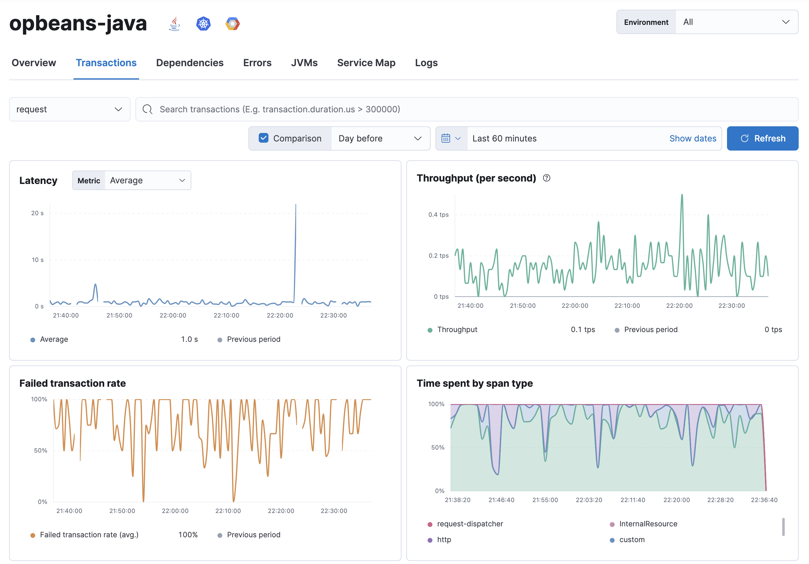

The Latency, Throughput, Failed transaction rate, Average duration by span type, and Cold start rate charts display information on all transactions associated with the selected service:
- Latency
- Response times for the service. Options include average, 95th, and 99th percentile. If there’s a weird spike that you’d like to investigate, you can simply zoom in on the graph - this will adjust the specific time range, and all of the data on the page will update accordingly.
- Throughput
Visualize response codes:
2xx,3xx,4xx, etc. Useful for determining if more responses than usual are being served with a particular response code. Like in the latency graph, you can zoom in on anomalies to further investigate them.
- Failed transaction rate
The failed transaction rate represents the percentage of failed transactions from the perspective of the selected service. It’s useful for visualizing unexpected increases, decreases, or irregular patterns in a service’s transactions.
HTTP transactions from the HTTP server perspective do not consider a
4xxstatus code (client error) as a failure because the failure was caused by the caller, not the HTTP server. Thus,event.outcome=successand there will be no increase in failed transaction rate.HTTP spans from the client perspective however, are considered failures if the HTTP status code is ≥ 400. These spans will set
event.outcome=failureand increase the failed transaction rate.If there is no HTTP status, both transactions and spans are considered successful unless an error is reported.
- Average duration by span type
Visualize where your application is spending most of its time. For example, is your app spending time in external calls, database processing, or application code execution?
The time a transaction took to complete is also recorded and displayed on the chart under the "app" label. "app" indicates that something was happening within the application, but we’re not sure exactly what. This could be a sign that the APM agent does not have auto-instrumentation for whatever was happening during that time.
It’s important to note that if you have asynchronous spans, the sum of all span times may exceed the duration of the transaction.
- Cold start rate
- Only applicable to serverless transactions, this chart displays the percentage of requests that trigger a cold start of a serverless function. See Cold starts for more information.

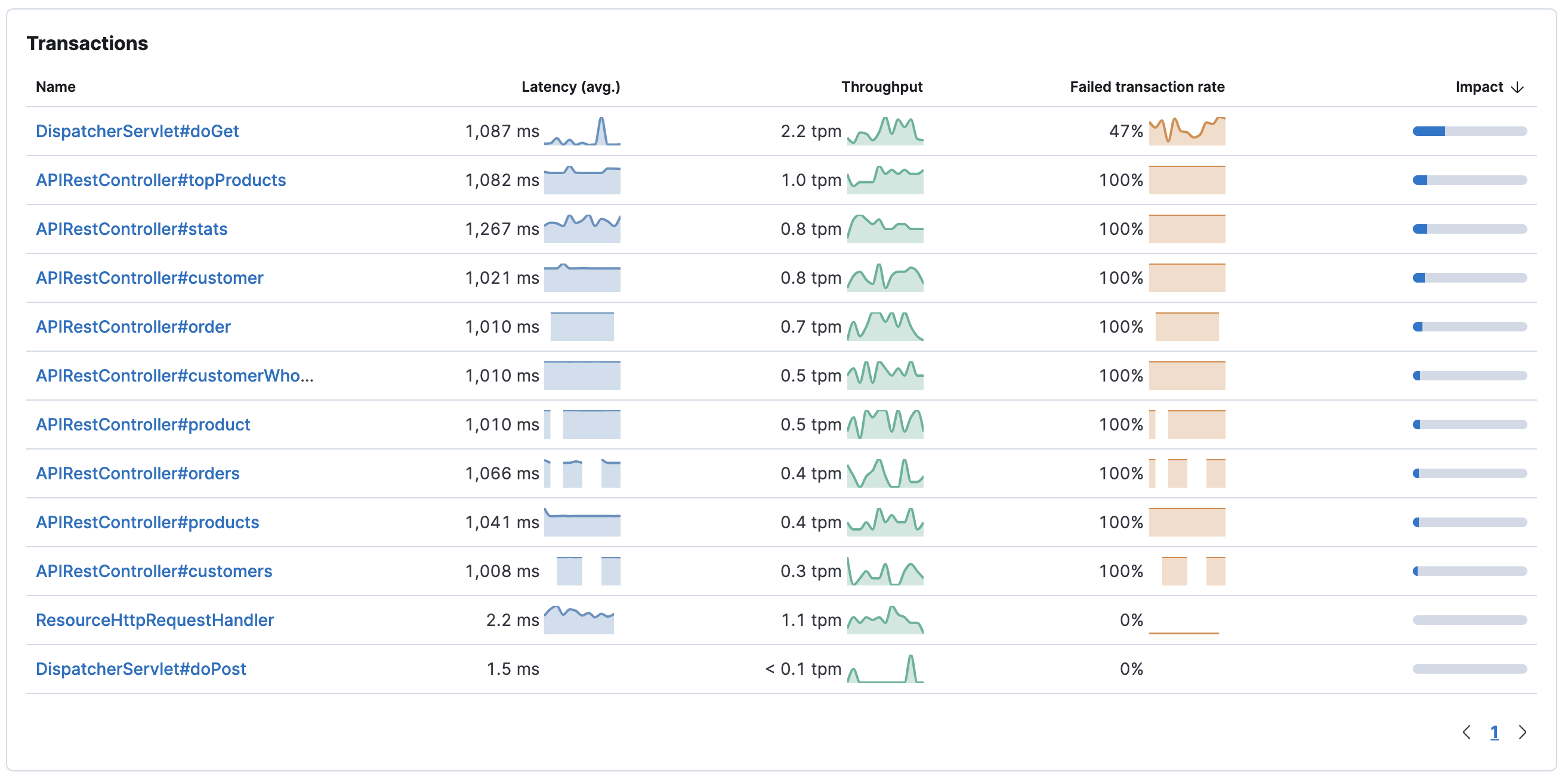

Transactions table
editThe Transactions table displays a list of transaction groups for the selected service. In other words, this view groups all transactions of the same name together, and only displays one entry for each group.
By default, transaction groups are sorted by Impact. Impact helps show the most used and slowest endpoints in your service - in other words, it’s the collective amount of pain a specific endpoint is causing your users. If there’s a particular endpoint you’re worried about, you can click on it to view the transaction details.
If you only see one route in the Transactions table, or if you have transactions named "unknown route", it could be a symptom that the APM agent either wasn’t installed correctly or doesn’t support your framework.
For further details, including troubleshooting and custom implementation instructions, refer to the documentation for each APM Agent you’ve implemented.

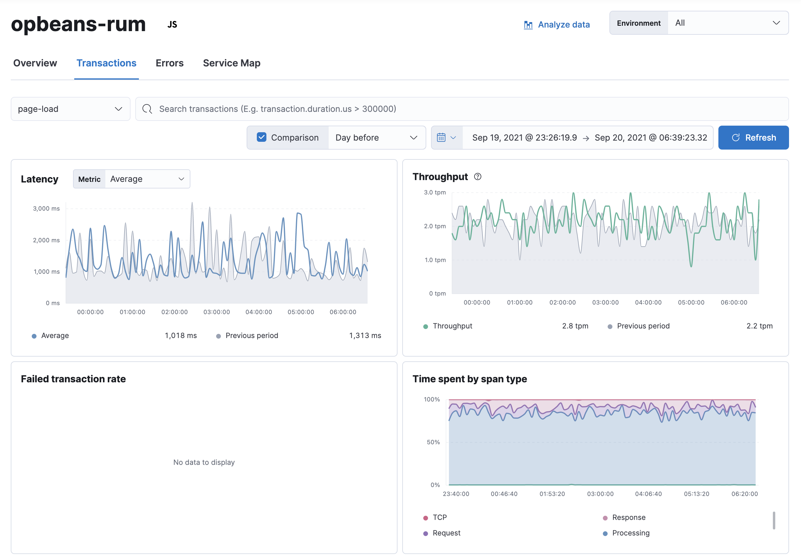

RUM Transaction overview
editThe transaction overview page is customized for the JavaScript RUM agent. Specifically, the page highlights page load times for your service:
Additional RUM goodies, like core vitals, and visitor breakdown by browser, location, and device, are available in the Observability User Experience tab.

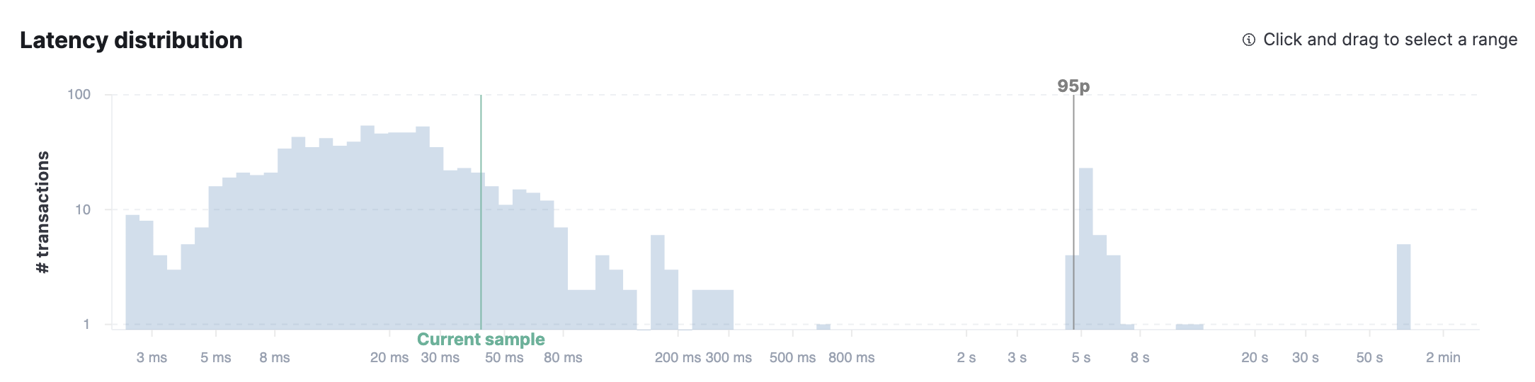

Latency distribution
editA plot of all transaction durations for the given time period. The screenshot below shows a typical distribution, and indicates most of our requests were served quickly — awesome! It’s the requests on the right, the ones taking longer than average, that we probably need to focus on.
Click and drag to select a latency duration bucket to display up to 500 trace samples.

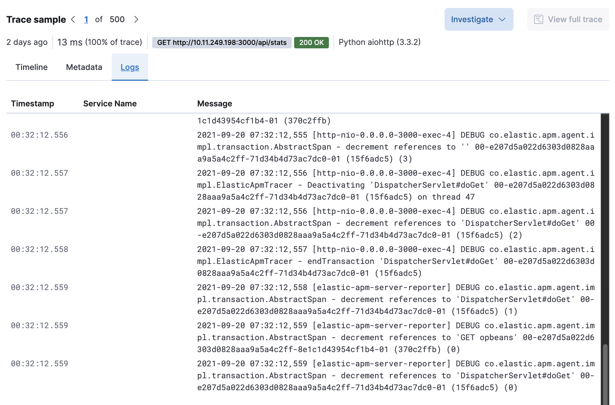

Trace sample logs
The Logs tab displays logs related to the sampled trace.
Logs provide detailed information about specific events, and are crucial to successfully debugging slow or erroneous transactions.
If you’ve correlated your application’s logs and traces, you never have to search for relevant data; it’s already available to you. Viewing log and trace data together allows you to quickly diagnose and solve problems.
To learn how to correlate your logs with your instrumented services, see log correlation
