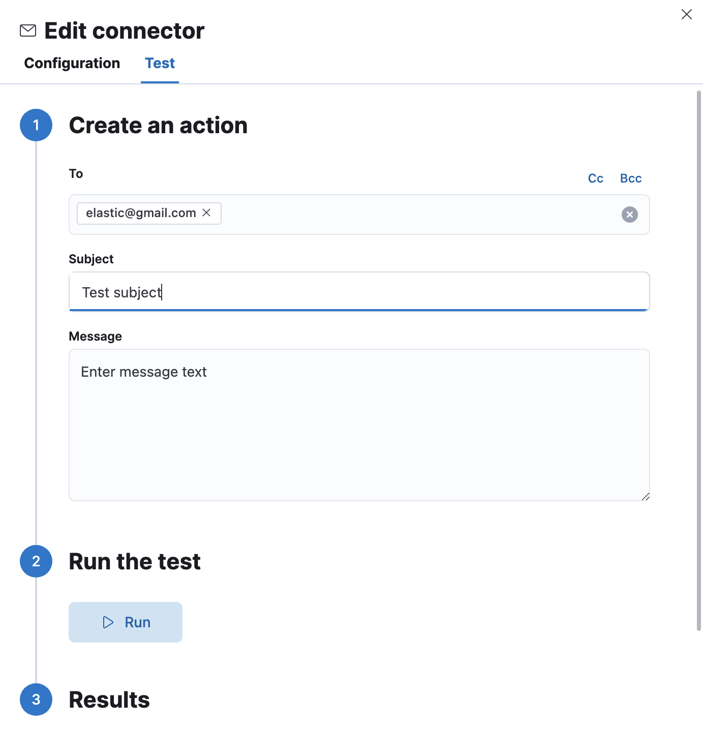

Test connectorsedit
You can test connectors with the run connector API or as you’re creating or editing the connector in Kibana. For example:
Email actions have the following configuration properties.
- To, CC, BCC
Each item is a list of addresses. Addresses can be specified in
user@host-name
format, or inname <user@host-name>
format. One of To, CC, or BCC must contain an entry. - Subject
- The subject line of the email.
- Message
- The message text of the email. Markdown format is supported.

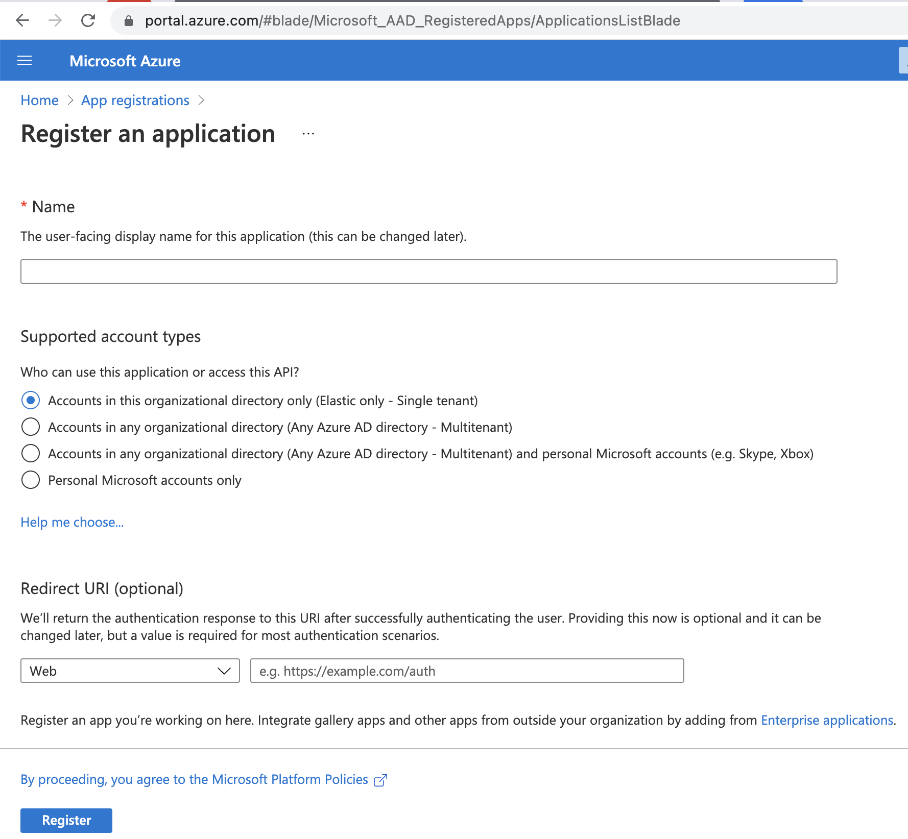

Before you create an email connector for Microsoft Exchange, you must create and register the client integration application on the Azure portal:

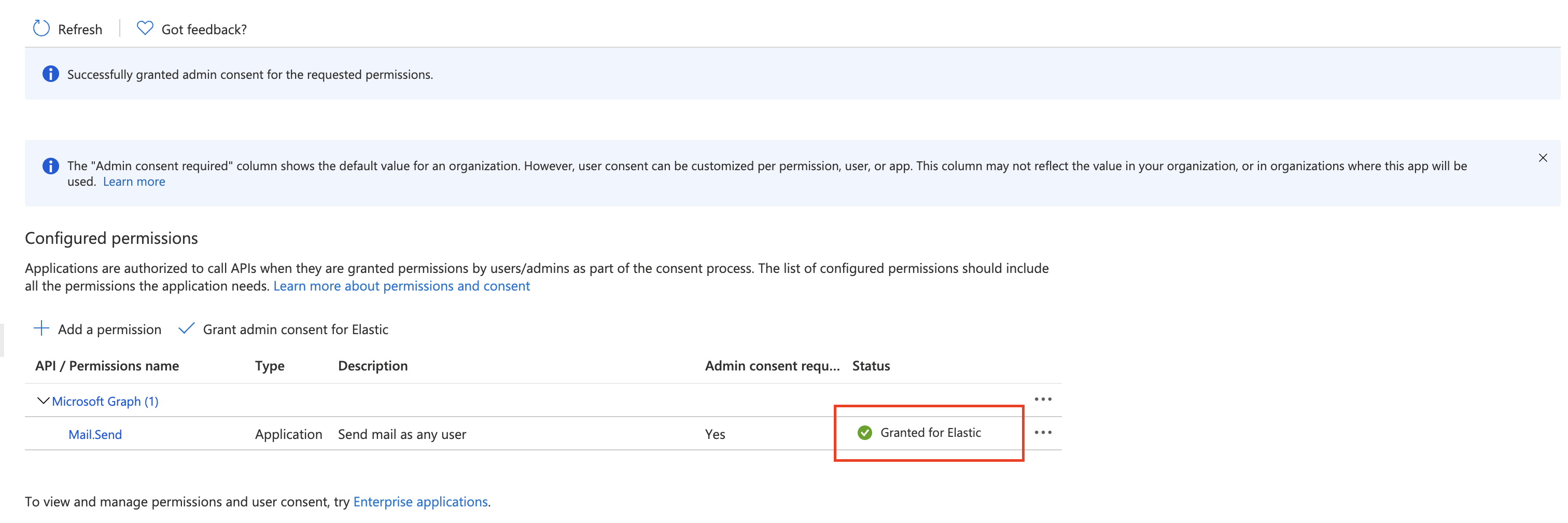

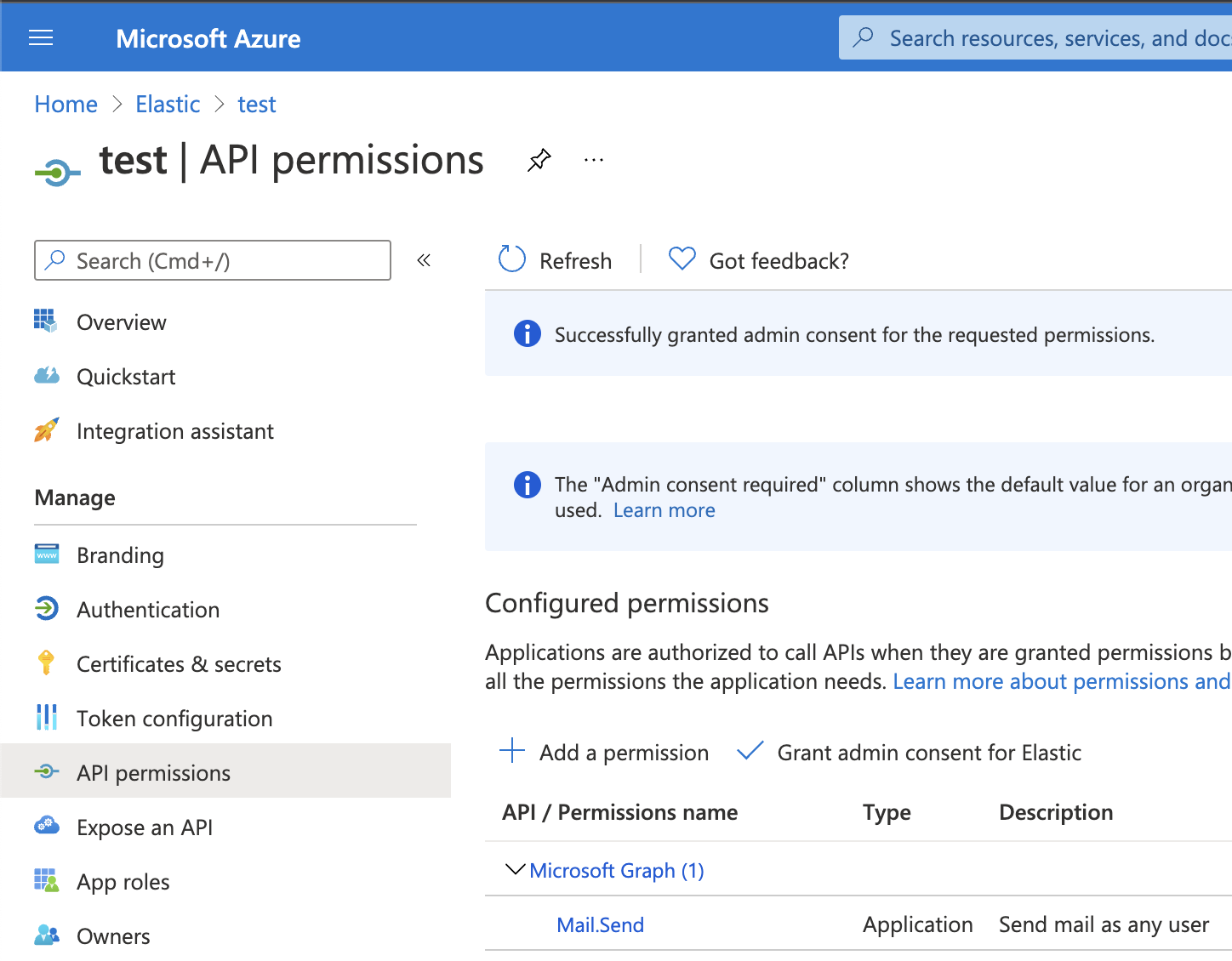

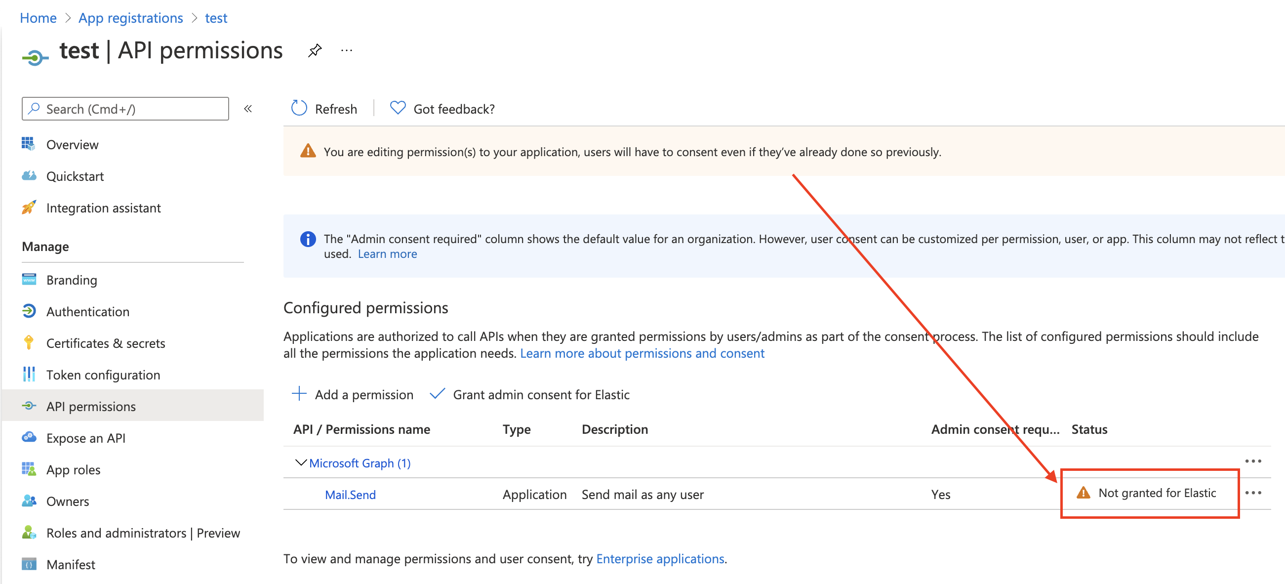

Next, open Manage > API permissions, and then define the permissions for the registered application to send emails. Refer to the documentation for the Microsoft Graph API.
Add the "Mail.Send" permission for Microsoft Graph. The permission appears in the list with the status "Not granted for <your Azure active directory>":

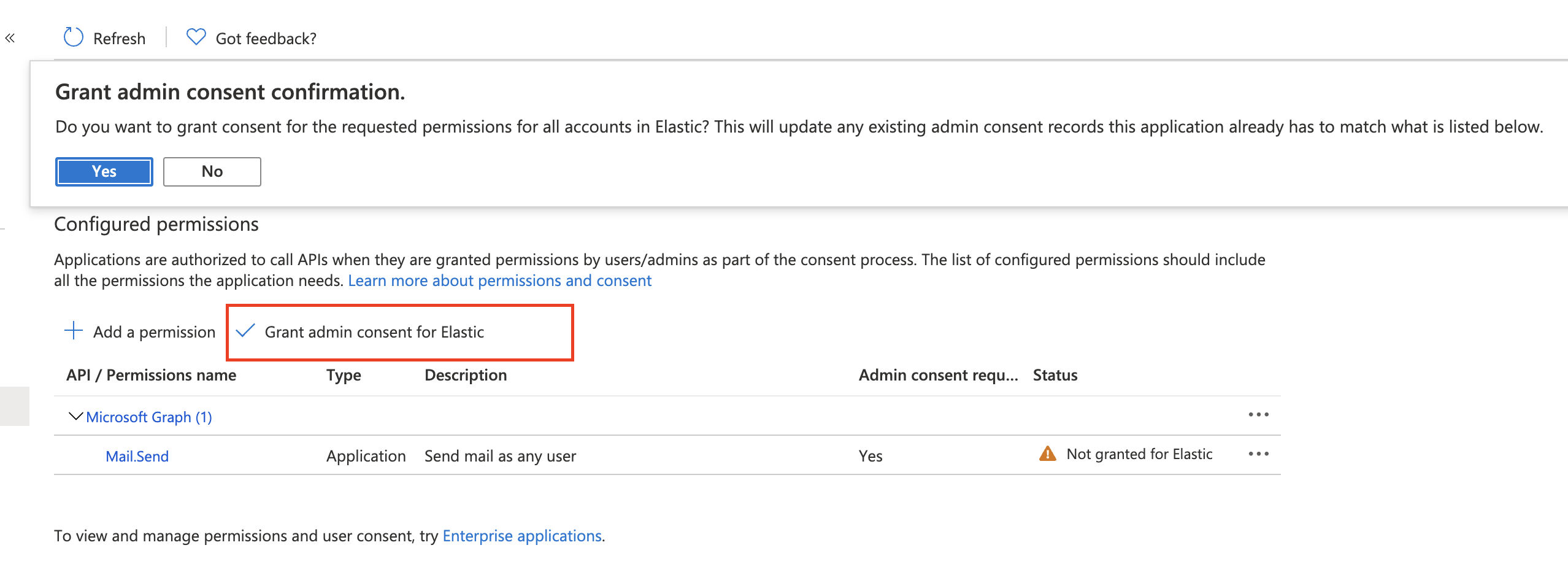

Click Grant admin consent for <your Azure active directory>.
Confirm that the status for the "Mail.Send" permission is now granted.

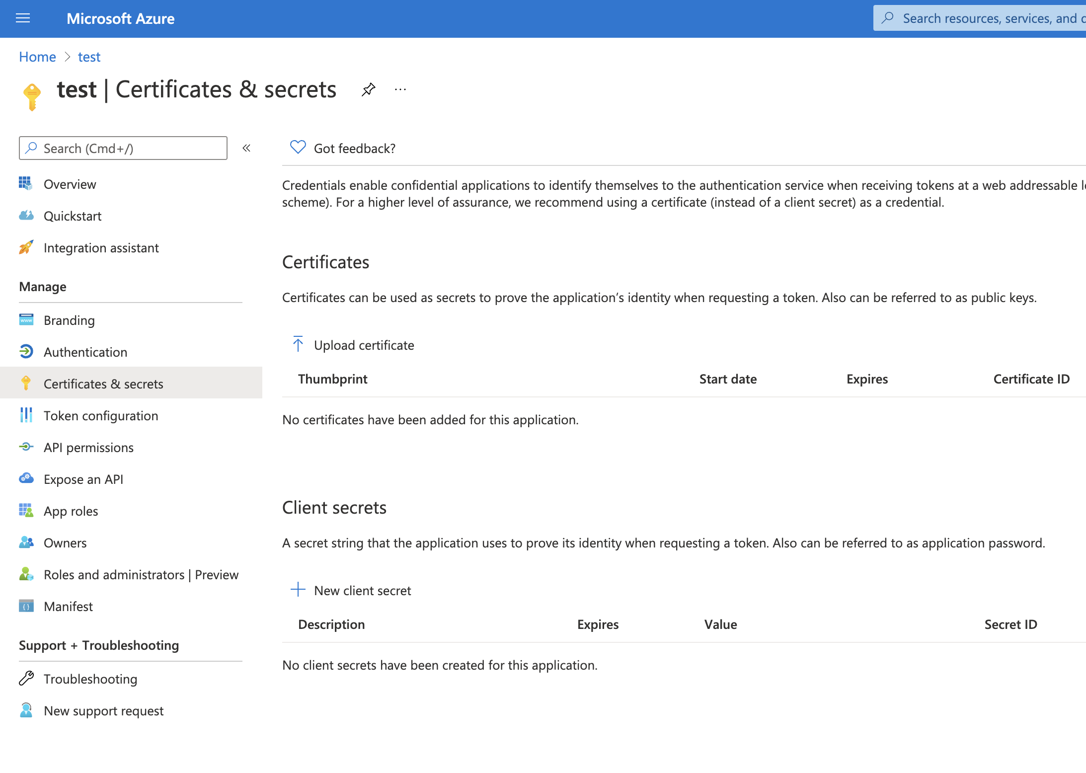

Configure Microsoft Exchange Client secretedit
To configure the Client secret , open Manage > Certificates & secrets.
Add a new client secret, then copy the value and put it to the proper field in the Microsoft Exchange email connector.

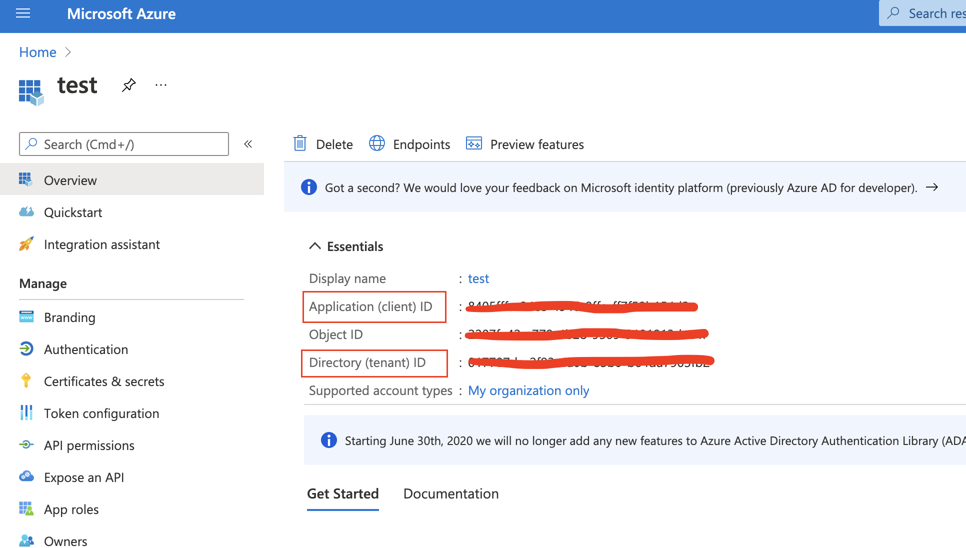

Configure Microsoft Exchange Client ID and Tenant IDedit
To find the application Client ID, open the Overview page.
Copy and paste this values to the proper fields in the Microsoft Exchange email connector.
