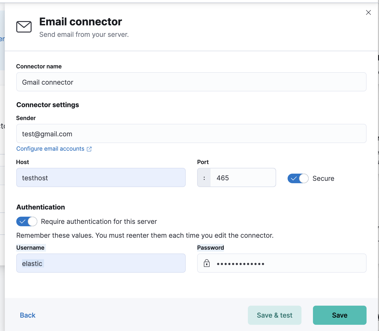

Connector configurationedit
Email connectors have the following configuration properties:
Name
The name of the connector. The name is used to identify a connector in the management UI connector listing, or in the connector list when configuring an action.
Sender
The from address for all emails sent with this connector. This must be specified in user@host-name format. See the Nodemailer address documentation for more information.
Service
The name of the email service. If service is one of Nodemailer’s well-known email service providers, the host, port, and secure properties are defined with the default values and disabled for modification. If service is MS Exchange Server, the host, port, and secure properties are ignored and tenantId, clientId, clientSecret are required instead. If service is other, the host and port properties must be defined.
Host
Host name of the service provider. If you are using the xpack.actions.allowedHosts setting, make sure this hostname is added to the allowed hosts.
Port
The port to connect to on the service provider.
Secure
If true, the connection will use TLS when connecting to the service provider. Refer to the Nodemailer TLS documentation for more information. If not true, the connection will initially connect over TCP, then attempt to switch to TLS via the SMTP STARTTLS command.
Tenant ID
The directory tenant that the application plans to operate against, in GUID format.
Client ID
The application ID that is assigned to your app, in GUID format. You can find this information in the portal where you registered your app.
Client Secret
The client secret that you generated for your app in the app registration portal. The client secret must be URL-encoded before being sent. The Basic auth pattern of providing credentials in the Authorization header, per RFC 6749, is also supported.
Require authentication
If true, a username and password for login type authentication must be provided.
Username
Username for login type authentication.
Password
Password for login type authentication.

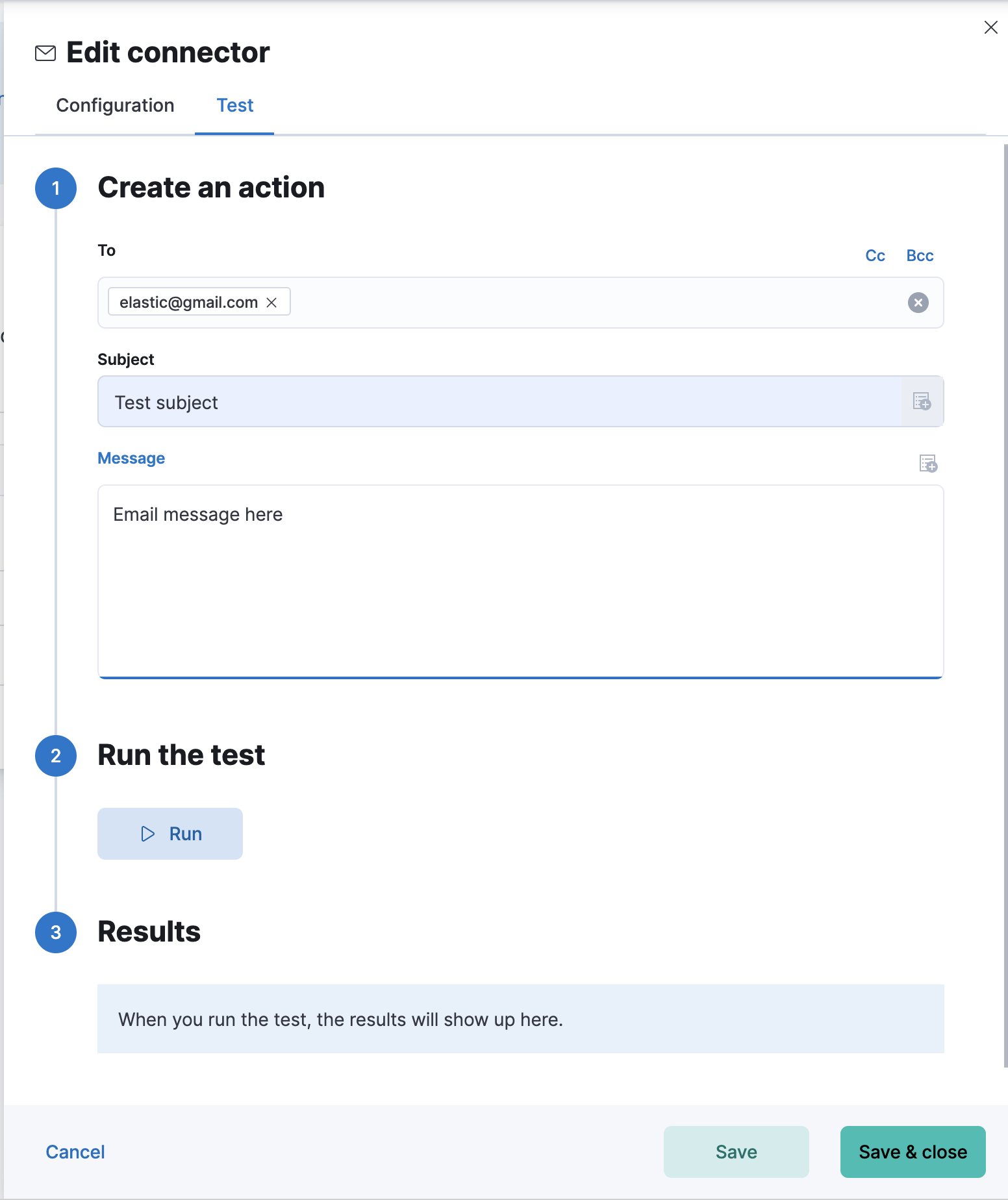

Test connectorsedit
You can test connectors with the run connector API or as you’re creating or editing the connector in Kibana. For example:
Email params test
Email actions have the following configuration properties.
To, CC, BCC
Each item is a list of addresses. Addresses can be specified in user@host-name format, or in name <user@host-name> format. One of To, CC, or BCC must contain an entry.
Subject
The subject line of the email.
Message
The message text of the email. Markdown format is supported.

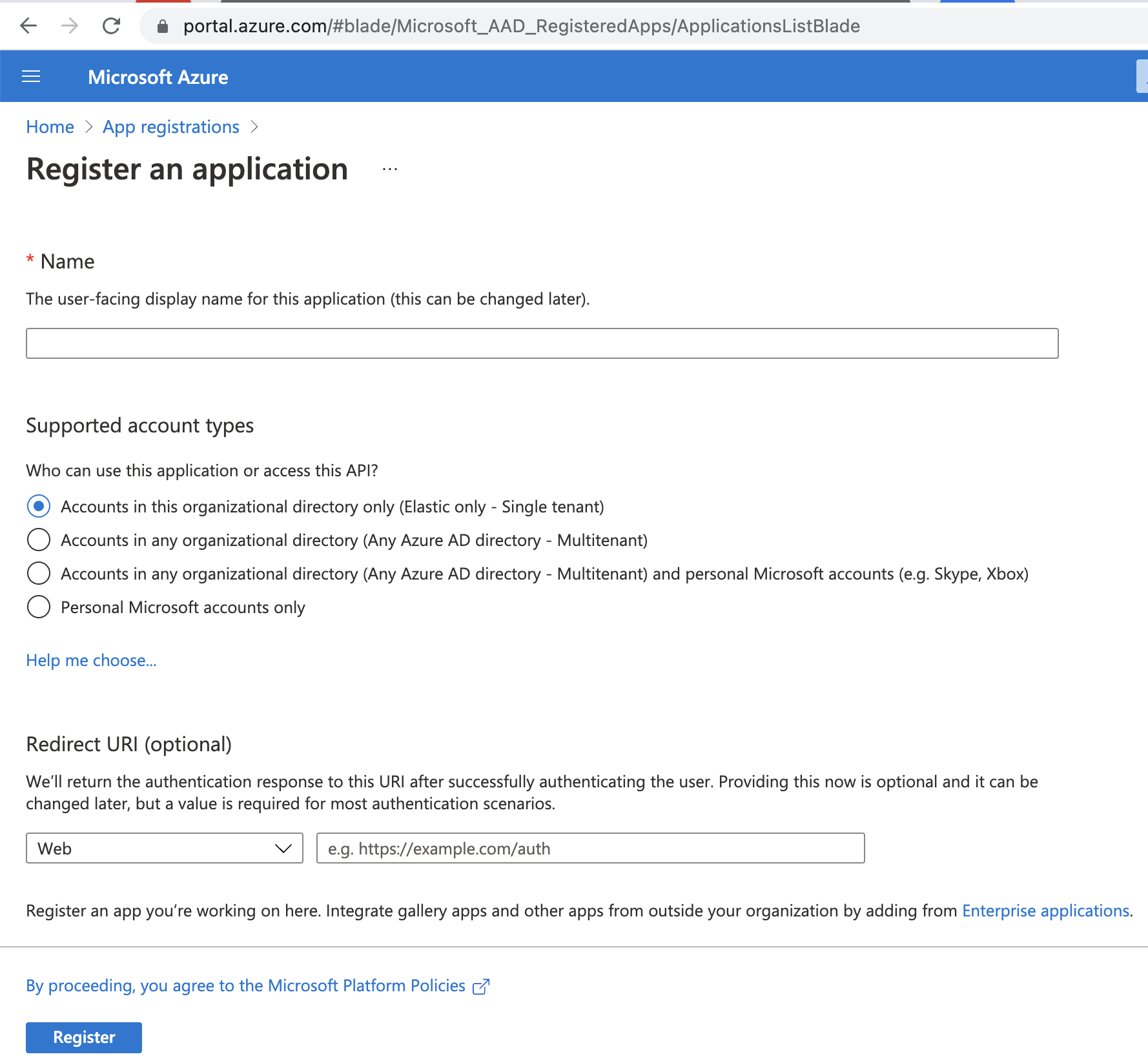

Before you create an email connector for Microsoft Exchange, you must create and register the client integration application on the Azure portal:
Register client application for MS Exchange

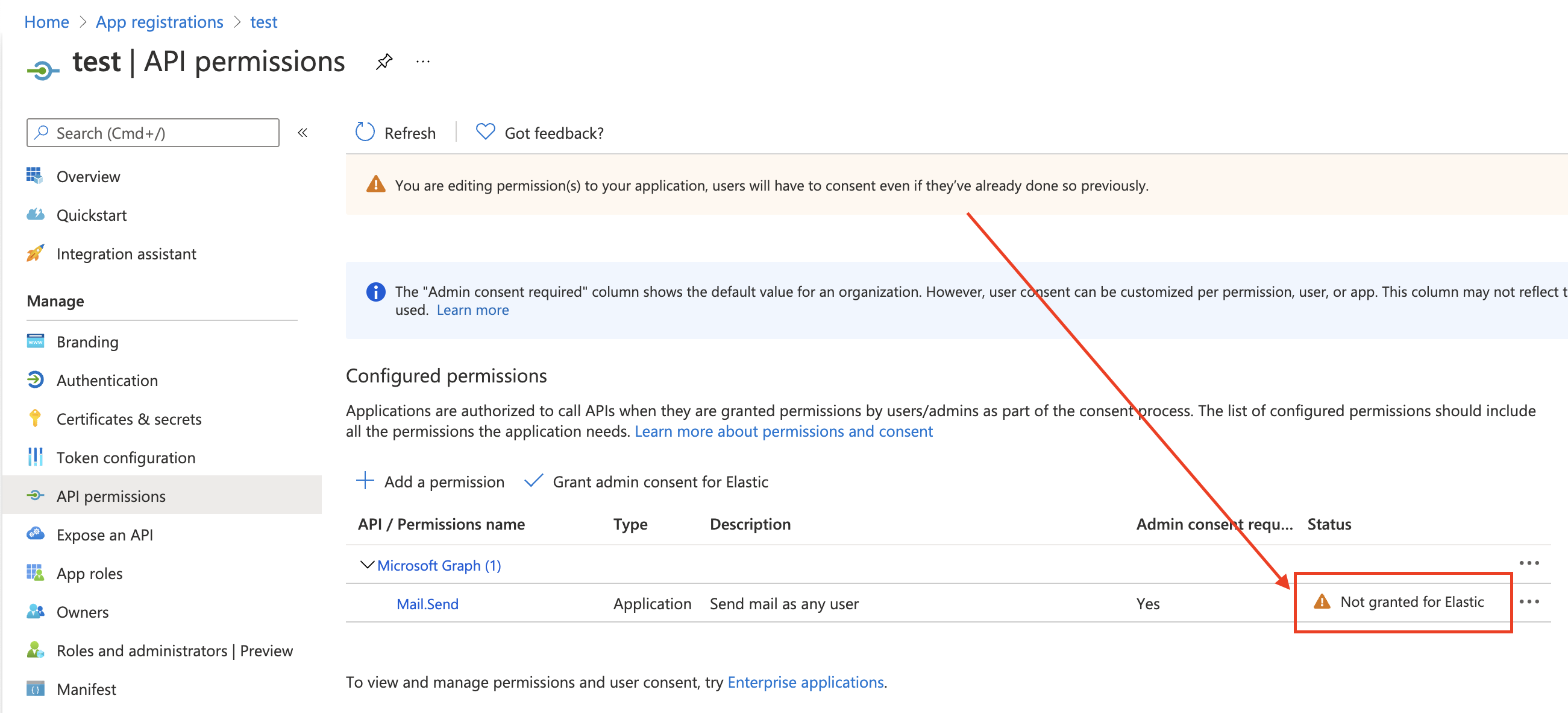

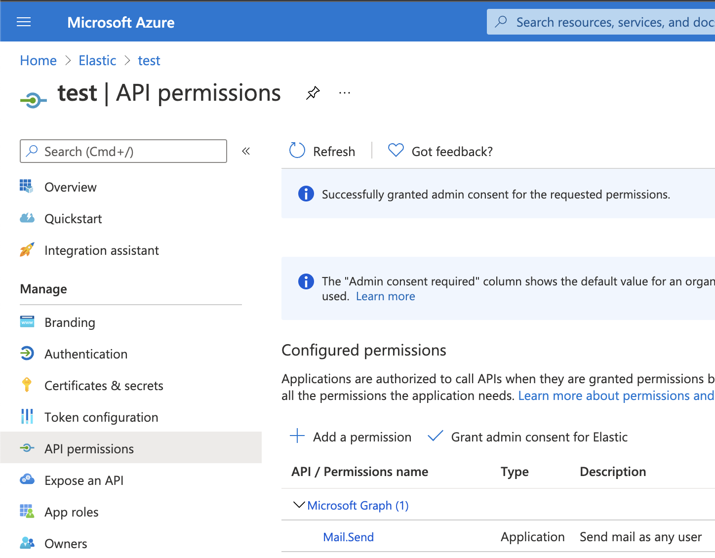

Next, open Manage > API permissions, and then define the permissions for the registered application to send emails. Refer to the documentation for the Microsoft Graph API.
MS Exchange API permissions
Add the "Mail.Send" permission for Microsoft Graph. The permission appears in the list with the status "Not granted for <your Azure active directory>":
MS Exchange "Mail.Send" not granted

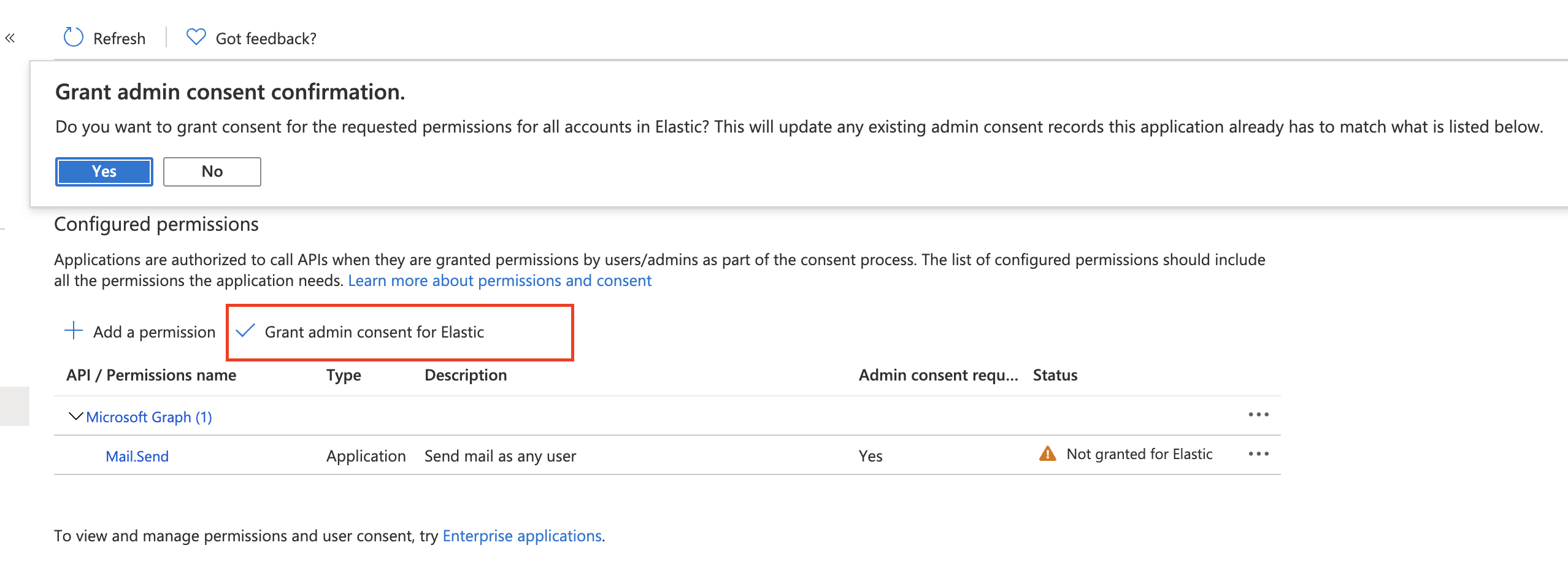

Click Grant admin consent for <your Azure active directory>.
MS Exchange grant confirmation

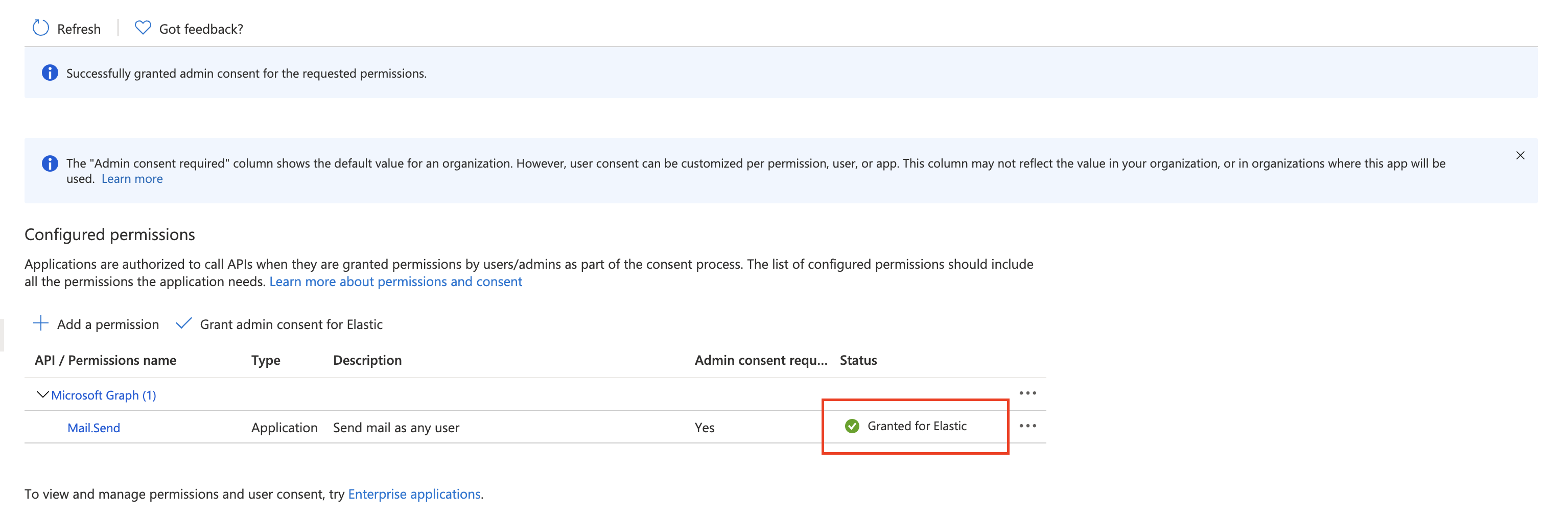

Confirm that the status for the "Mail.Send" permission is now granted.

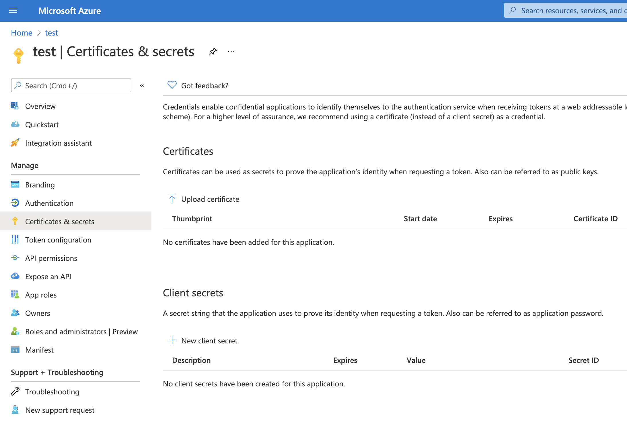

Configure Microsoft Exchange Client secretedit
To configure the Client secret , open Manage > Certificates & secrets.
MS Exchange secrets configuration
Add a new client secret, then copy the value and put it to the proper field in the Microsoft Exchange email connector.

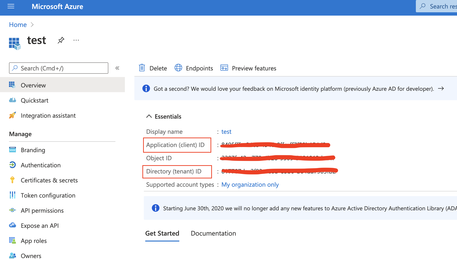

Configure Microsoft Exchange Client ID and Tenant IDedit
To find the application Client ID, open the Overview page.
MS Exchange Client ID and Tenant ID configuration
Copy and paste this values to the proper fields in the Microsoft Exchange email connector.
