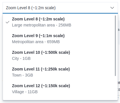

Data
Elastic Maps Server hosts vector layer boundaries and vector tile basemaps for the entire planet. Boundaries include world countries, global administrative regions, and specific country regions. Basemaps up to zoom level 8 are bundled in the Docker image. These basemaps are sufficient for maps and dashboards at the country level. To present maps with higher detail, follow the instructions of the front page to download and configure the appropriate basemaps database. The most detailed basemaps at zoom level 14 are good for street level maps, but require ~90GB of disk space.
Basemaps download options
The available basemaps and boundaries can be explored from the /maps endpoint in a web page that is your self-managed equivalent to https://maps.elastic.co.

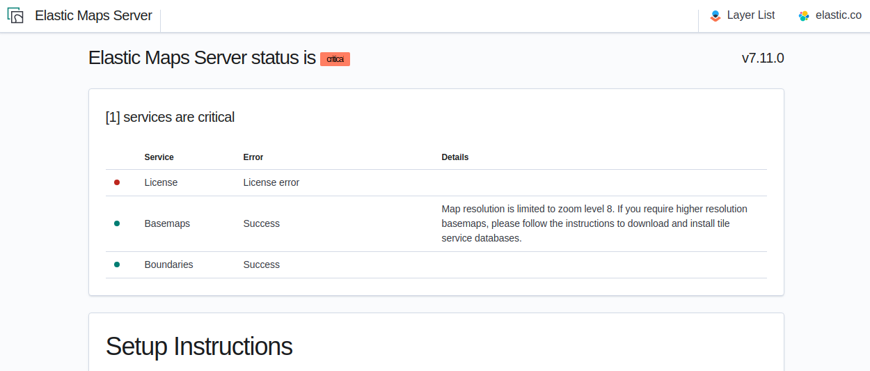

Status check
Elastic Maps Server periodically runs a status check that is exposed in three different forms:
  • At the root of Elastic Maps Server, a web page will render the status of the different services.
  • A JSON representation of Elastic Maps Server status is available at the /status endpoint.
  • The Docker HEALTHCHECK instruction is run by default and will inform about the health of the service, running a process equivalent to the /status endpoint.
Elastic Maps Server won’t respond to any data request if the license validation is not fulfilled.
