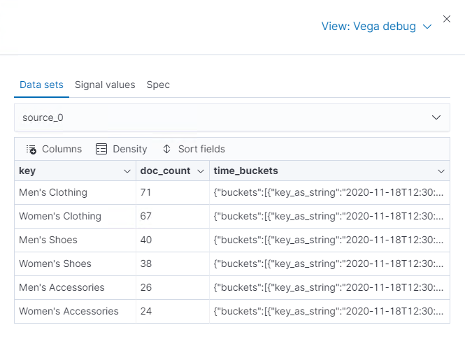

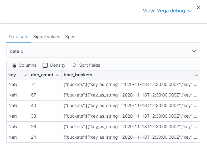

To debug the warning, compare source_0
and data_0
- In the toolbar, click Inspect.
- From the View dropdown, select Vega debug.
From the dropdown, select source_0.
To compare to the visually encoded data, select data_0 from the dropdown.
key is unable to convert because the property is category (
Men's Clothing
,Women's Clothing
, etc.) instead of a timestamp.

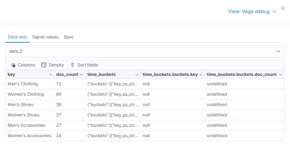

- Click Inspect, then select Vega Debug from the View dropdown.
From the dropdown, select data_0.
Vega-Lite is unable to extract the time_buckets.buckets
inner array.
Extract the time_buckets.buckets
inner array

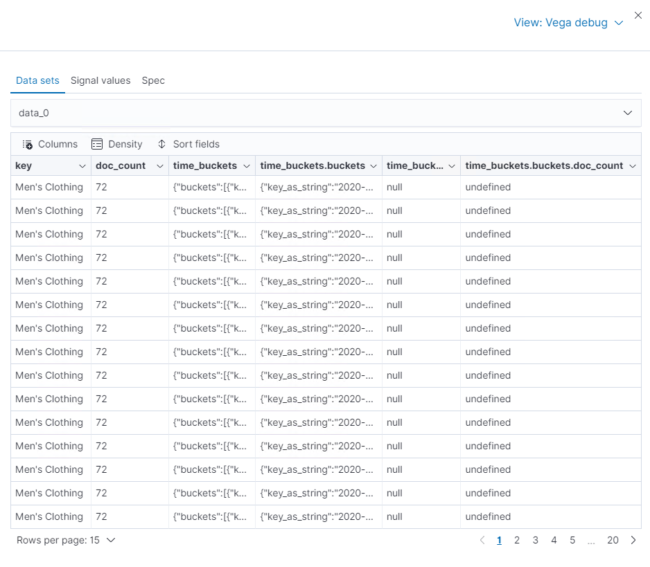

In the Vega-Lite spec, add a transform
block, then click Update:
transform: [{ flatten: ["time_buckets.buckets"] }]
Vega-Lite displays undefined values because there are duplicate names.
To resolve the duplicate names, add the
transform
andencoding
blocks, then click Update:
transform: [{ flatten: ["time_buckets.buckets"], as: ["buckets"] }] mark: area encoding: { x: { field: buckets.key type: temporal axis: { title: null } } y: { field: buckets.doc_count type: quantitative axis: { title: "Document count" } } color: { field: key type: nominal } }

Vega debugging
editWith the Vega debug view, you can inspect the Data sets and Signal Values runtime data.
