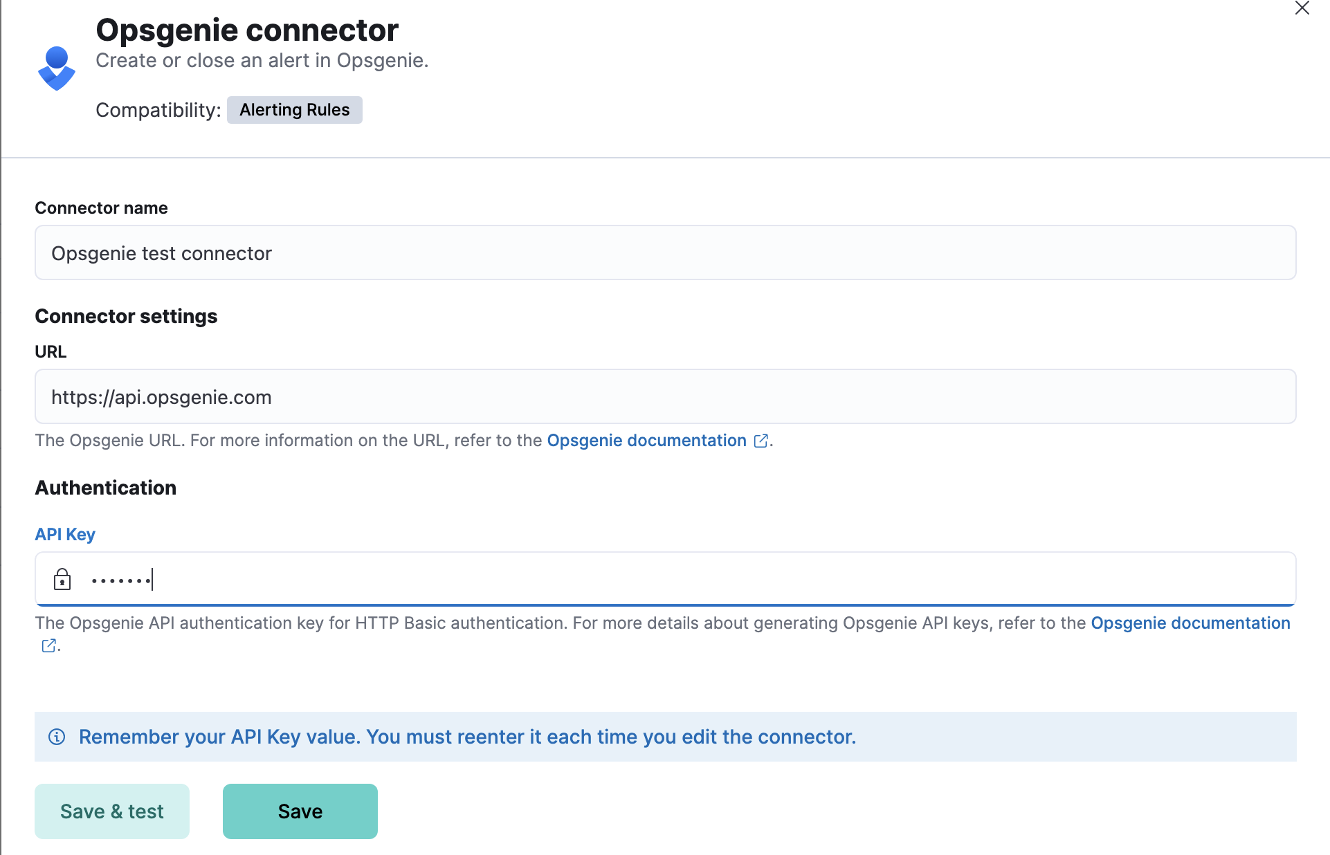

Create connectors in Kibanaedit
You can create connectors in Stack Management > Connectors or as needed when you’re creating a rule. For example:
Opsgenie connector
Connector configurationedit
Opsgenie connectors have the following configuration properties:
Name
The name of the connector. The name is used to identify a connector in the management UI connector listing, or in the connector list when configuring an action.
URL
The Opsgenie URL. For example, https://api.opsgenie.com or https://api.eu.opsgenie.com.
If you are using the xpack.actions.allowedHosts setting, make sure the hostname is added to the allowed hosts.
API Key
The Opsgenie API authentication key for HTTP basic authentication. For more details about generating Opsgenie API keys, refer to Opsgenie documentation.

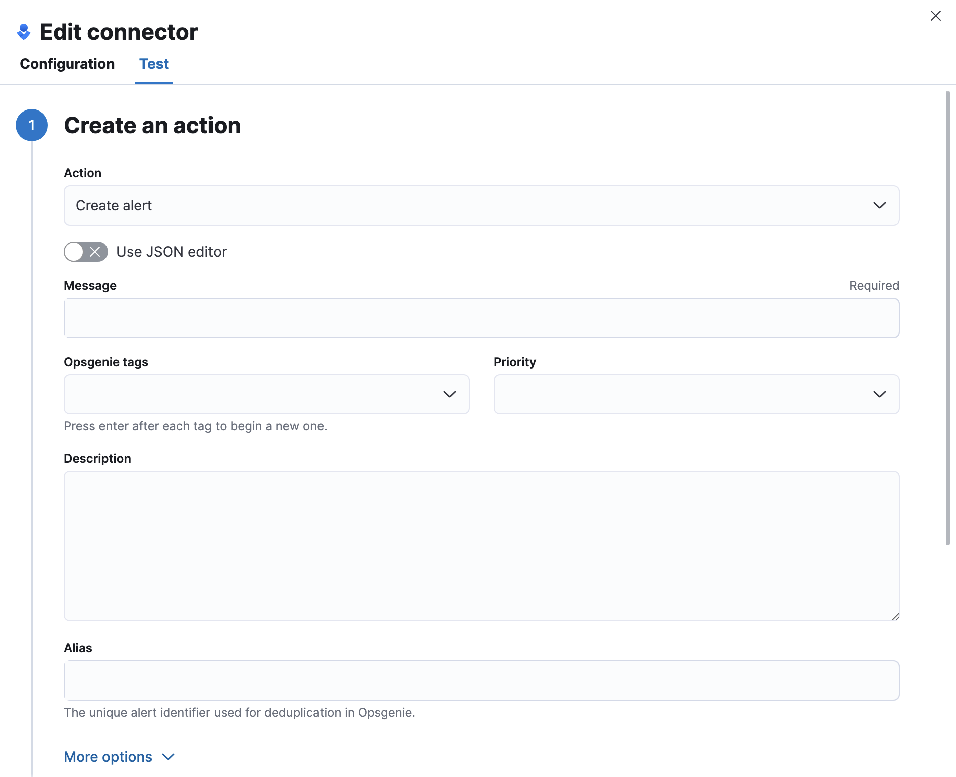

Create alert actionedit
When you create a rule that uses an Opsgenie connector, its actions (with the exception of recovery actions) create Opsgenie alerts. You can test this type of action when you create or edit your connector:
Opsgenie create alert action test
You can configure the create alert action through the form view or using a JSON editor.
Form viewedit
The create alert action form has the following configuration properties.
Message
The message for the alert (required).
Opsgenie tags
The tags for the alert (optional).
Priority
The priority level for the alert.
Description
A description that provides detailed information about the alert (optional).
Alias
The alert identifier, which is used for alert deduplication in Opsgenie. For more information, refer to the Opsgenie documentation (optional).
Entity
The domain of the alert (optional).
Source
The source of the alert (optional).
User
The display name of the owner (optional).
Note
Additional information for the alert (optional).

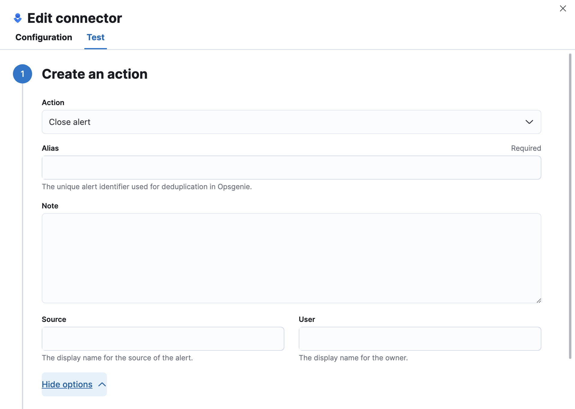

Close alert actionedit
When you create a rule that uses an Opsgenie connector, its recovery actions close Opsgenie alerts. You can test this type of action when you create or edit your connector:
Opsgenie close alert action test
The close alert action has the following configuration properties.
Alias
The alert identifier, which is used for alert deduplication in Opsgenie (required). The alias must match the value used when creating the alert. For more information, refer to the Opsgenie documentation.
Note
Source
The display name of the source (optional).
User

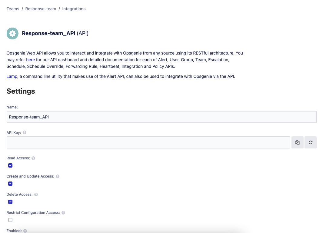

Configure an Opsgenie accountedit
After obtaining an Opsgenie instance, configure the API integration. For details, refer to the Opsgenie documentation.
If you’re using a free trial, go to the Teams dashboard and select the appropriate team.
Opsgenie teams dashboard
Select the Integrations menu item, then select Add integration.
Opsgenie teams integrations
Search for API and select the API integration.
Opsgenie API integration
Configure the integration and ensure you record the API Key. This key will be used to populate the API Key field when creating the Kibana Opsgenie connector. Click Save Integration after you finish configuring the integration.
Opsgenie save integration
