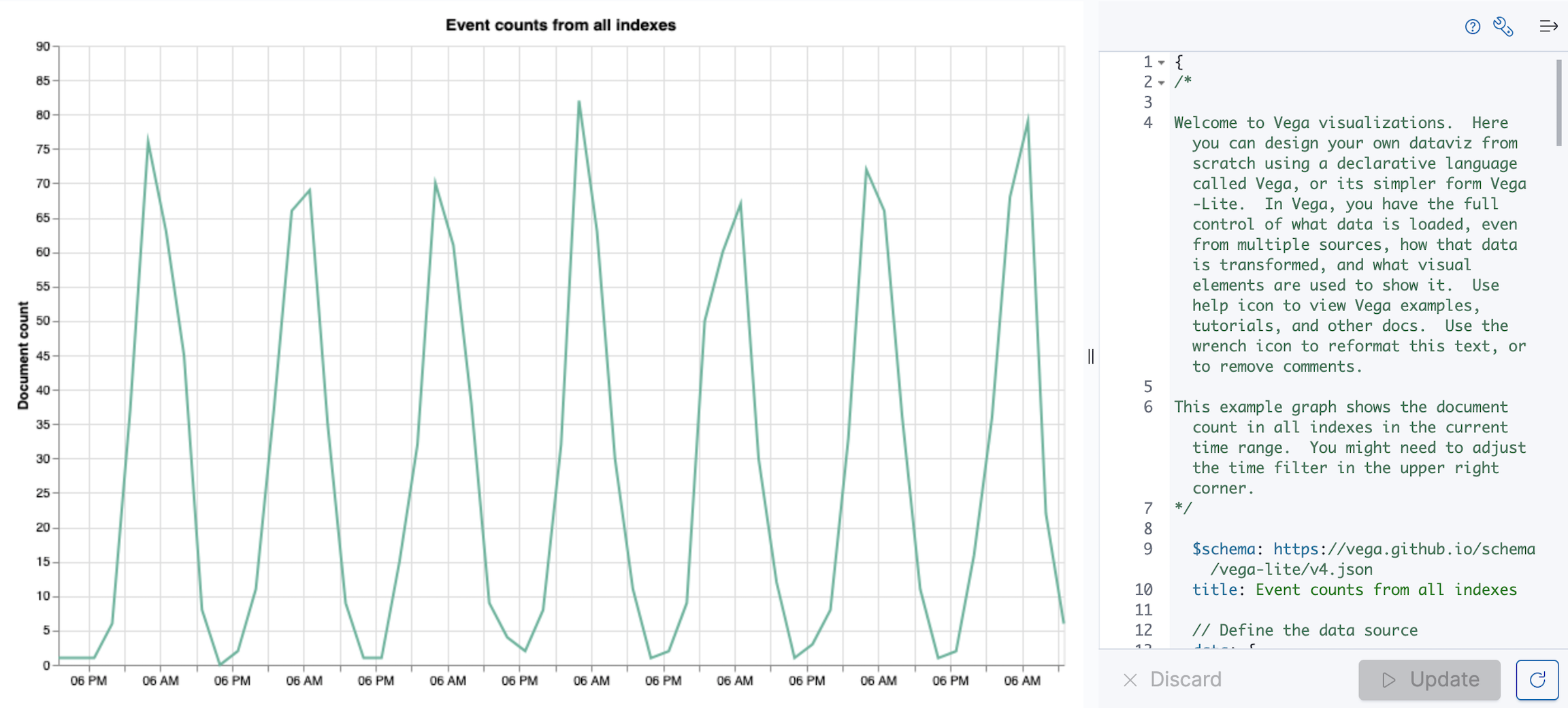

Open Vega-Lite and change the time range.
  1. On the dashboard, click All types, then select Custom visualization.
    A pre-populated line chart displays the total number of documents.
  2. Make sure the time filter is Last 7 days.

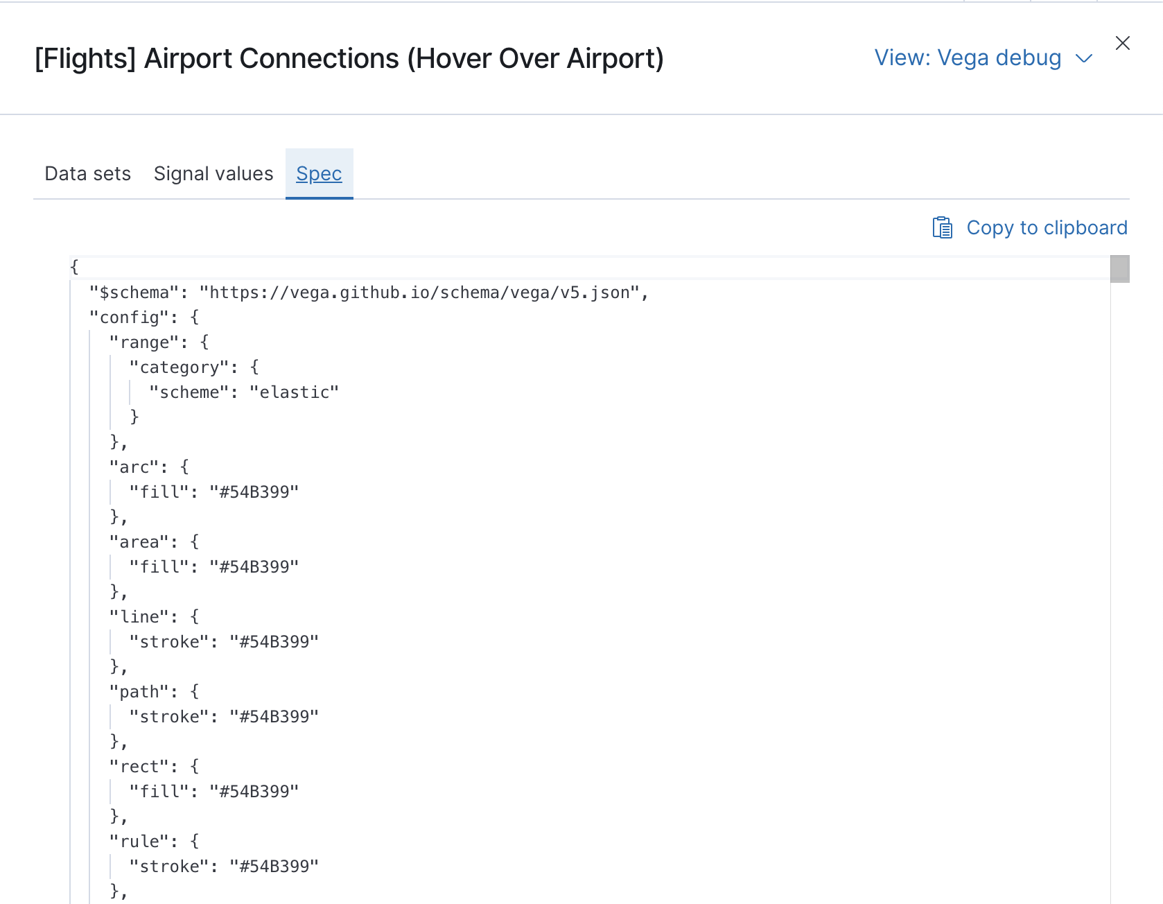

  1. In the toolbar, click Inspect.
  2. From the View dropdown, select Vega debug.
  3. From the dropdown, select source_0.

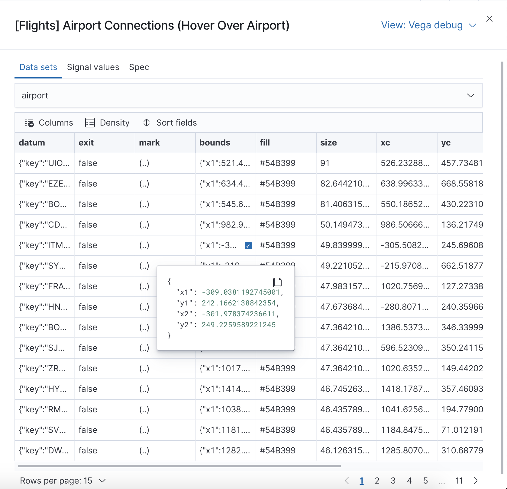

    Table for data_0 with columns key
  4. To compare to the visually encoded data, select data_0 from the dropdown.
    Table for data_0 where the key is NaN instead of a string
    key is unable to convert because the property is category (Men's Clothing, Women's Clothing, etc.) instead of a timestamp.

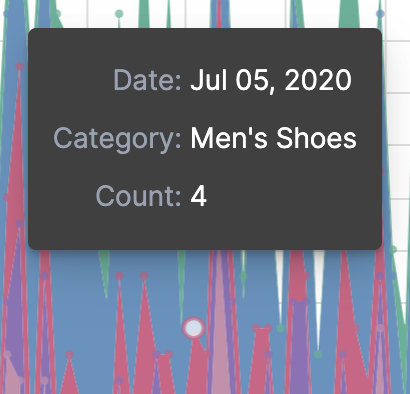

With the Vega-Lite spec, you can add hover states and tooltips to the stacked area chart with the selection block.
In the Vega-Lite spec, add the encoding block, then click Update:
  encoding: {
    tooltip: [{
      field: buckets.key
      type: temporal
      title: "Date"
      field: key
      type: nominal
      title: "Category"
      field: buckets.doc_count
      type: quantitative
      title: "Count"
When you hover over the area series on the stacked area chart, a multi-line tooltip appears, but is unable to indicate the nearest point. To indicate the nearest point, add a second layer.

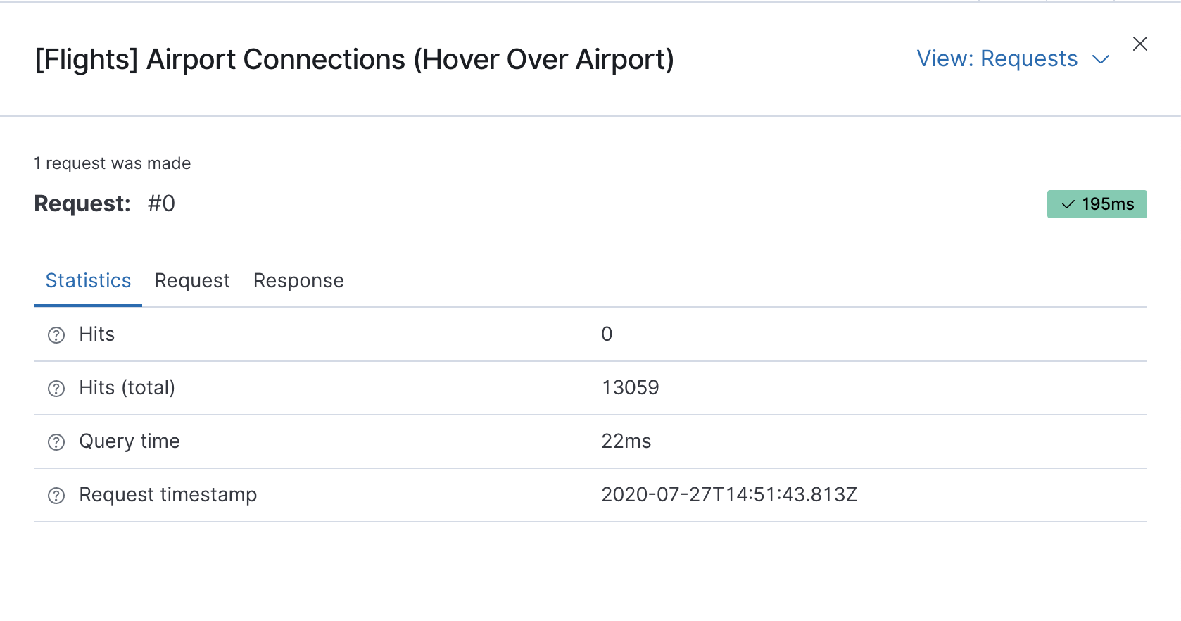

  • Debugging support using the Kibana inspector or browser console

Additional tooltip stylingedit
Kibana has installed the Vega tooltip plugin, so tooltips can be defined in the ways documented there. Beyond that, Kibana also supports a configuration option for changing the tooltip position and padding:
  config: {
    kibana: {
      tooltips: {
        position: 'top',
        padding: 15,
        textTruncate: true,

Inspect Elasticsearch requestsedit
Vega uses the Elasticsearch search API to get documents and aggregation results from Elasticsearch. To troubleshoot these requests, click Inspect, which shows the most recent requests. In case your specification has more than one request, you can switch between the views using the View dropdown.
vega tutorial inspect requests
Vega debuggingedit
With the Vega debug view, you can inspect the Data sets and Signal Values runtime data.
The runtime data is read from the runtime scope.
vega tutorial inspect data sets
To debug more complex specs, access to the view variable. For more information, refer to the Vega browser debugging process.
