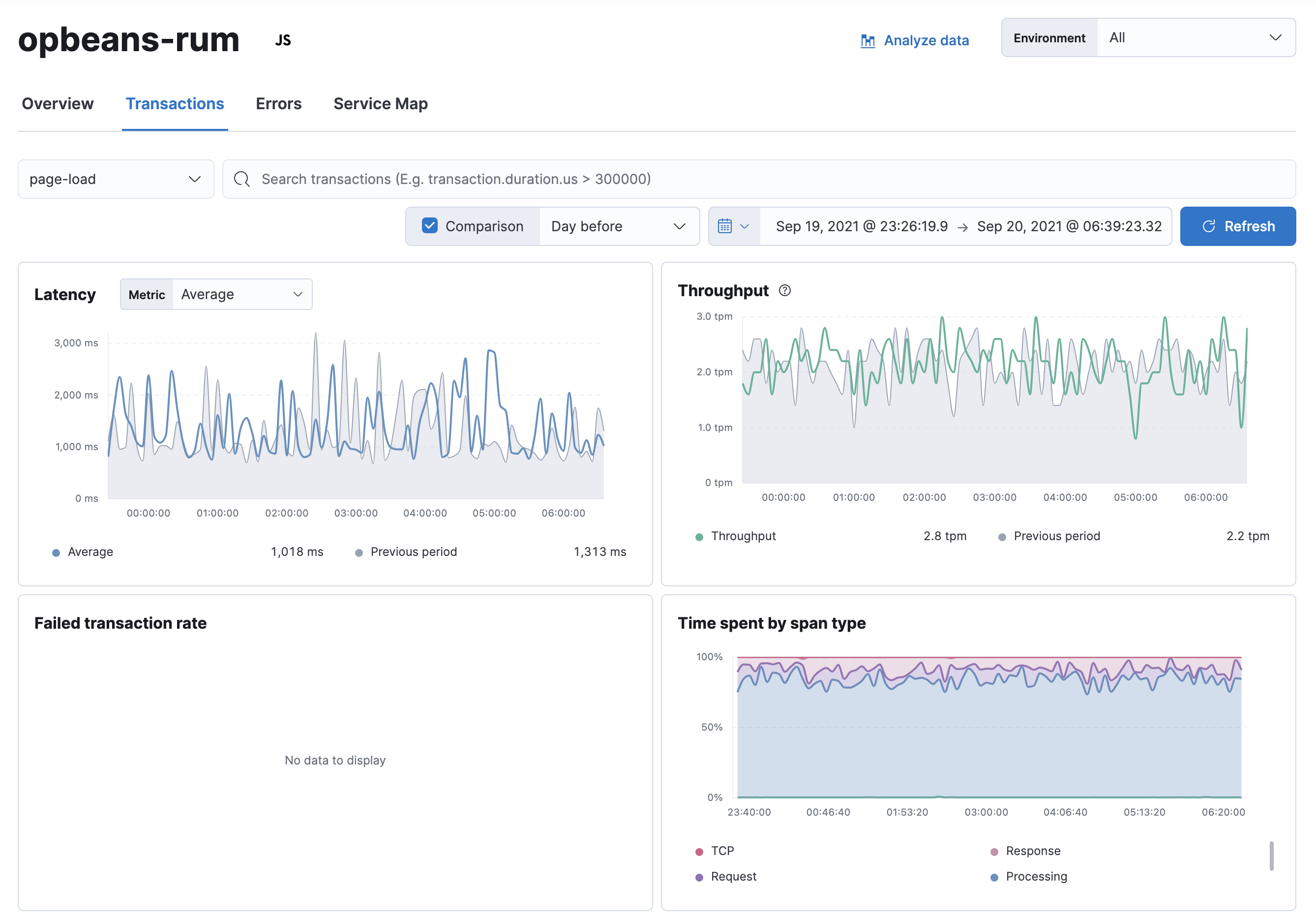

The Latency, transactions per minute, Error rate, and Average duration by span type charts display information on all transactions associated with the selected service:
- Latency
- Response times for the service. Options include average, 95th, and 99th percentile. If there’s a weird spike that you’d like to investigate, you can simply zoom in on the graph - this will adjust the specific time range, and all of the data on the page will update accordingly.
- Throughput
Visualize response codes:
2xx
,3xx
,4xx
, etc. Useful for determining if more responses than usual are being served with a particular response code. Like in the latency graph, you can zoom in on anomalies to further investigate them. - Error rate
Visualize the total number of transactions with errors divided by the total number of transactions.
The error rate value is based on the
event.outcome
field and is the relative number of failed transactions. Any unexpected increases, decreases, or irregular patterns can be investigated further with the errors overview. - Average duration by span type
Visualize where your application is spending most of its time. For example, is your app spending time in external calls, database processing, or application code execution?
The time a transaction took to complete is also recorded and displayed on the chart under the "app" label. "app" indicates that something was happening within the application, but we’re not sure exactly what. This could be a sign that the agent does not have auto-instrumentation for whatever was happening during that time.
It’s important to note that if you have asynchronous spans, the sum of all span times may exceed the duration of the transaction.

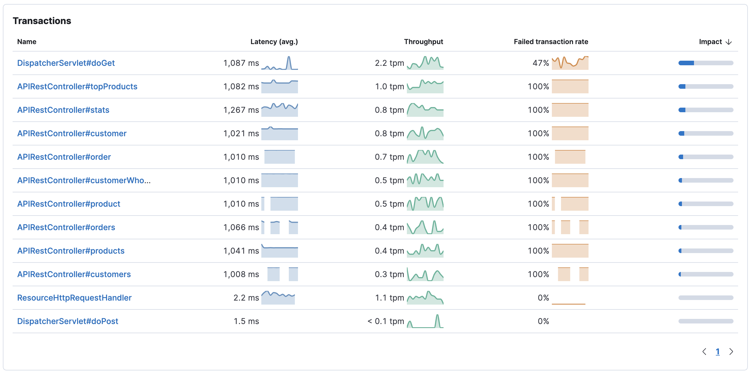

The Transactions table displays a list of transaction groups for the selected service. In other words, this view groups all transactions of the same name together, and only displays one entry for each group.
By default, transaction groups are sorted by Impact. Impact helps show the most used and slowest endpoints in your service - in other words, it’s the collective amount of pain a specific endpoint is causing your users. If there’s a particular endpoint you’re worried about, you can click on it to view the transaction details.
If you only see one route in the Transactions table, or if you have transactions named "unknown route", it could be a symptom that the agent either wasn’t installed correctly or doesn’t support your framework.
For further details, including troubleshooting and custom implementation instructions, refer to the documentation for each APM Agent you’ve implemented.
RUM Transaction overviewedit
The transaction overview page is customized for the JavaScript RUM Agent. Specifically, the page highlights page load times for your service:
Additional RUM goodies, like core vitals, and visitor breakdown by browser, location, and device, are available in the Observability User Experience tab.

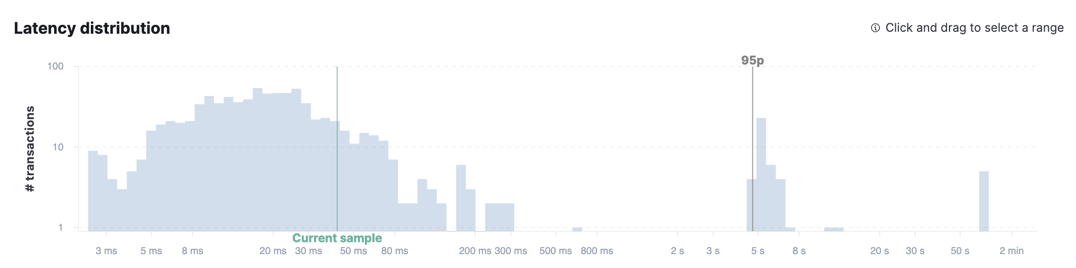

Transactions duration distributionedit

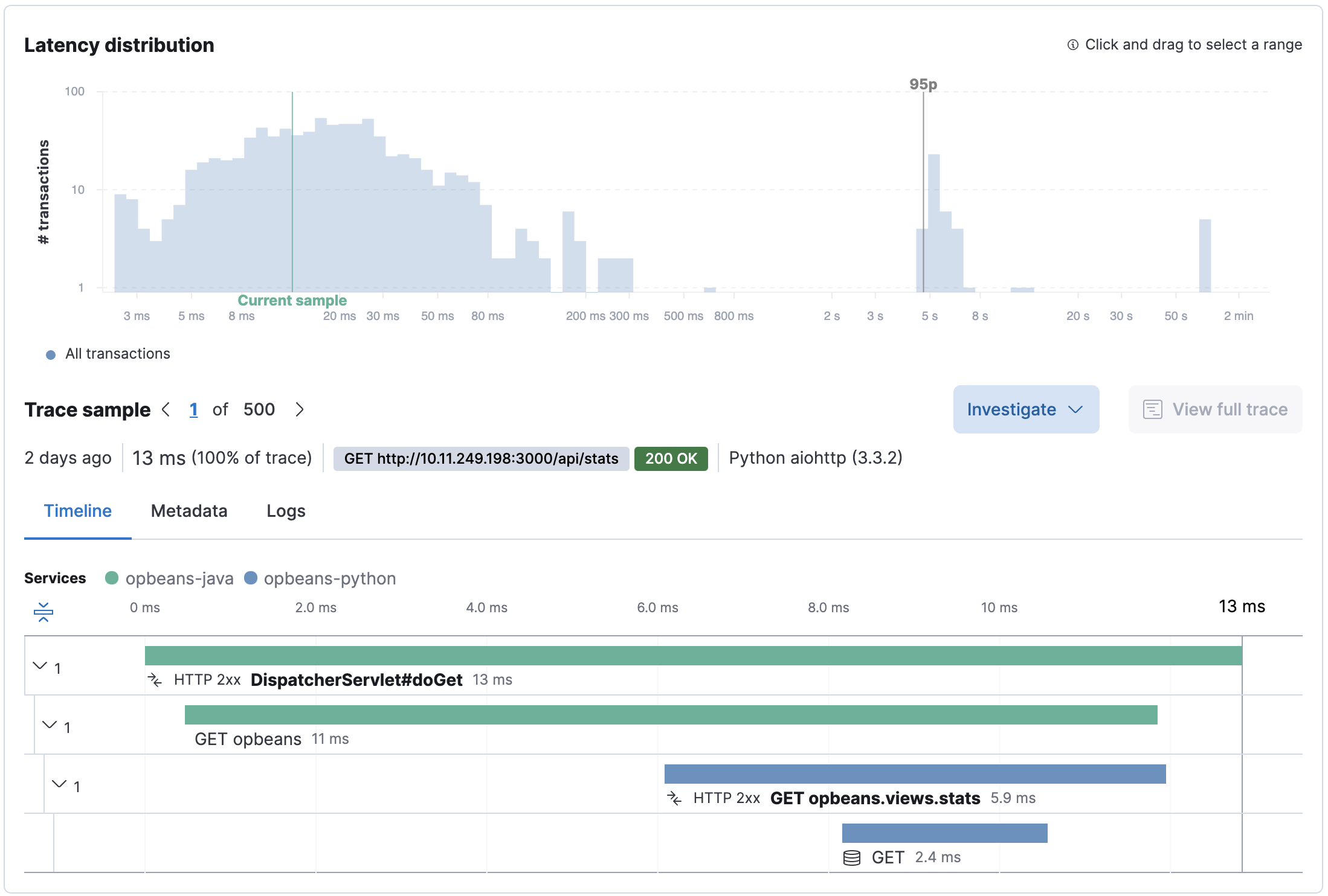

This chart plots all transaction durations for the given time period. The screenshot below shows a typical distribution, and indicates most of our requests were served quickly — awesome! It’s the requests on the right, the ones taking longer than average, that we probably want to focus on.
Select a transaction duration bucket to display up to ten trace samples.
Trace sampleedit
Trace samples are based on the bucket selection in the Transactions duration distribution chart; update the samples by selecting a new bucket. The number of requests per bucket is displayed when hovering over the graph, and the selected bucket is highlighted to stand out.
Each bucket presents up to ten trace samples in a timeline, trace sample metadata, and any related logs.
Trace sample timeline
Each sample has a trace timeline waterfall that shows how a typical request in that bucket executed. This waterfall is useful for understanding the parent/child hierarchy of transactions and spans, and ultimately determining why a request was slow. For large waterfalls, expand problematic transactions and collapse well-performing ones for easier problem isolation and troubleshooting.
More information on timeline waterfalls is available in spans.

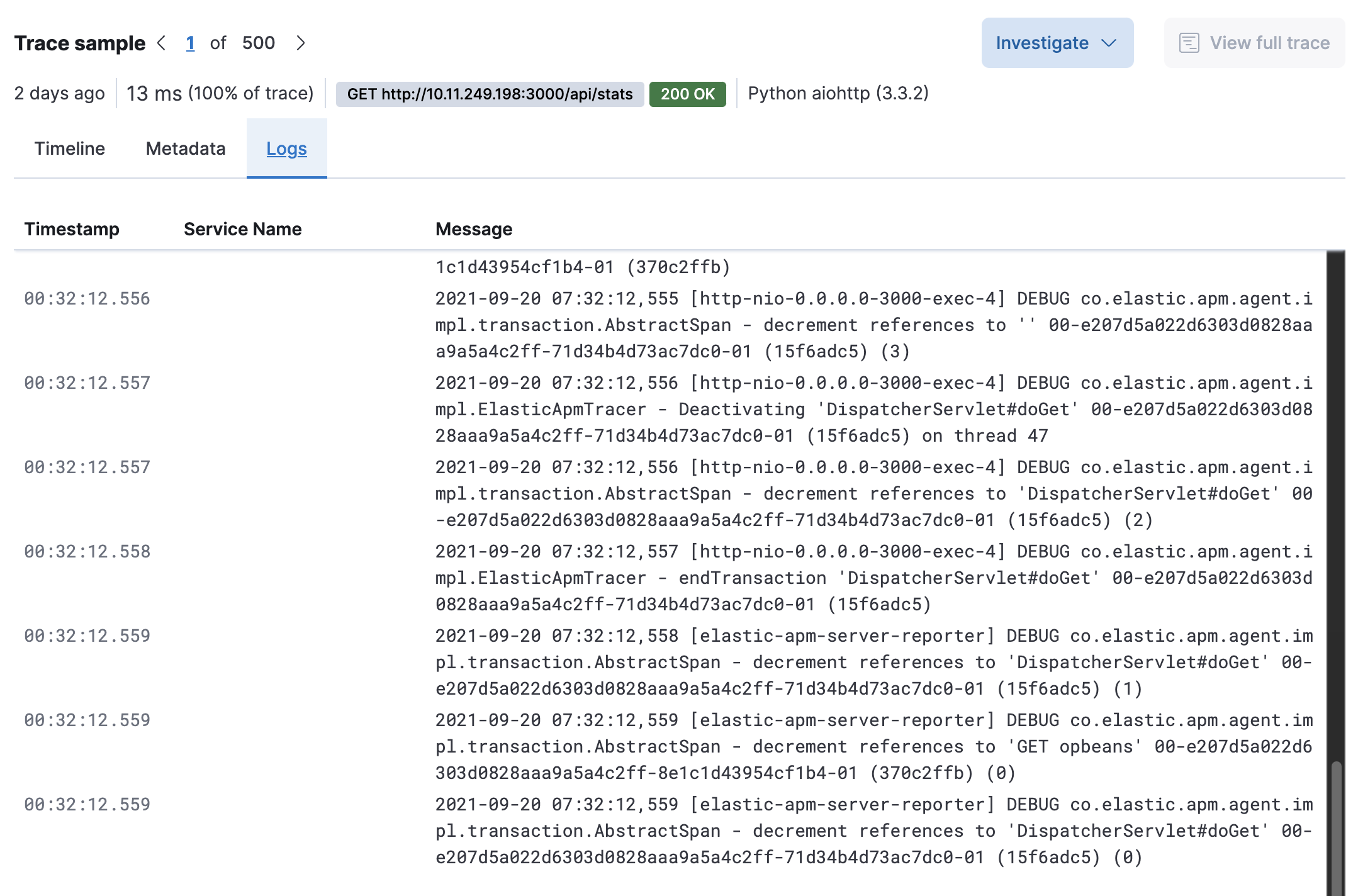

Trace sample logs
The Logs tab displays logs related to the sampled trace.
Logs provide detailed information about specific events, and are crucial to successfully debugging slow or erroneous transactions.
If you’ve correlated your application’s logs and traces, you never have to search for relevant data; it’s all provided on this. Viewing log and trace data together allows you to quickly diagnose and solve problems.
